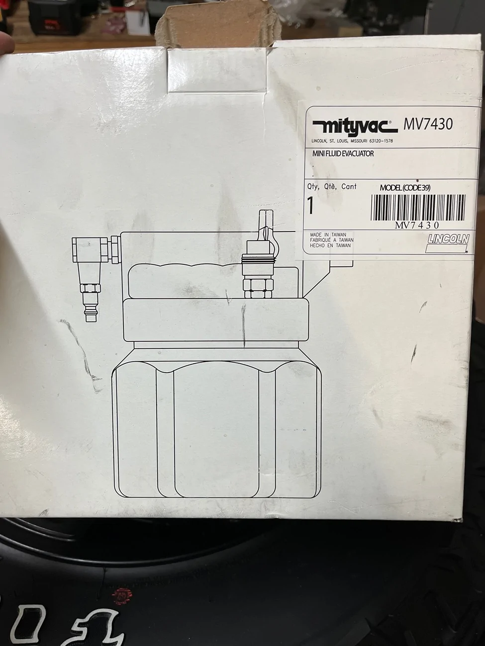

Brake fluid is a very simple DIY with 2 people.
