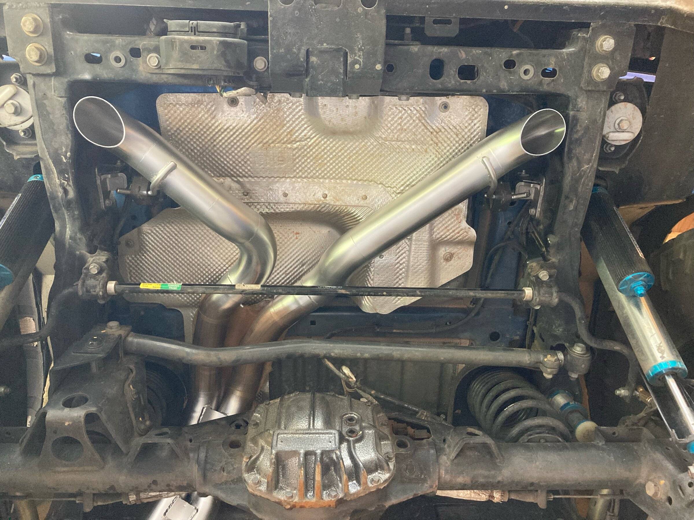

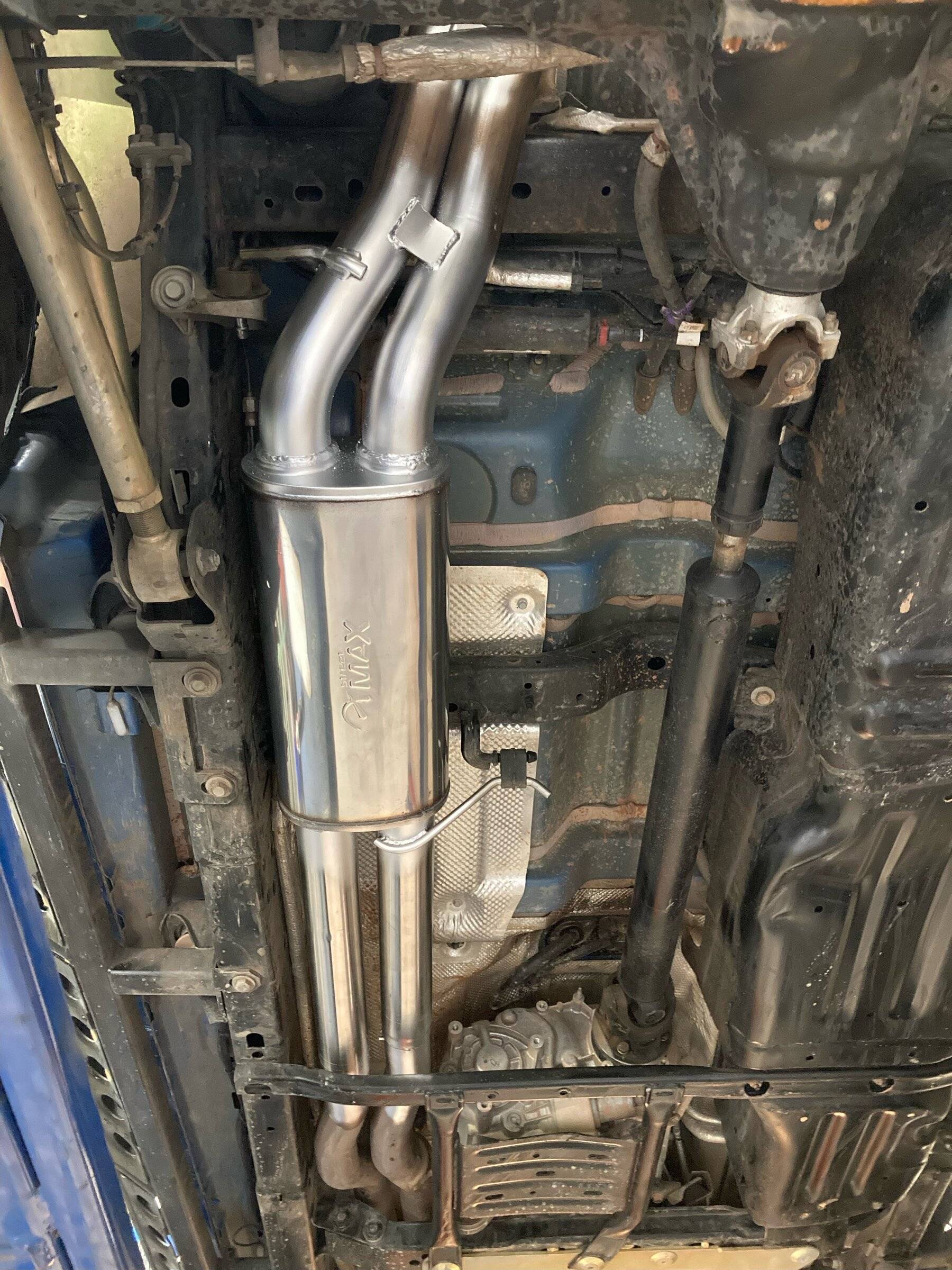

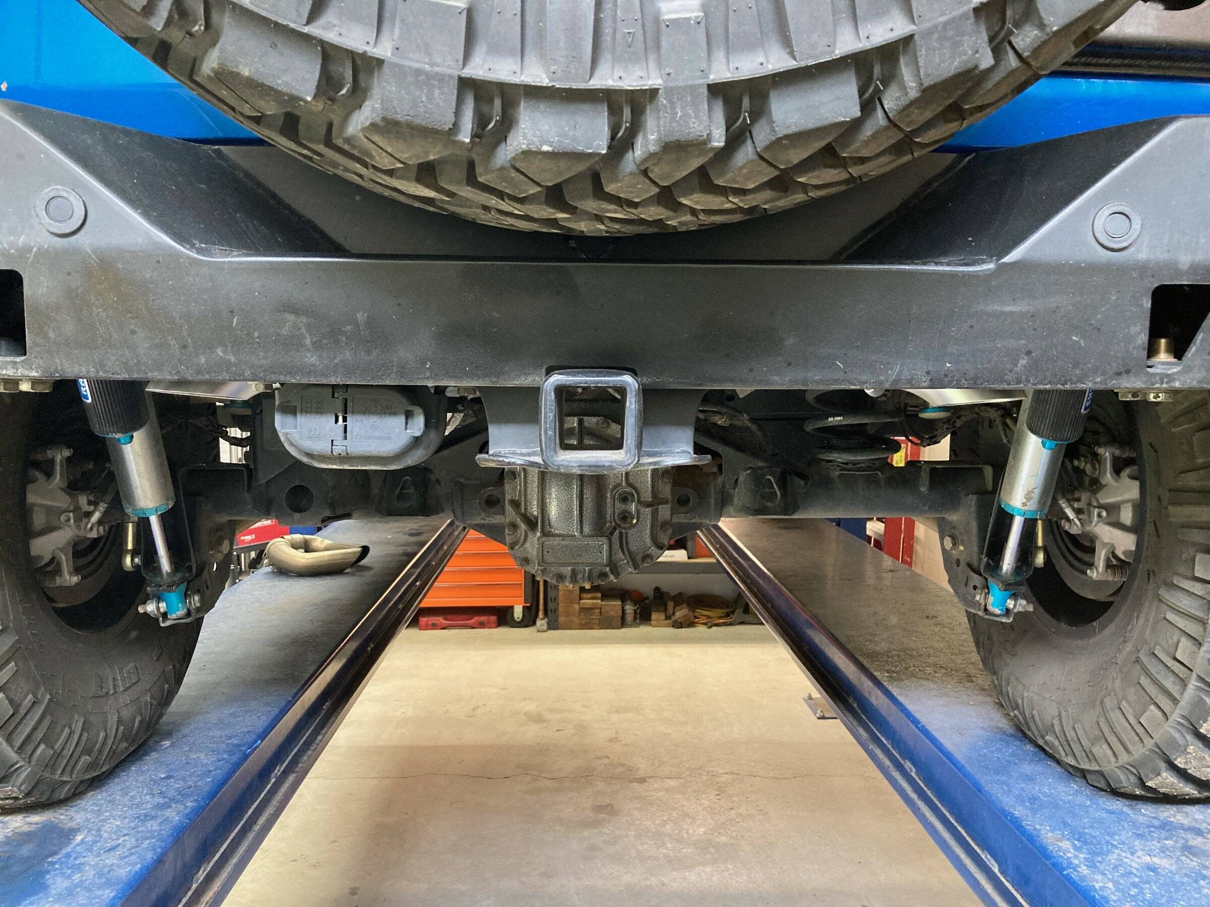

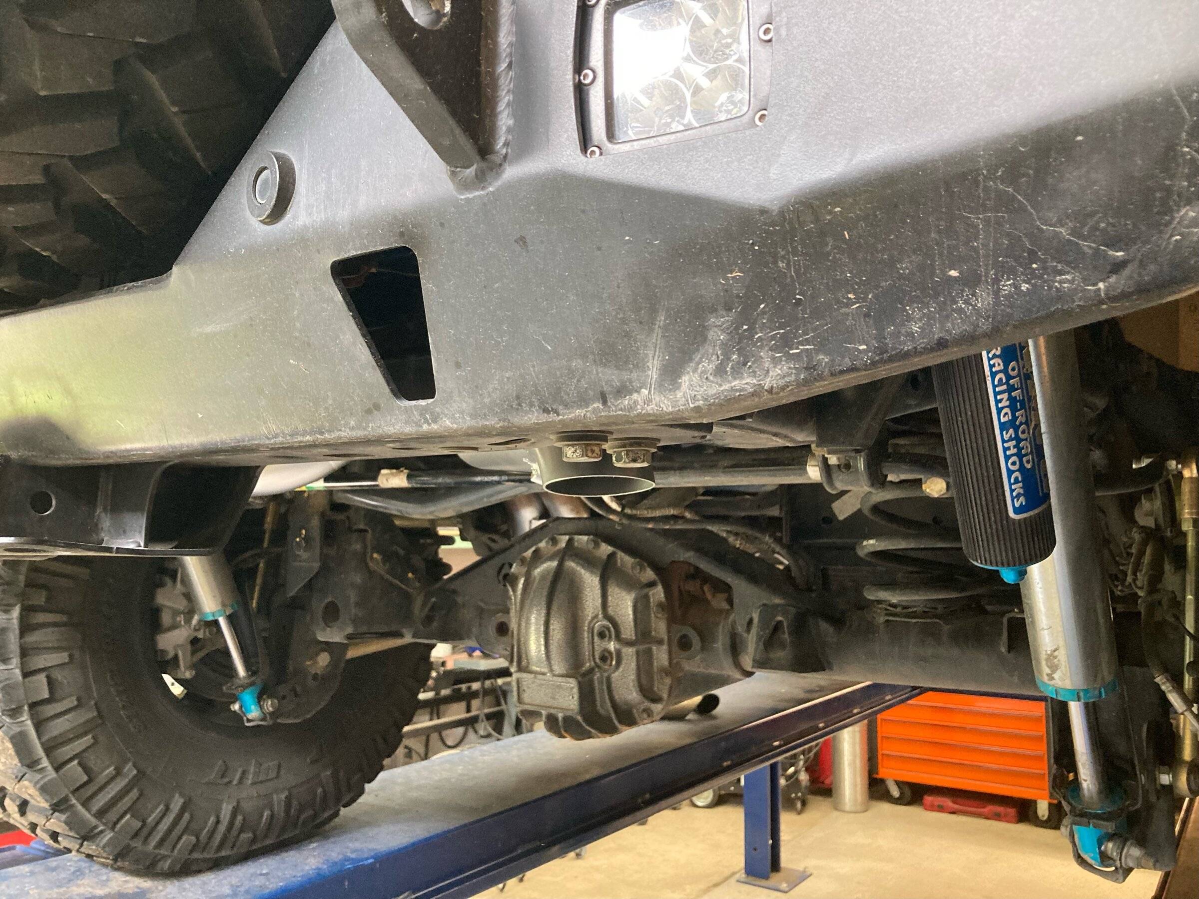

Just had a local guy do this for me to replace the factory rock magnet. Dual 3” in/out with internal X pipe. He added some cones at the entrance to the muffler to tone it down just a tad.
Have any sound clips yet? Looks good.

I don`t like it much, I love it a LOT! Excellent work done there by someone who knows how to build a exhaust system
I don`t have my glasses with me but it looks like it is Tig welded?
Some joints are tig’d, some are mig. Where he had to fill or weld while it was on the vehicle was mig. He’s a true craftsman ?
Looks good.
The ECU was programmed for the switchable factory exhaust system. Was anything reprogrammed, or is there a need for this? Has the vehicle thrown any error codes or had any other issues since the change? Thanks.

No need to reprogram anything. No error codes. The system is vacuum operated, so there’s really no way for the ECU to know if it’s open or closed. I just plugged the vacuum lines. And the switch on the dash doesn’t do anything, but pushing it makes it act just like factory as far as the dash messages and indicator lights are concerned.
