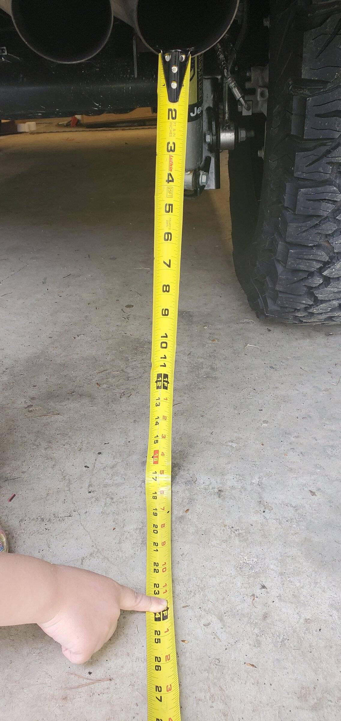

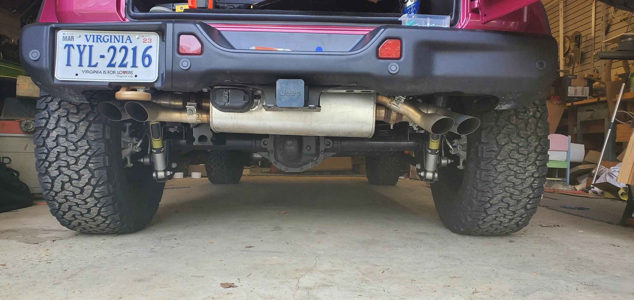

this bothered me as well.
hard to read the tape but they were 1.5" off from left to right. tried to adjust the passenger side tips but didn't fix it. Thanks for the details about adjusting the entire muffler.

Once I aligned them, and the left was 2 1/2 too high, it actually got quieter.
