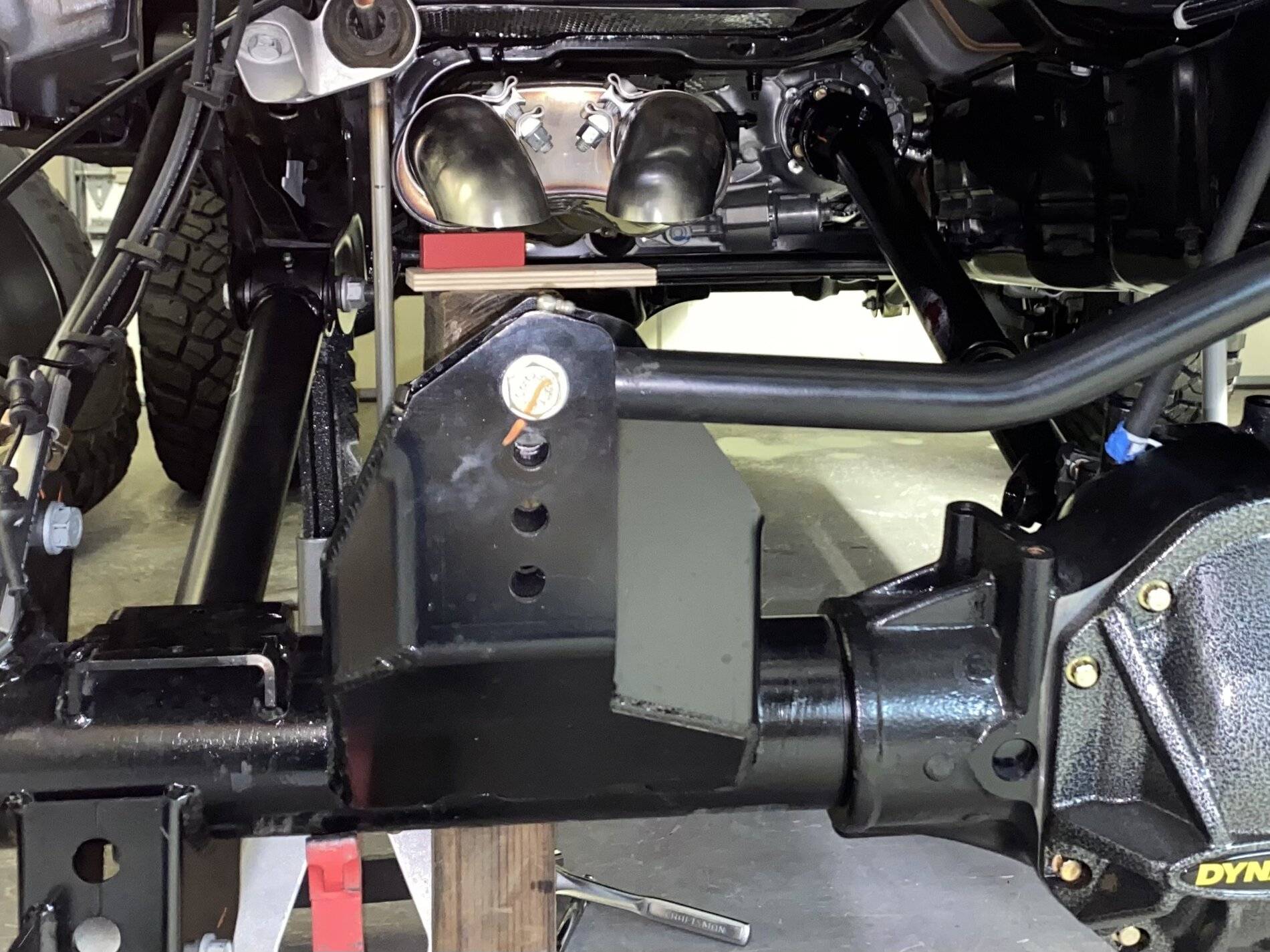

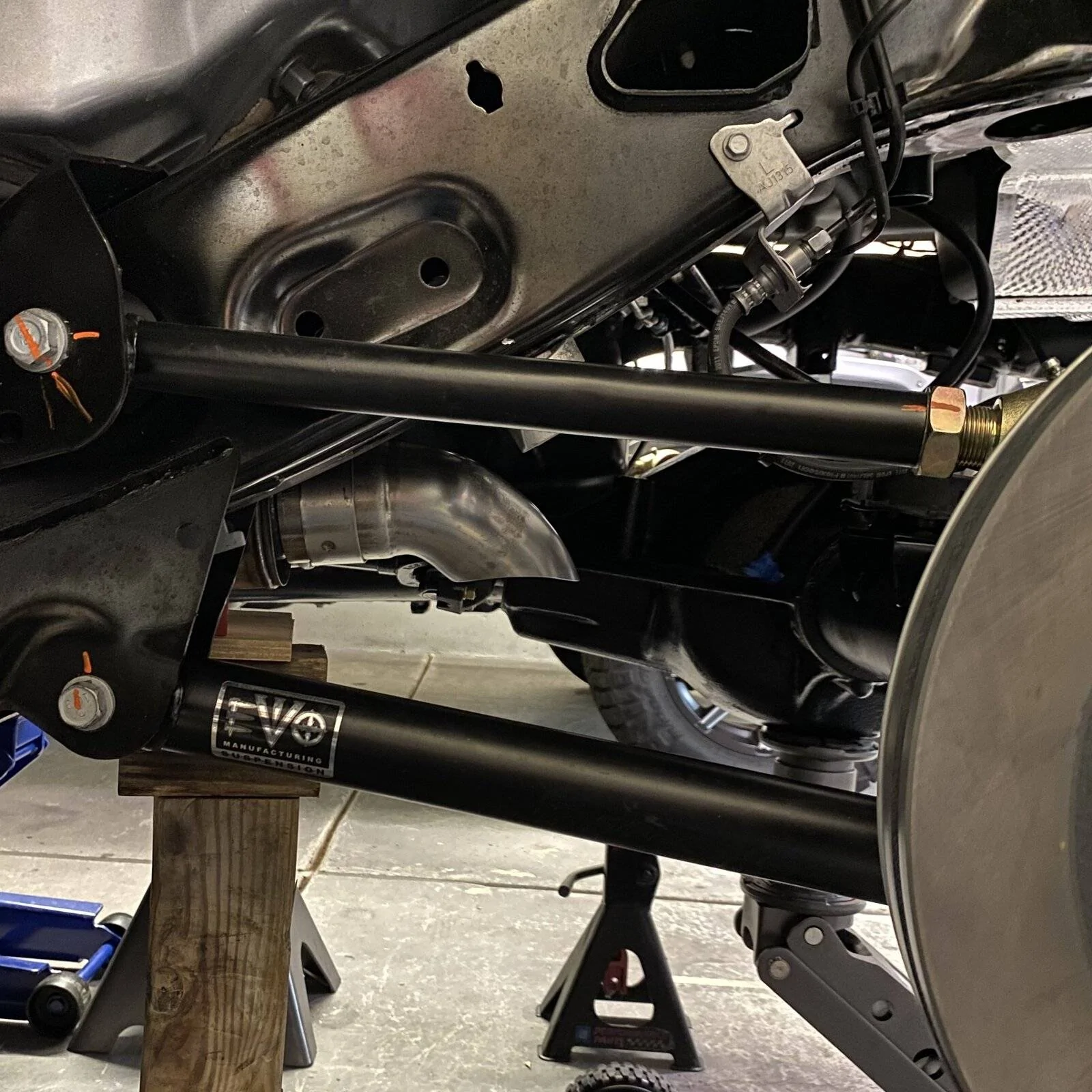

Does anyone know where the electric valve is that controls the vacuum actuated muffler cutouts? The source is tee'd into the brake booster line, but I haven't found the valve that the dash mounted switch controls yet. I'll use vacuum caps to seal that circuit off, but would like to fully understand it.
I removed the muffler and cut the exhaust pipes behind the primary muffler/resonator and used the 2.75" tips to build short downturns.
The muffler was in the way of the rear tank and XD60 park brake adapter bracket so it had to go.
Got any pics of everything?

@beckbuilt Might be a dumb question, but any concerns about exhaust fumes getting into the cab during long drives with the pipes exiting underneath like that?
@Rob97RR Not a dumb question at all. It’s a concern, I’ll find out. Lol. I think sitting still with it idling may have the most risk.
This is my temporary solution to get the muffler out of the way so I can finish the axle swap and make room for a rear mounted fuel tank.
