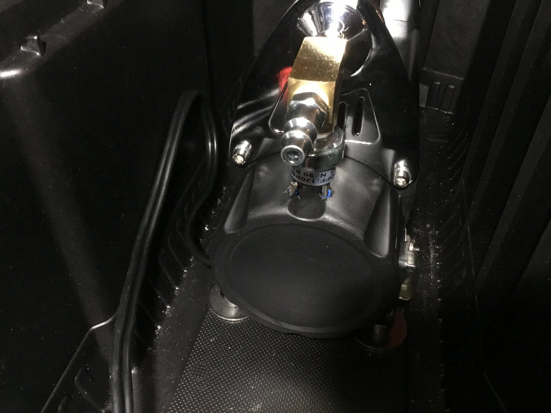

I was just thinking that putting it inside an enclosed case wasn't a good idea
I used this everyday during over the summer down in OBX. Yes the compressor got hot when in use but I let it cool down and it was fine. I love the convenience and how it stores in the back of the Jeep.

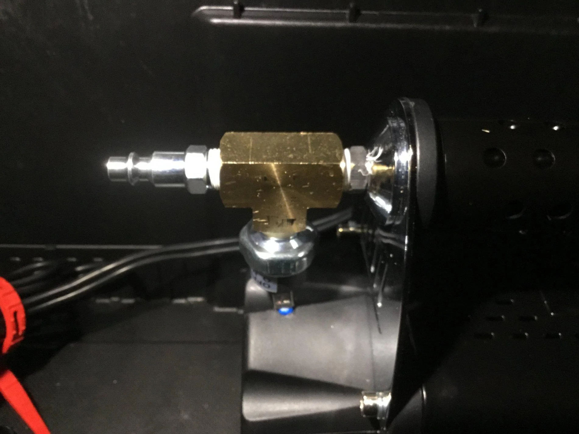

What do you do to keep the compressor from popping the pressure relief valve constantly? Do you keep the trigger pressed all the time and then just connect the check to the tire valve while the trigger is already pressed? I just built this setup, and between tire fills the compressor is constantly venting the pressure relief valve.

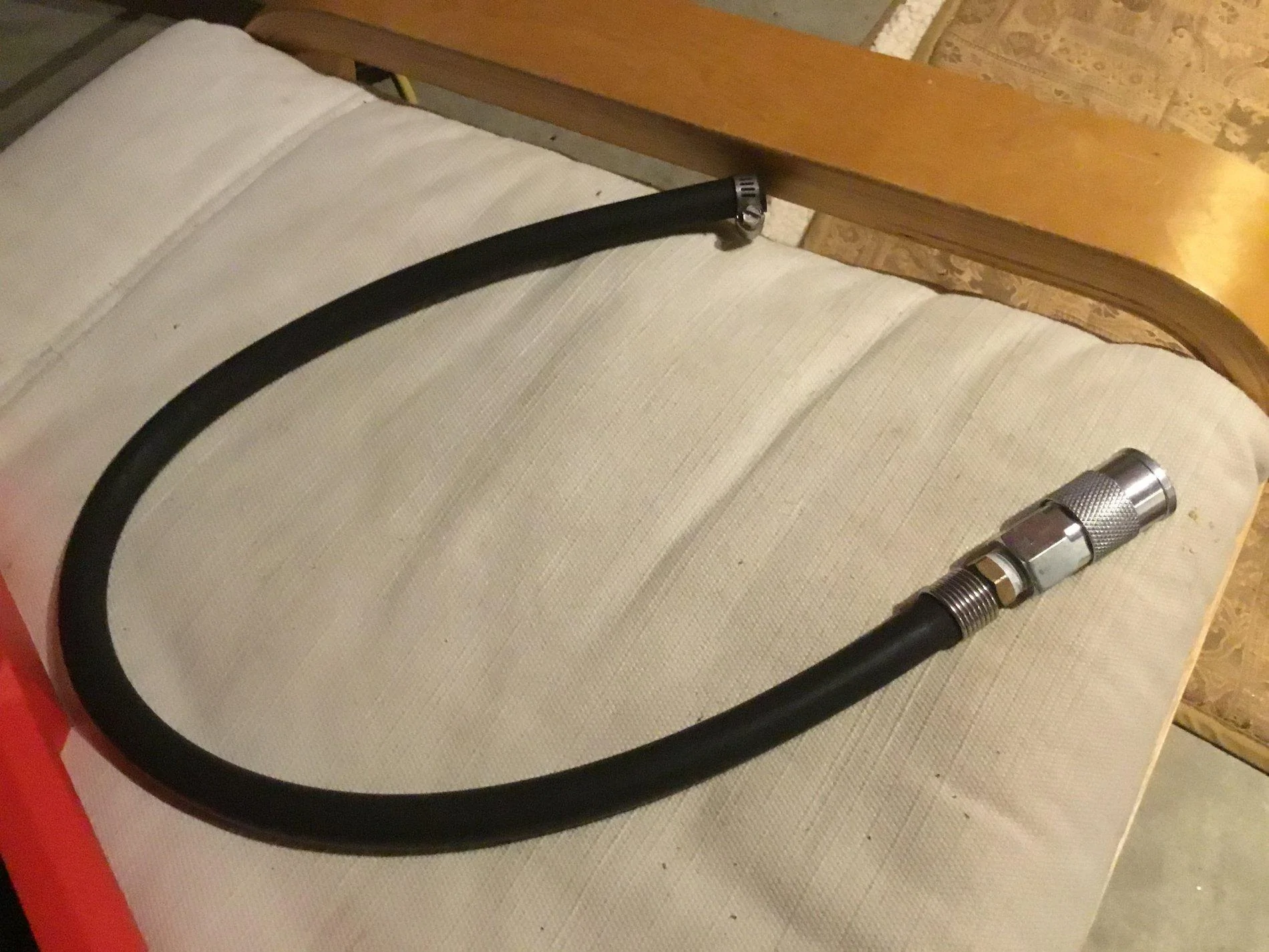

When I got my Smittybuilt air compressor I knew there was a few things that I needed to change right away. 1st thing was to get rid of the flimsy bag that it came with and decided to put it in a tool box. I spent few weeks looking around the web for a big enough tool box that was strong and not too expensive. The second thing I need to do was change the fittings from the Chinese fitting it came with and make them standard. Here is a list of things I used with links.
Smittybilt 2781 5.65 CFM Universal Air Compressor:
https://www.amazon.com/gp/product/B004K25GMG/ref=ppx_yo_dt_b_asin_title_o01_s00?ie=UTF8&psc=1
YOTOO Heavy Duty Air Compressor Accessories Kit 20 Pieces with 1/4 inch x 25 feet Polyurethane Air Compressor Hose, 100 PSI Tire Inflator Gauge, Air Blow Gun and Air Hose Fittings:
https://www.amazon.com/gp/product/B07GC4XBYS/ref=ppx_yo_dt_b_asin_title_o05_s00?ie=UTF8&psc=1
Air fitting 5/8 hose to ¼ standard fitting
I’m not sure what compressor you have? But it sounds like your regulator setting is above the pressure relief setting. Turn it down.
So, I had these grand ideas of installing a regulator to stop that but I ended up being lazy. When I go to fill my tires I just squeeze the trigger every few seconds to stop it from doing that. Sorry I do not have a cool fix.

it's the same smittybilt 2781. I did not know there was a regulator setting in addition to the pressure relief valve. I do not see instructions on how to adjust the regulator though?

Thanks! Will probably just do the same as you and release some air every few seconds. Just hate that pressure relief valve sound - mostly from working with compressed gases and usually that popping noise means something bad is happening....
