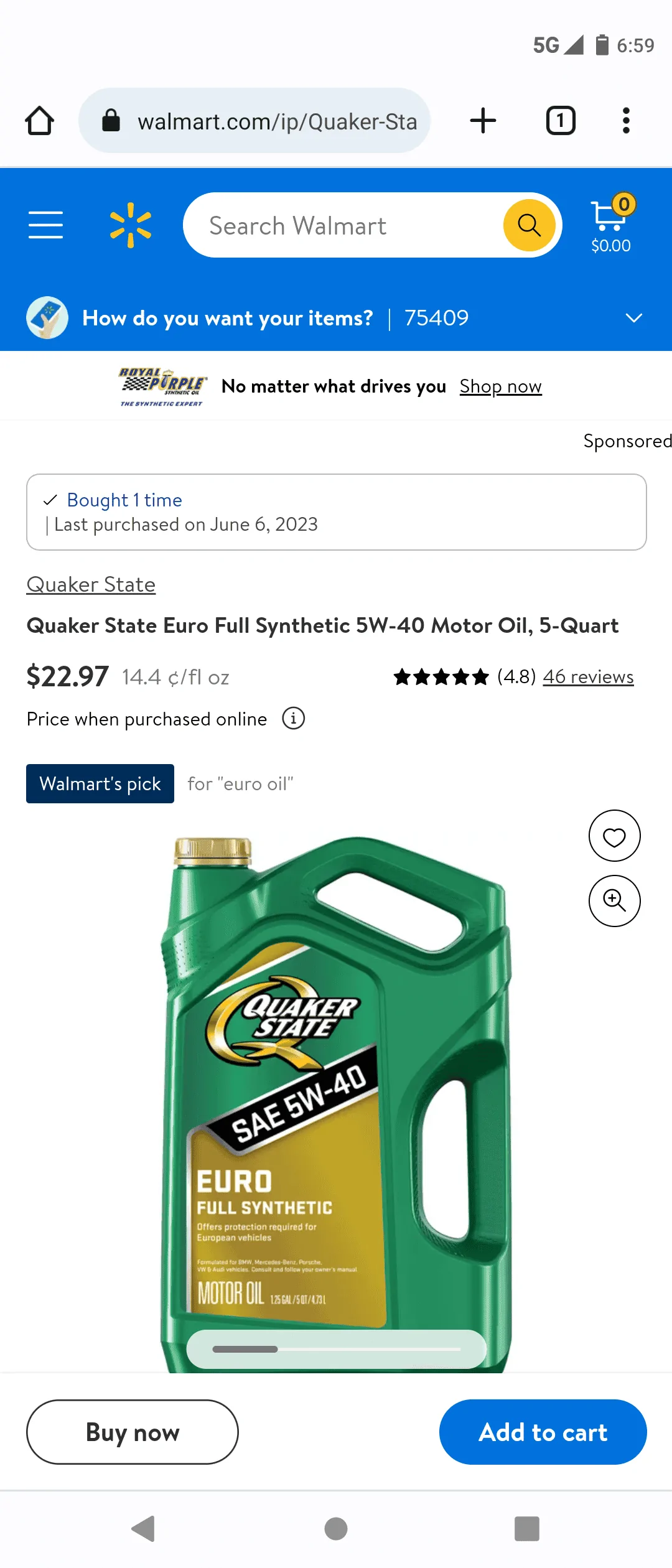

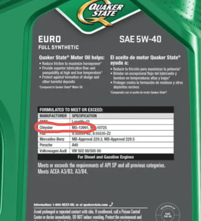

I was going to buy just API SN oil without the Wrangler special certification thingy. I've been using Quaker State for about the last 10 years because I'm a total cheapskate. But I've also had zero issues with the brand. While searching for the best prices around for just API SN, I found that I can get this Quaker State at my local Walmart for just under $50. So it looks like I'll be meeting the recommended and the required specifications.
I'm at 4955 mi as of when I got to work this morning since my last oil change. So it looks like I'll be doing that oil change this weekend. ;)
