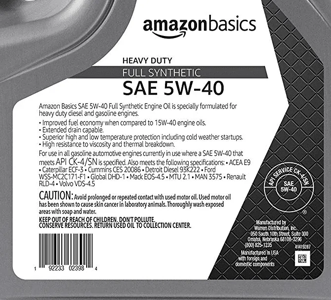

Sorry I thought those were interchangeable designations
that’s also the first amazon oil I’ve seen without API - SN+
Some of the designations may be interchangeable. Some different designations may actually be a better oil, but, I don't want to get into all that to avoid confusion. Just making a list the has both the MS-12991 and API SN, that way there is no question for those who may not know any better.

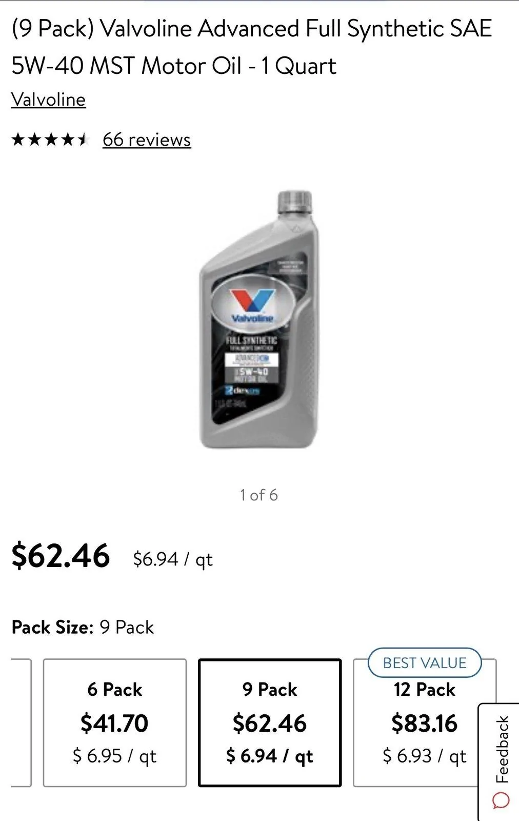

$62 plus filter would be ok in my book

Slightly lower price per volume compared to the valvoline but I haven’t the foggiest idea what the performance track record of that oil is...anyone here have any objective testing with it?
