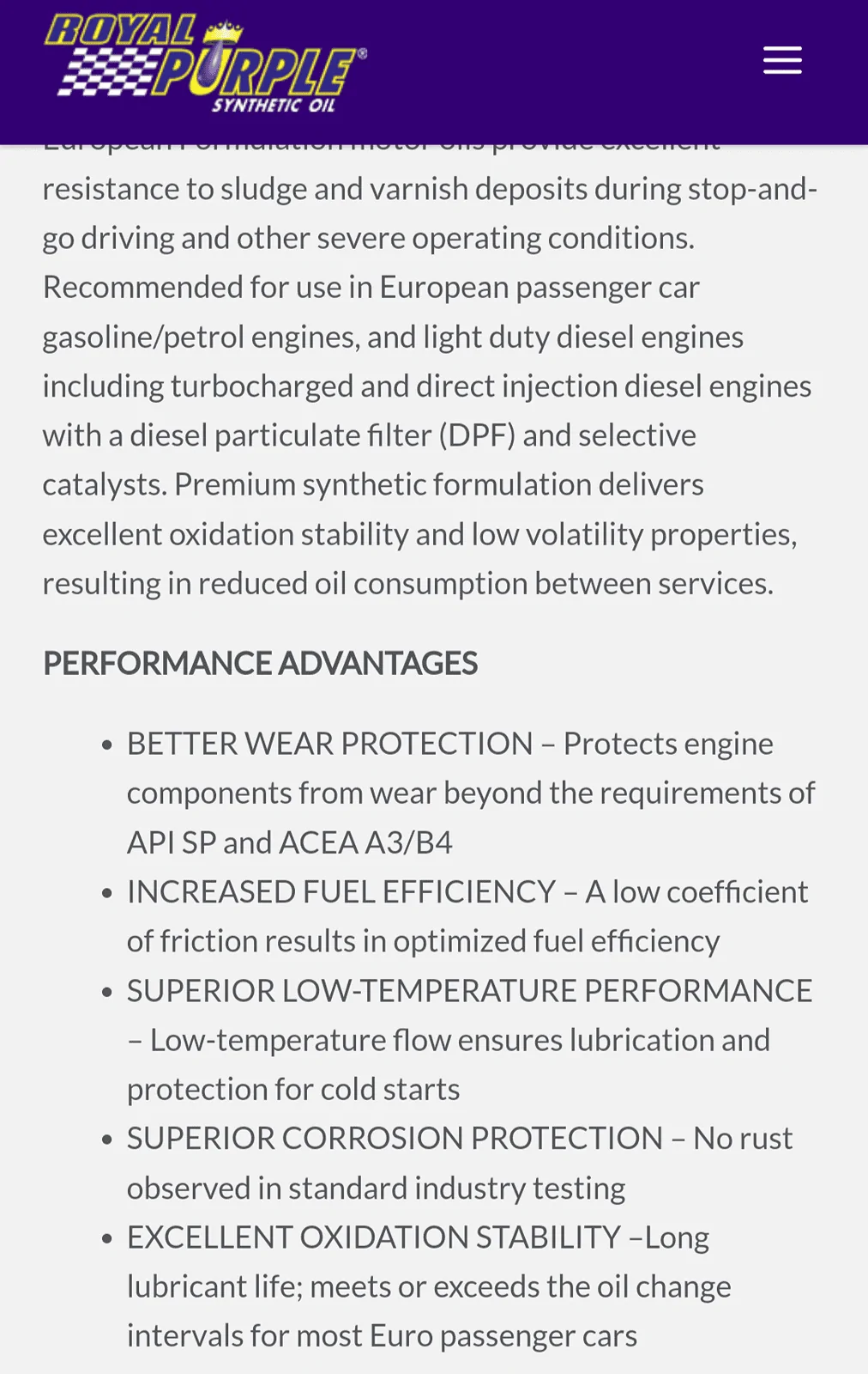

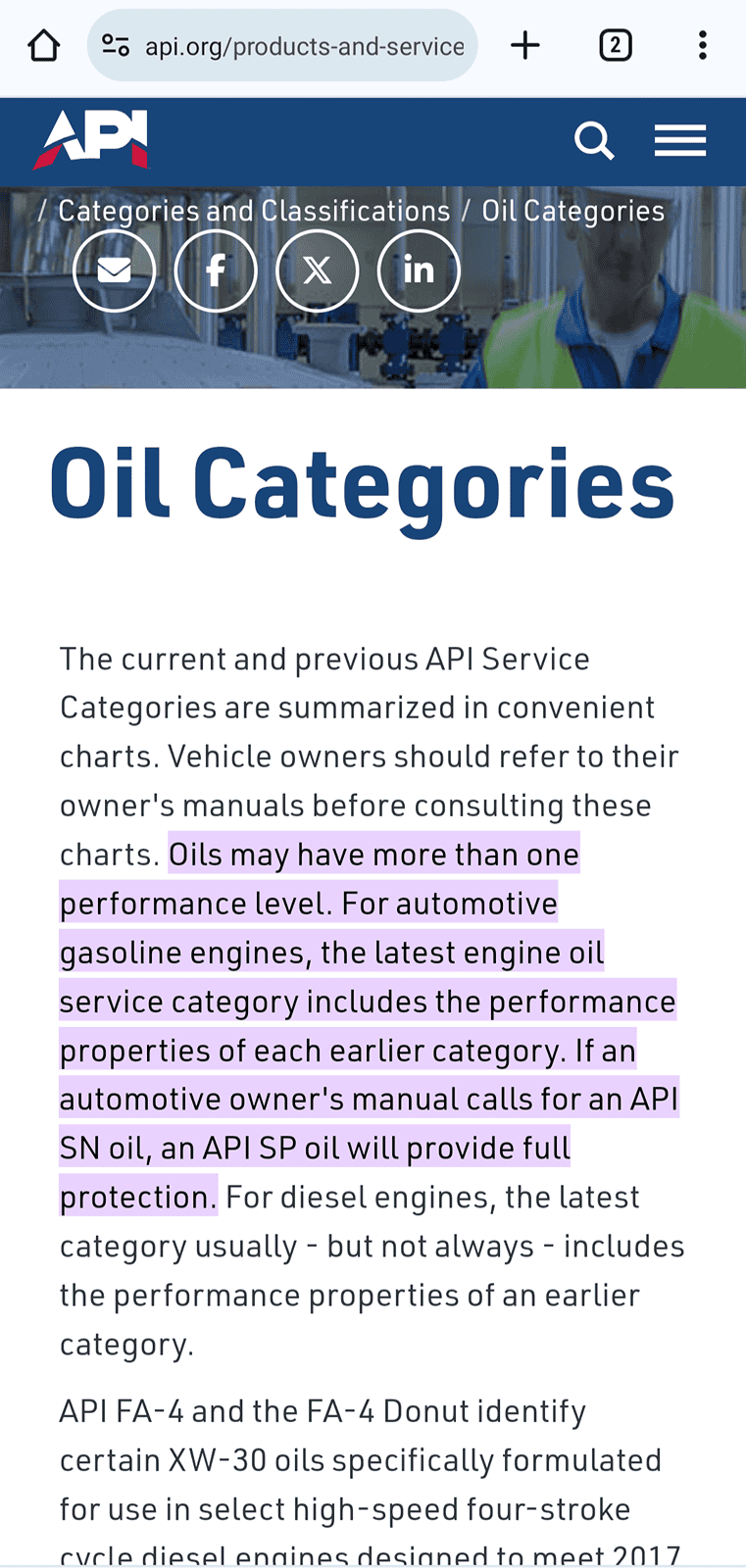

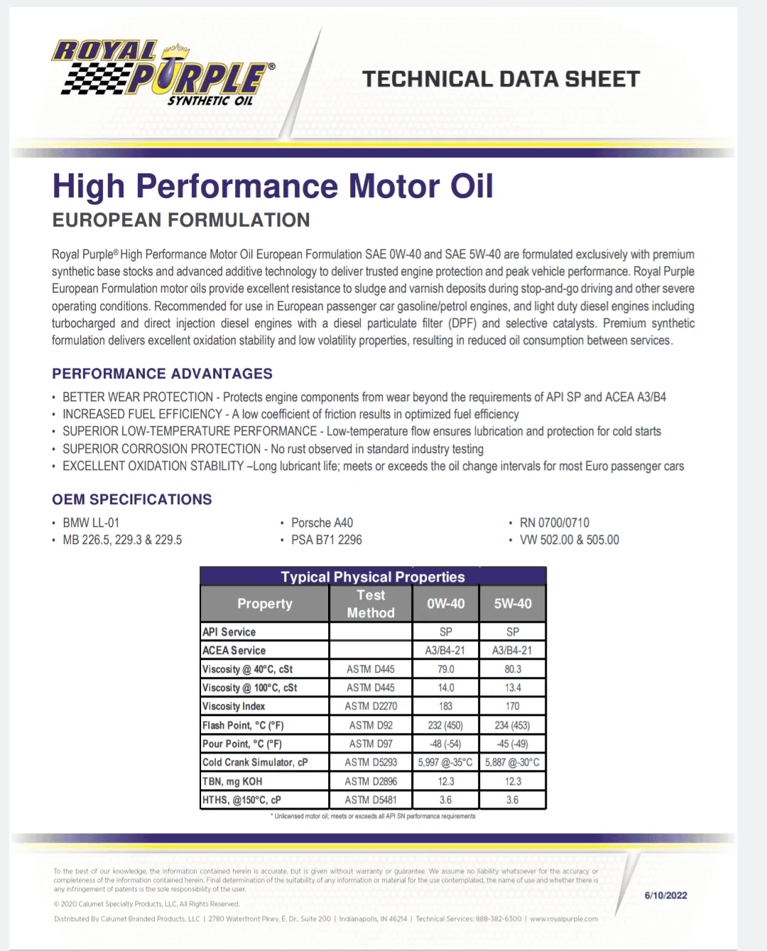

I'm coming up on my next oil change as I near 40,000 mi (5,000 mi intervals). I've been wanting to run Royal Purple this time around, because of it's gunk ridding properties.
It does not meet the MS-12991 specifications from Mopar, however it does meet the API-SP standard, which as it turns out after a little research, is a better more restrictive standard than API-SN. So basically if your Wrangler 3.0 EcoDiesel can run API-SN as a requirement, then it can also run an API-SP.
(Per The API oil classification website)
Jeep Wrangler JL MS-12991 RECOMMENDED; API SN REQUIRED Screenshot_20240606-155116-723
(Here's just a random Google article I found)
Jeep Wrangler JL MS-12991 RECOMMENDED; API SN REQUIRED Screenshot_20240606-155030-831
And here is the Royal Purple 5W40 SAE Full Synthetic European Formula performance advantages listing the API-SP classification.
Jeep Wrangler JL MS-12991 RECOMMENDED; API SN REQUIRED Screenshot_20240606-155200-511
Along with a (screenshot of the) technical spec sheet from Royal Purple for the SAE 5W40 European Formula.
Jeep Wrangler JL MS-12991 RECOMMENDED; API SN REQUIRED Screenshot_20240606-155302-145
