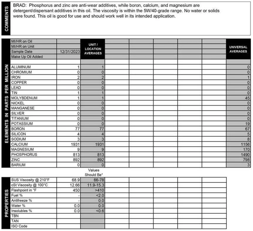

Oil analysis on fresh oil:

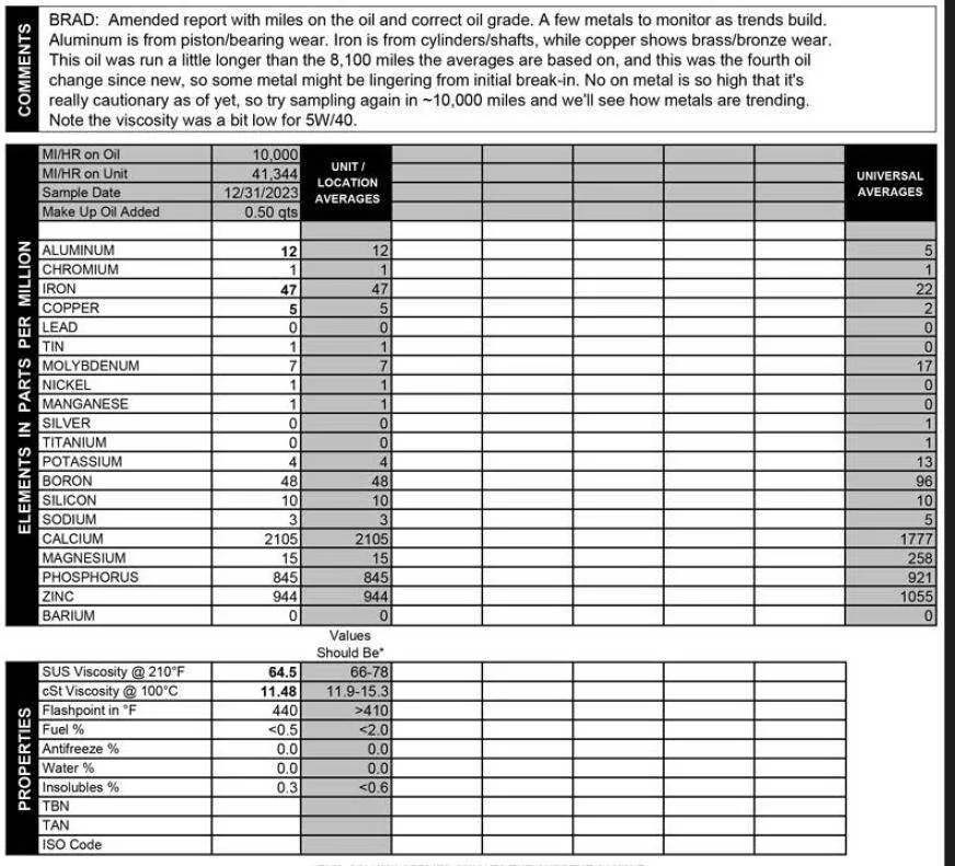

Analysis on first oil change with ~10k miles on the oil and ~40k on the vehicle.
They mistakenly thought it was a 5w-30 oil then corrected and resent the report. Still noted viscosity was on the low side.

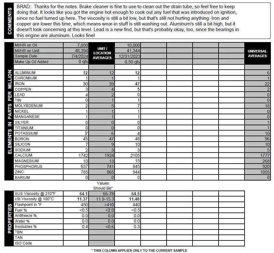

Got the latest oil analysis back. I had to change it a little earlier than planned due to a road trip, so 7,050 miles instead of 7,500.
Jeep Wrangler JL MS-12991 RECOMMENDED; API SN REQUIRED 1722633057590-n2
I emailed with some questions and got this back:
"Potassium is normal at 7 ppm, and the other additives you mentioned (moly, boron, calcium, phos, zinc) are fine, too. Every brand/blend uses a different additive package, and it's totally normal for additives to vary from one report to the next, especially when you swap oils.
Sodium and potassium can be signs of coolant contamination, but we don't worry about that unless they exceed 20 ppm. Silicon has two sources: dirt (not good) and silicone products (which is harmless). Silicon was low in your sample, so we don't have any concerns about air filtration.
Lead can be from fuel additives, yes. This engine has aluminum bearings, so we're not worried that the lead in your report shows poor wear.
As for the viscosity, it's fairly normal for us to see a marginally low reading from the 3.0L EcoBoost engines, and usually it's just from harmless shearing. We don't consider a low viscosity a sign of trouble unless it's correlating with excess fuel dilution or other problems, so no worries about that.
Your oil temp seems pretty normal, and as for the flashpoint reading--that's how we get a measure on fuel dilution. It's the temperature at which the oil's vapors ignite, and if the flashpoint is low, that means fuel is present (we didn't find any in your sample).
Regarding the oil type, Motul is good oil, and any API-certified engine oil that's cleared for use in your engine should work just fine. We don't see a difference in wear when it comes to different oils/blends. Oil is oil as far as we're concerned! Just look for that API sticker and you're good to go.
I wasn't worried about the potassium before their response but I was curious why it would go up since the virgin Motul analysis had zero potassium. So I'm a little worried a coolant leak may be developing. Somebody else on here mentioned detecting a coolant leak through oil analysis, hopeful I don't do the same.

I've been adding about 1 oz of coolant to my EcoDiesel once a year on average.
I've been under the impression that it's evaporating, because coolant has a good habit of doing that. But you think that it's getting into your oil?
How often do you add coolant to your overflow tank and how much coolant do you add each time?
Well since the virgin oil doesn't have potassium, even if the Mopar oil I was using had it as part of their additives, the number should be decreasing.
I can't remember the last time I've added coolant though. I checked my fluids before the trip but didn't need to add any. I didn't check when I got back though so I'll have to look at it when I get it back from the shop. Yesterday I got a check engine light and pulled code P20EE - SCR NOX catalyst efficiency below threshold bank 1.
