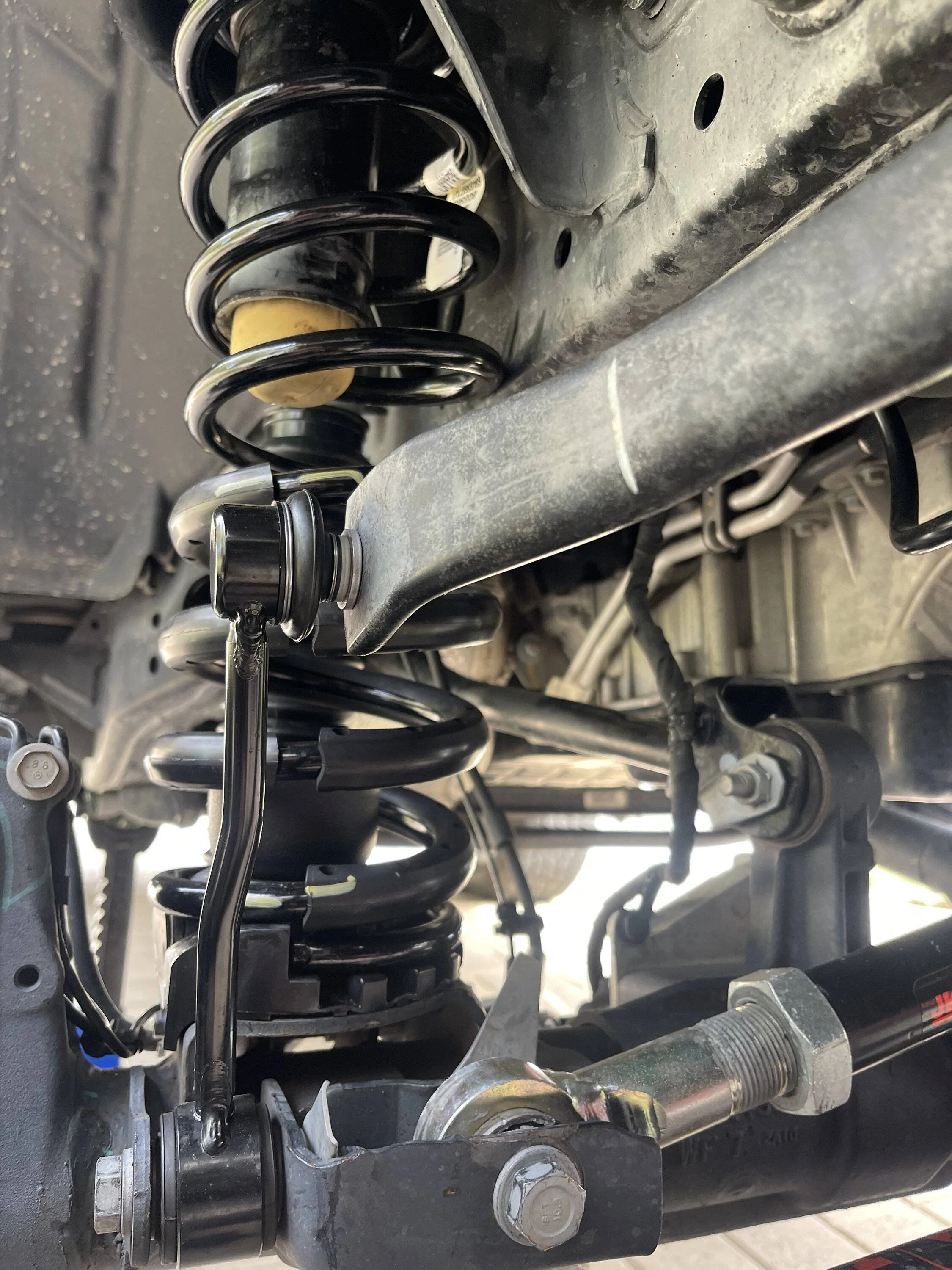

Here is my before and after with the RK pads and Mopar lift. This was years ago and now maybe the springs are improved and the RK pads add too much??

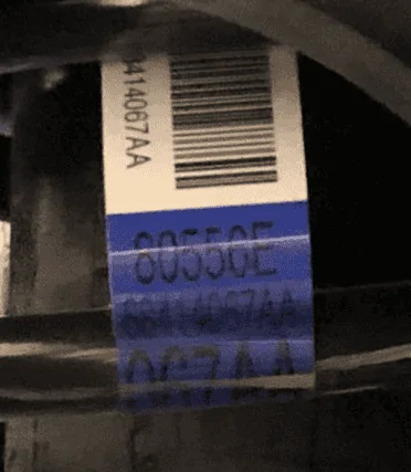

Hi. Going through the replies. I meant to ask. Is your JL diesel also ? What is the part number of the right front /passenger front spring ? I see blue tag I sure the driver side has a difference color. Just want to compare to mine. Does the right side end in 666aa or 667aa ? Thank you

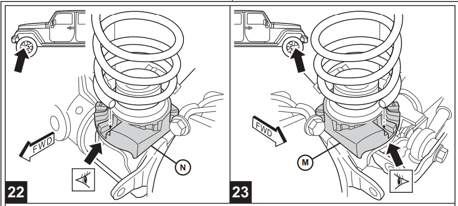

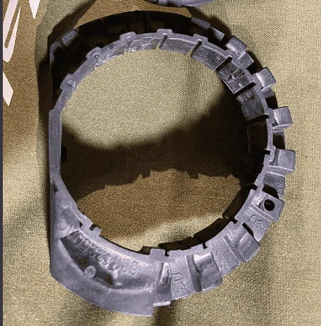

Just throwing something out there, I don't know where the new instructions are.
The Mopar lower you posted says right, and the p/n matches the old right p/n.
The Mopar instructions show the coil termination positioned to the rear. Your picture shows it positioned to the front, 180 degrees off? Or is it upside down and I'm being dumb?

I was talking about the picture you took of the Mopar lower isolator outside the jeep compared to the instruction illustration. This was when I thought right meant passenger, though.
Who f'n knows whats right with how screwed up those instructions are.

if you are referring to the large and small isolators off the truck, those are the old one's

This was on my 2018 JLUR 3.6L. I don't have the Jeep anymore to check the part number in person but here is a closer look of the tag in the photo. Looks like it ends in 067AA. Yes, I think the tag on the other side was red.

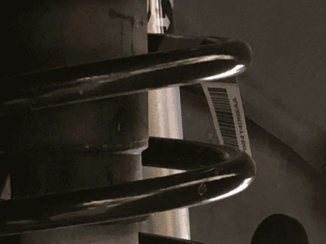

The spring on the other side is a red tag, part number 065AA.

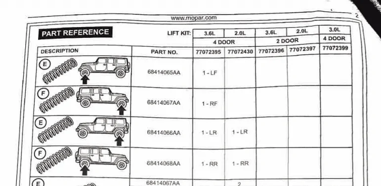

These are the part numbers from the install instructions back in 2018-2019ish. Not sure if the numbers are the same today:
copy that, thank you Sir !

Wait, WTF.
The next page shows part N as Driver and Part M as Passenger. Both coil terminations forward.
this is what im realizing , how messed up the directions are, both coils terminates are facing forward, but it can not be if there is a left and right isolators, as the flat ends of the isolators have to face out, toward the wheel, so either they need to be reversed AND crossover the coils... i will find out tomorrow , as i will be removing it all again ... where is my 2 liter bottle of Vodka ?

do you have a photo of your driver side spring and where the coil terminates please ?
going over the mopar manual, it shows both coils terminate to the front of the car, not one to the back and one to the front....
