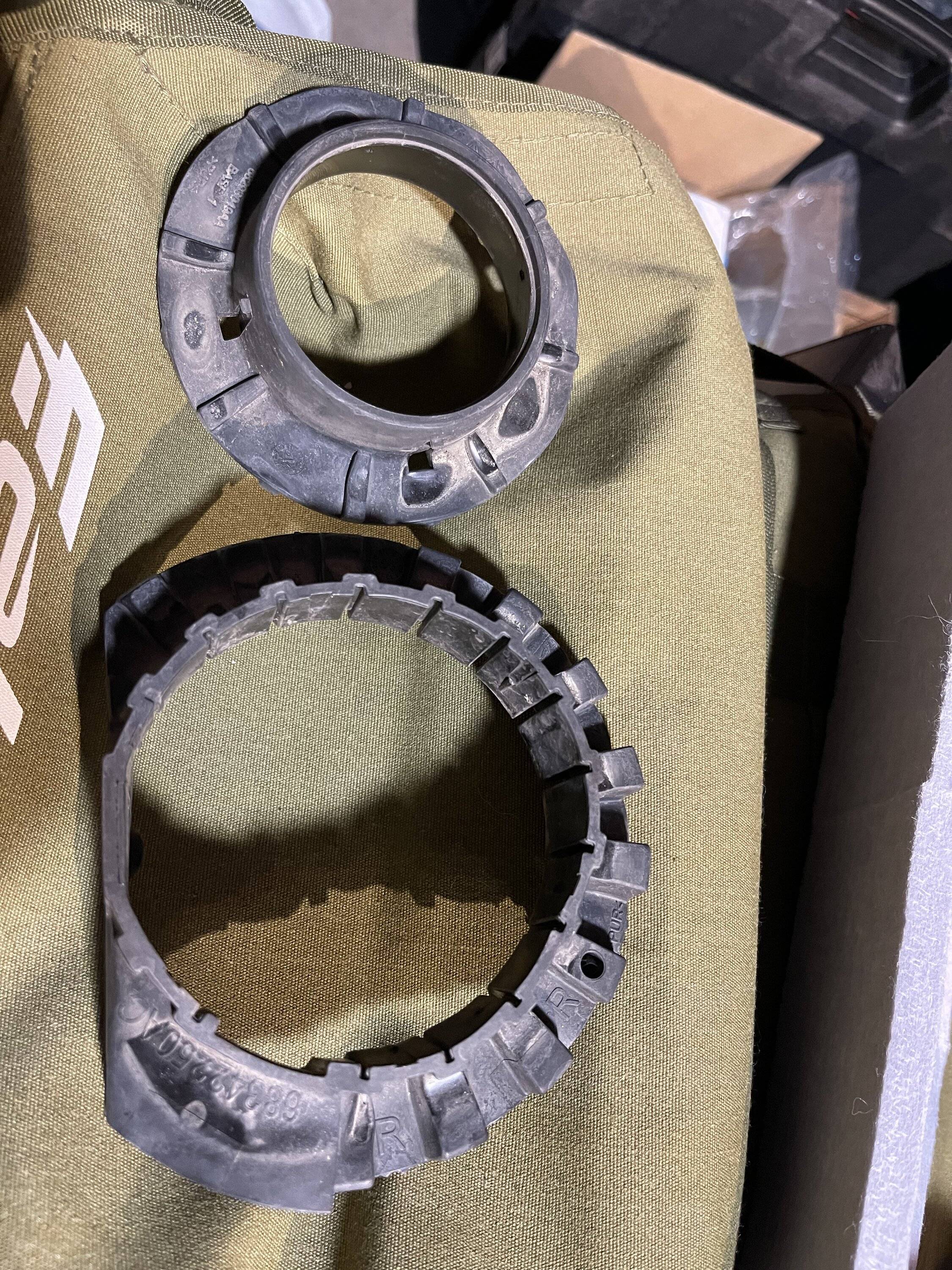

Did you happen to take a picture of the P/Ns of the upper isolators? Should be able to prove it out that way pretty quick.
i will, haven't done that yet . the RK video posted above , showing to cut the 2 rubber nipples and rotate then ( top ones) but then should i install the RK lower pads like before or the Mopar ones from the lift kit ?

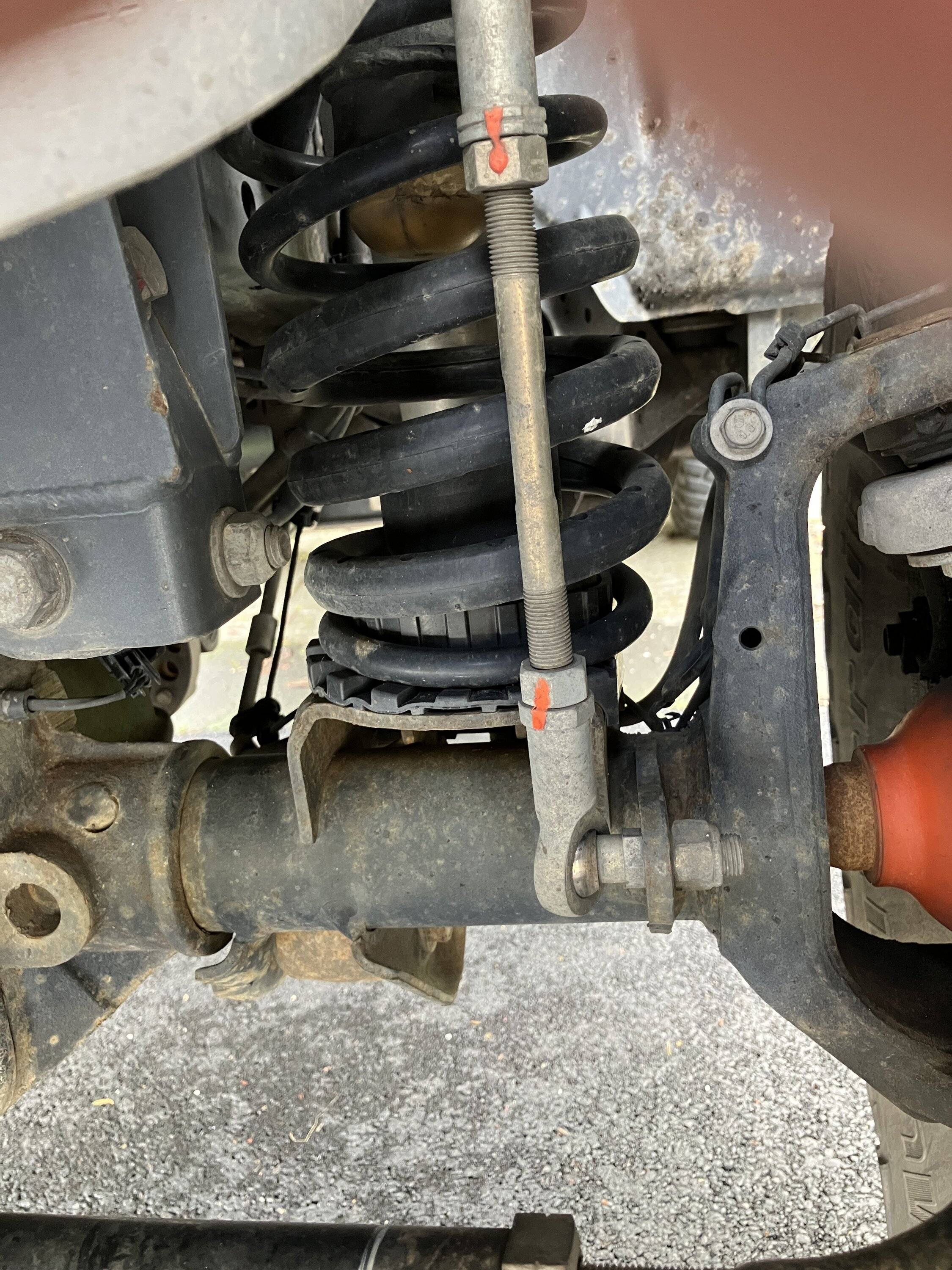

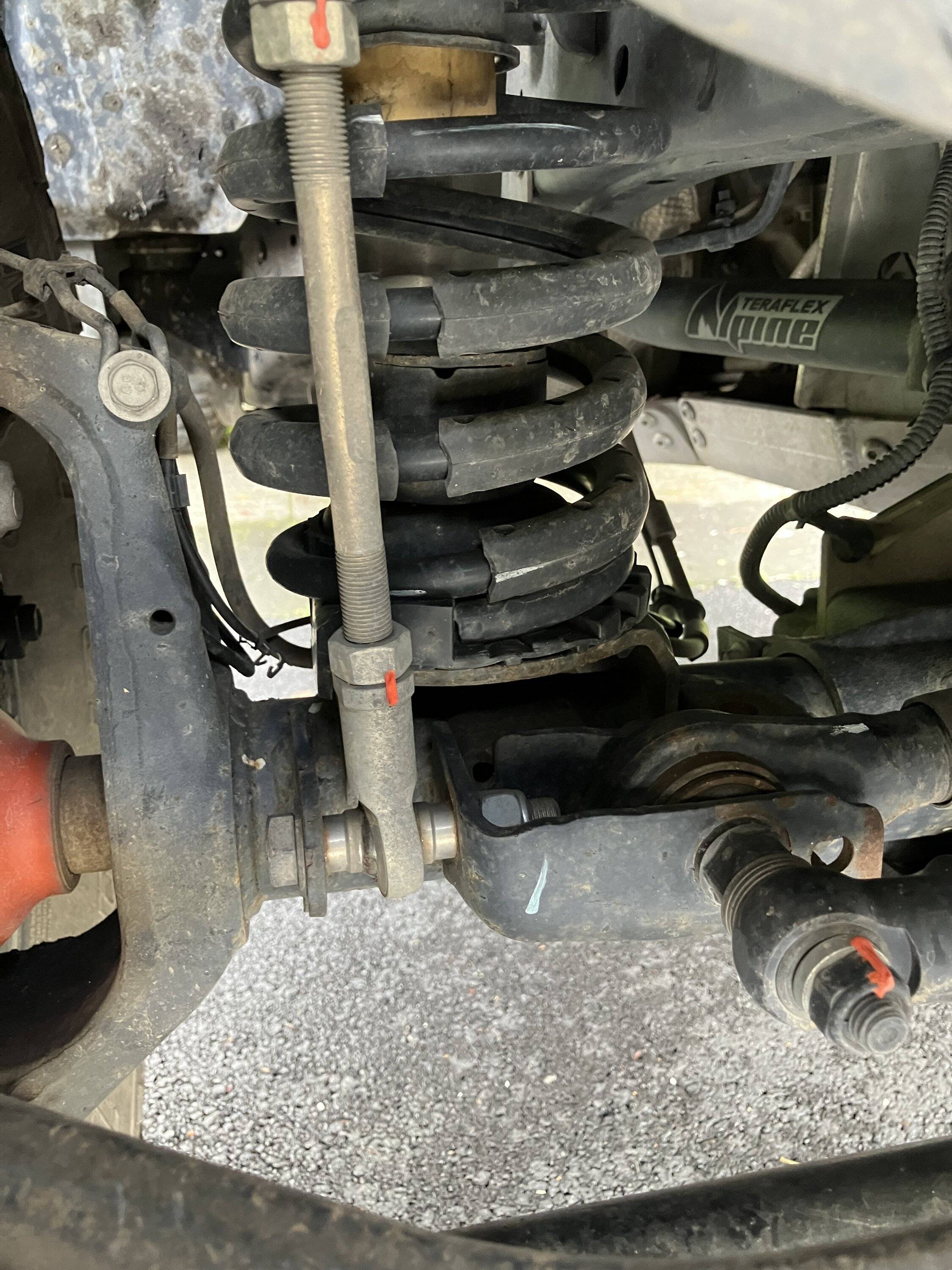

here are some pics of the front springs with the Mopar pads for your reference. there's a little bit of outward spring bow, but this is after 35K miles/3years, and nothing seems to be making any untoward contact.
Did you cut the upper pads the little locating nubs and rotate them ? There is an RK video link one of the gentlemen posted on this convo. Can you please show your from track bar a close up of how far you have set the adjusting head maybe with a tape measure or a caliper ? Also during the install did you notice the factory left spring of was small and passenger side larger with a step up ?
thanks for the photos , looking at the left side spring , im assuming the coil terminates toward the back ?

did you install the lift yourself ? could any of this have to do with being on a driveway at a slope and lifted the front ? i mean its not rocket science , im going to check the upper spring pads, i think they have left and a right , and according to RK, cut the 2 nubs and rotate them , i think it may straighten the spring from up top and a bit away from touching the frame rail
