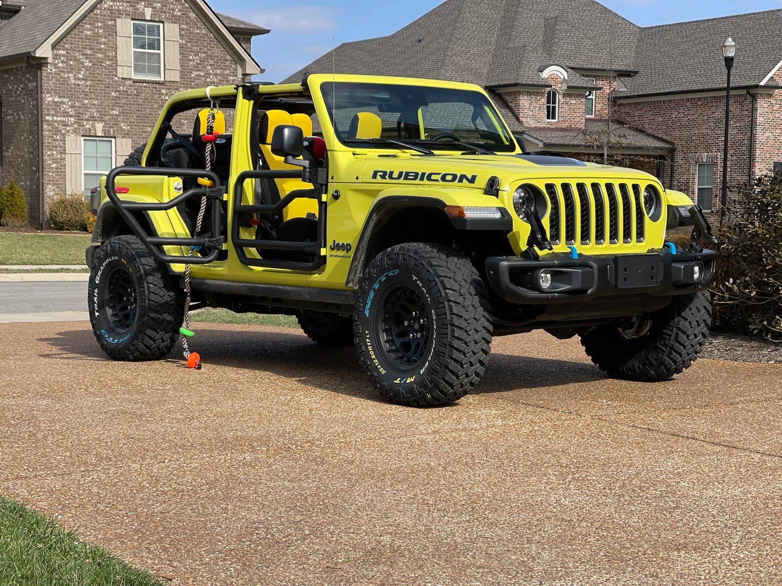

Here is a picture if you are curious how it turned out

looks , great , mine looks great as well, BUT, spring issues, which i will address this weekend, i wonder if there is anyone with Diesel that has installed the most recent Mopar lift and if they can chime in...

Yeah I had no spring issues, but 4xe model has different springs than the others in this lift kit

High enough that someone needs a rope to climb in it!
What tube doors are you running?
