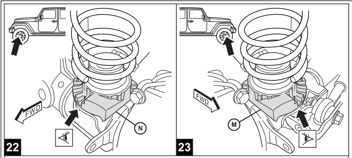

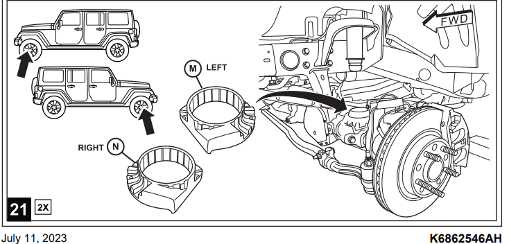

ive gone throuhg the fn manual 15 times, there is no N or M, but i did see L and R , i know im not trippin! , have you seen and M or N marking ? even if i swapped them and lets say i did make a mistake, how would both coil ends be one side front anf termianted th eleft to the front also ?
the positioning pins wont match ... ill take further look once the rain stops , thank you everyone for your replies, i really appreciate you all, taking the time in your busy day to help me out ....
M and N being the part designators in the old instructions on the parts page.

Those are the same. The instructions say that Right is driver and Left is passenger. Who the hell writes these things.
omg lol, are we sure about this ? i have to remove everything again i guess, so does anyone have photo of the installed pads with the coil ends ? in the automotive industry per say, left is from a drivers sitting position, not standing in from of the vehicle , this is a given and anyone and everyone should/would know this ...
instructions says , M is LEFT , however in the b&w photos of the manual its showing M is the right side as the photo of the Jeep is showing RIGHT side lol... are we all confirmaint this is correct? that the left needs to go on the right and vise versa ?
the dealer tech has no idea what i was talking about ... sad sad... i really hope this is the issue and it will be corrected once i remove it for the 4rth time..... instructions were written in an upside down country or office most likely

Shit, do the springs even wrap in opposite directions like the instruction step 22/23? They can't if the RK pads are identical, right?
Looking at your pictures, they both wrap clockwise downward.
the left spring wraps back towards the rear of the car, the right spring ends facing forward
the RK pads did the same ... i give up ... i dont know who to call or who to ask if anyone has installed these recently would know

The RK pads are the same but go on the same way on both sides so that clocks a stop in the rear and one in the front…..
