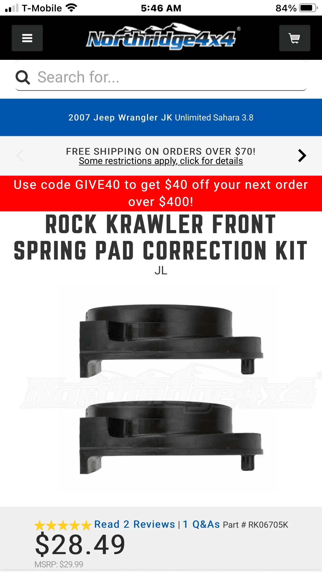

Read this…… it’s what I do when installing the Mopar kit… Don’t know if it’s any better since they switched shocks, but I stopped installing them for people unless they brought me the extra parts listed in here……customers were getting over 3” and would come back to have me fix it, so now no extra parts, I don’t install it, lol….

thanks for this , im going to buy the JKS as i want to keep it the same as the front, which is around $180
For ~$30, I'd grab the isolators @Roky recommends in his link and throw them in when you install. Cheap insurance against having to pull the springs again.

RK isolators ?

RK isolators ?
I got the one from MetalCloak. Any high quality rubber would be sufficient.
The mopar isolator is garbage. The spring has been bowing since day 1, and mopar's youtube video saying it's an engineered feature. I don't buy it and it turned out to be caused by garbage isolator.
