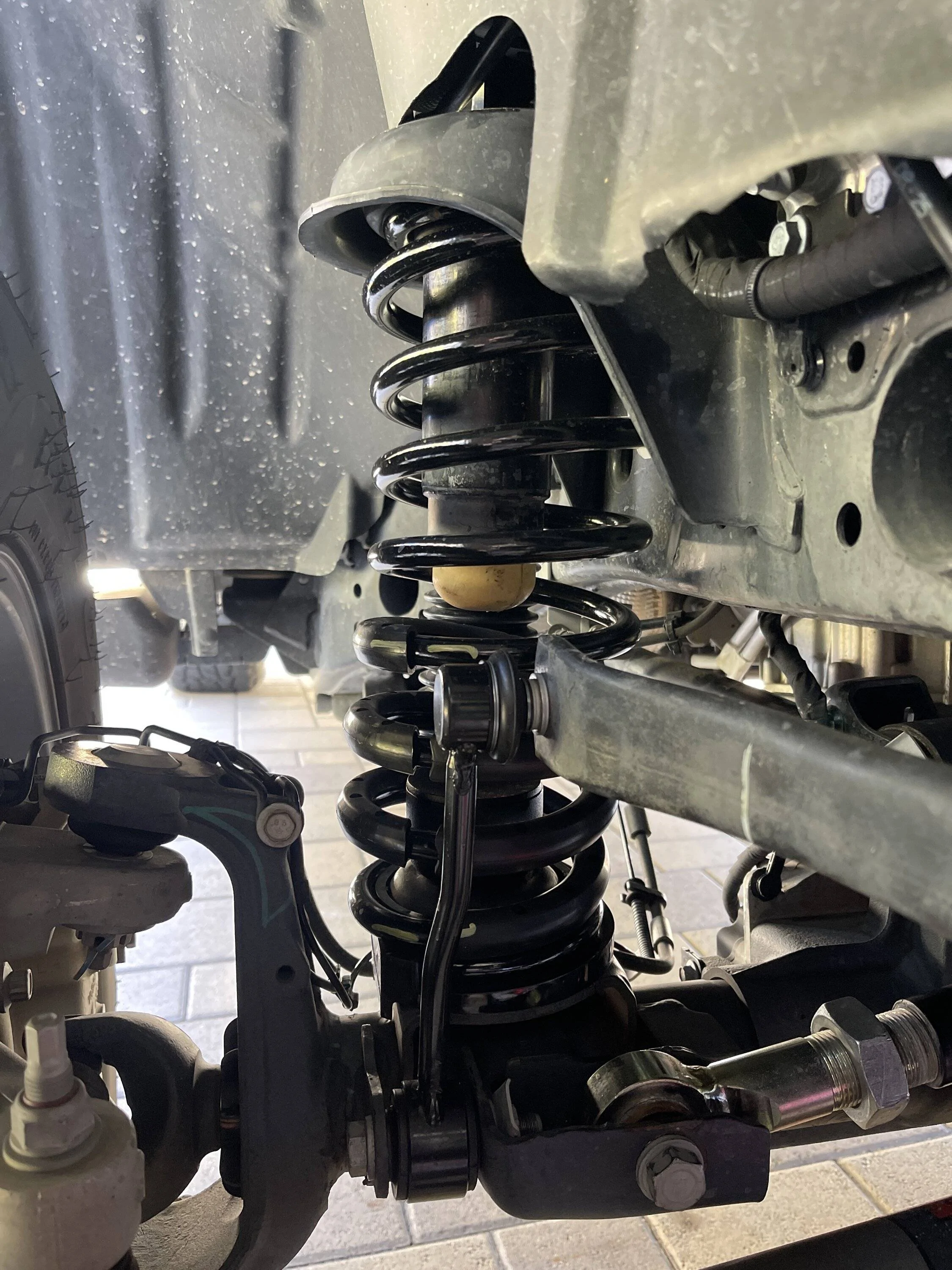

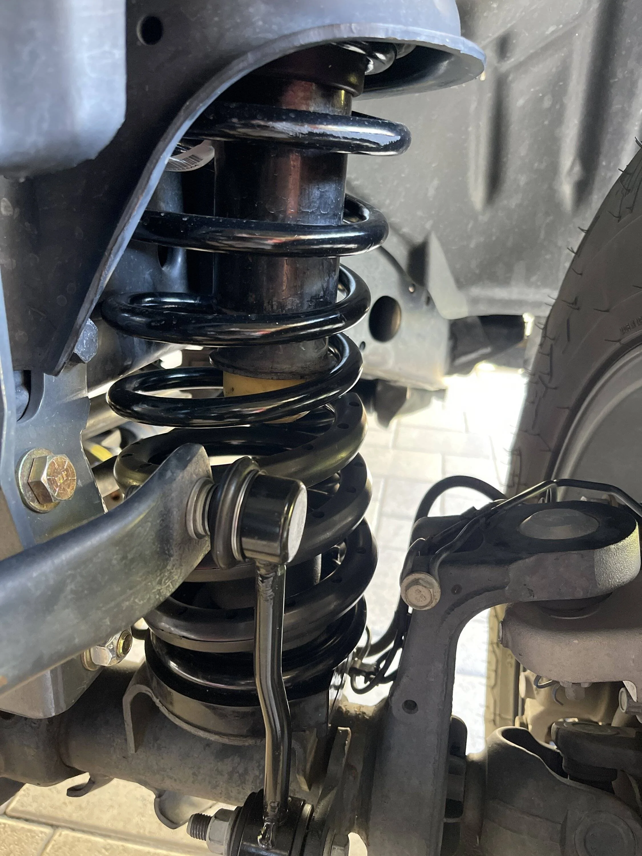

I’ve been attempting to move and center the axle. But the drive side spring is bent !!! I have opened meaning extended the track bar and nothing is happening. I even closed it almost to stock length and the driver spring is touching the shock mount. Is it because of the driveway ? I’m lost at this point I did the measurements as well with the stud and tape measure …. Please chime in !
I did add the RK front lower pads could these be the culprit ? They are angled. Vs the Mopar ones in the lift kit
and in the picture I’m trying to move the frame to the left (driver side ) extending the track bar - I think I need to close the adjusting bolt so the spring is away from the spring mount …

Set your track bar to 34-1/8” center to center of the connecting bolts, then measure each side like in pics above……

Rocky. I’ve been going back and forth. Shorten. Increase since this morning. I think the RK isolators on the bottom has angled the springs. I think I need to use the ones that came with the Mopar kit as they are flat. It’s supposed to bow the springs outward away from the bump stops But I will try what you just said

Yeah, start with getting your axle centered… then go from there… I just realized you have the diesel ( heavier) so it could be an isolator issue…..

I’m about 99% sure it was not needed mopar states on the install manual the springs are supposed to bow outward. Toward the wheels. Equally. I listened to someone here. And it was not needed ! I’m going to remove them next weekend. Sheeshhh ?
