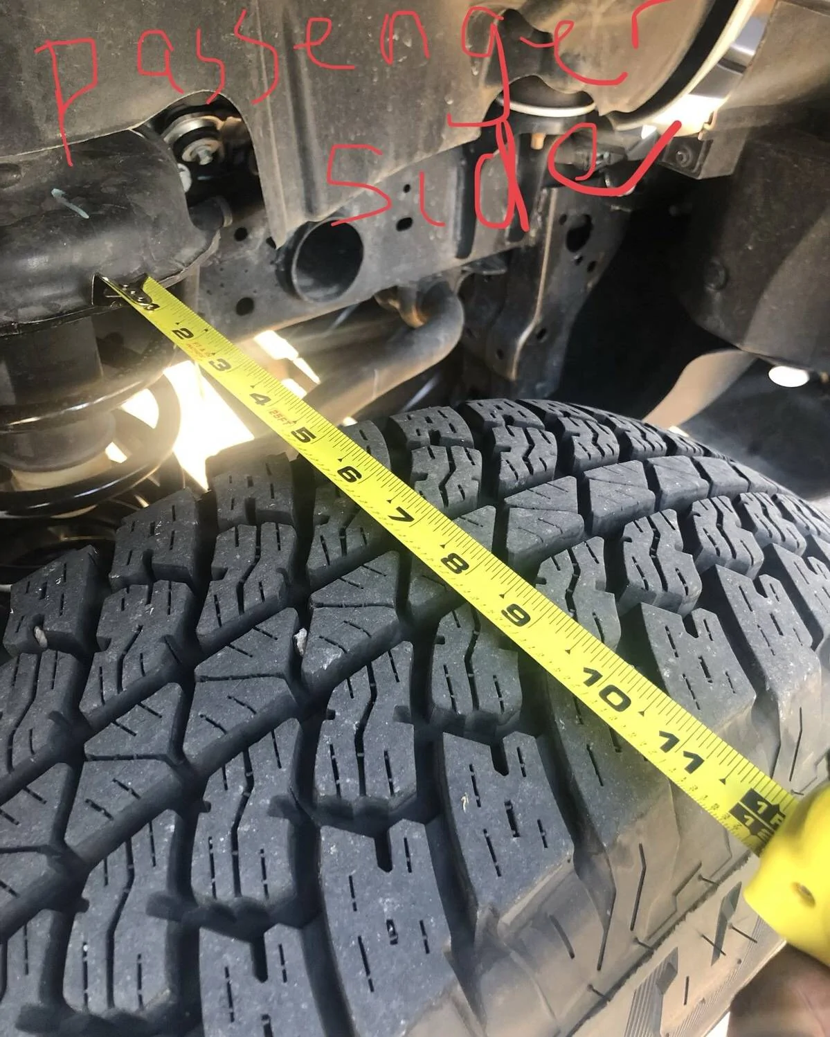

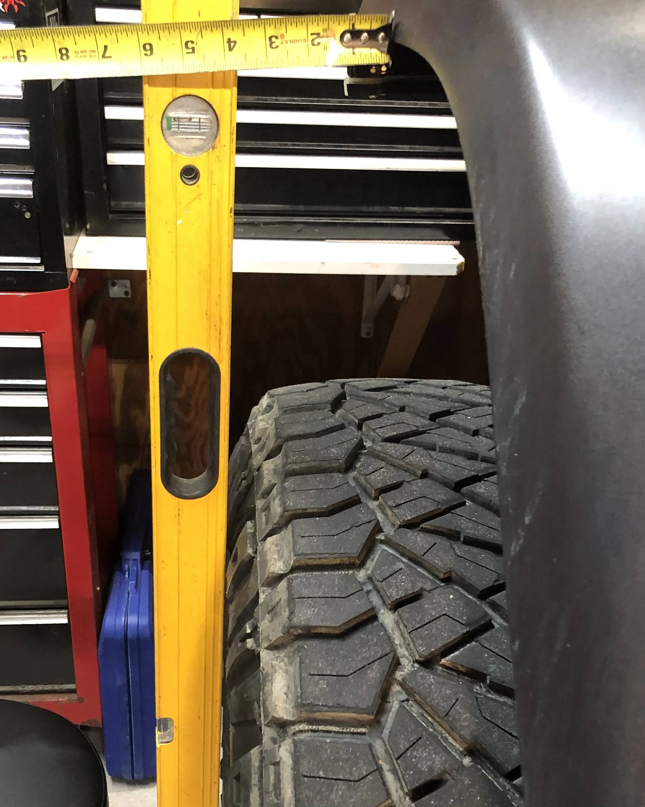

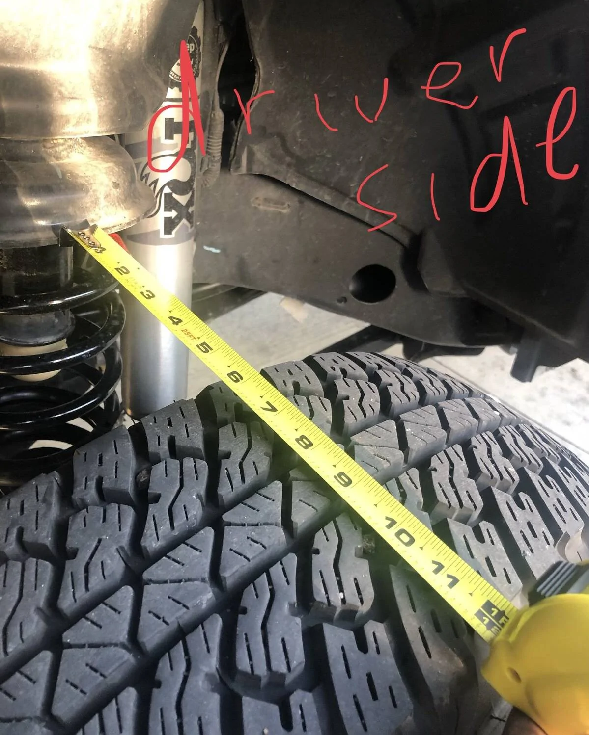

Two different ways I do it, both will get you there….. you can measure from the coil housing out to a lug on the tire, or use a 4 ft level or a straight edge against the tire ( it doesn’t have to be plumb, just make sure it’s against the tire top and bottom) and measure to the fender or the coil bucket if the tire isn’t in the way….. pics….
thanks!
I did a mix of your techniques on my first try and definitely botched it. Will be trying option 1 this coming week for sure!
