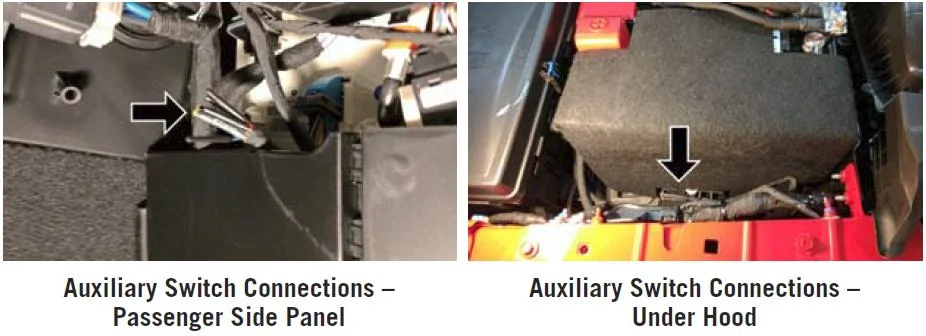

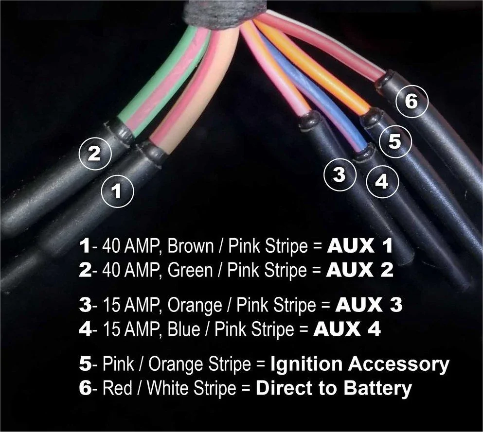

Jeep Wrangler JL Mopar AUX Switch Install Help needed AuxiliarySwitchesconnectunder hood
#5 and 6 in this picture are on;y found in the Aux bundle in the passenger footwell, not under the hood in the Aux bundle there.

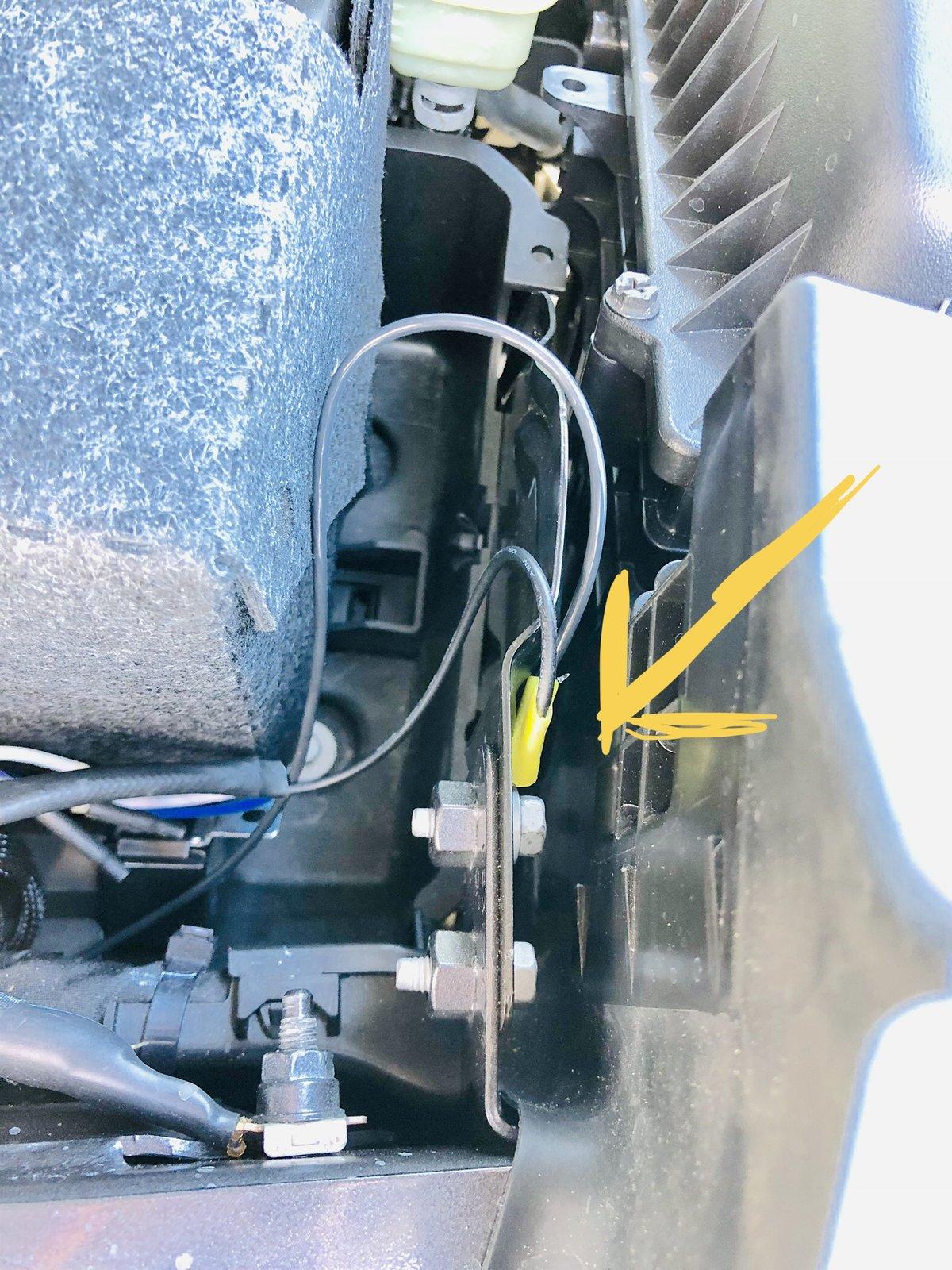

Jeep Wrangler JL Mopar AUX Switch Install Help needed 12v source wires
Read through these threads and then come back with any questions you have.

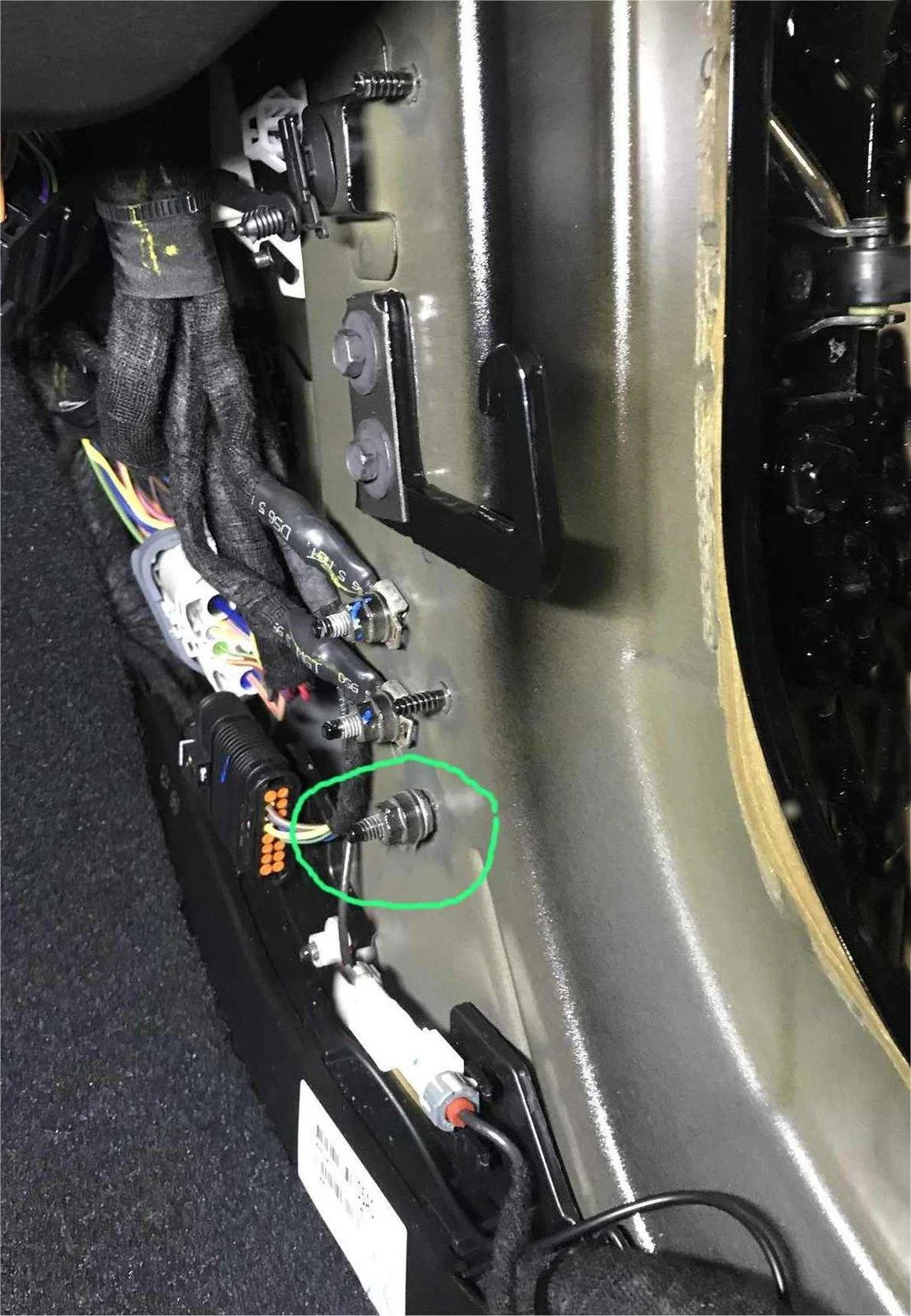

Thanks! I found the cable, and identified the wires. Now my next question (hopefully the last): Where are you picking up a good ground connection?

With the dealer/self installed Aux switches, youwill find a fuse on each individual Aux wire itself.
