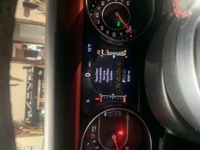

I have the same ESS problem after having the dealership do the flash to add the aux switches. Reading in other forums and comments on the youtube video people said that the secondary auxiliary battery was fried and had to be replaced others said it was a bad connection with the orange wire under the kick panel. I had read all that before I did my installation so I connected the orange wire without using the connector that was provided in the kit. I need to double check it but I'm guessing its something the dealership may have to fix.

Are you taking about the auto start stop? I never got that error from this install, but it would pop on after driving awhile until i would do a hard restart.
Personally i never liked it and permanently keep it off with tazer. I took it to the dealership to figure out the error and they said they could not replicate it all that garbage. I will say when I unplugged that harness by the door and finally got the orange pin connected correctly it was like a Christmas display on my Dash! I had locker warnings you name it sway bar disconnect warnings everything popped up I thought I ruined something but after I shut it down and started it up again everything went away

Get this message on start up and then a persistent warning icon above the fuel gauge

I ended up with both my orange wires weren’t fully seated.
when I fixed the kick panel, I agree my entire system freaked out. It took a full reboot(taser) to get all functionality back, it took 2 days for my backup assist lines to come back(strange)....
...-and of course the six orange wire fix was less eventful.
