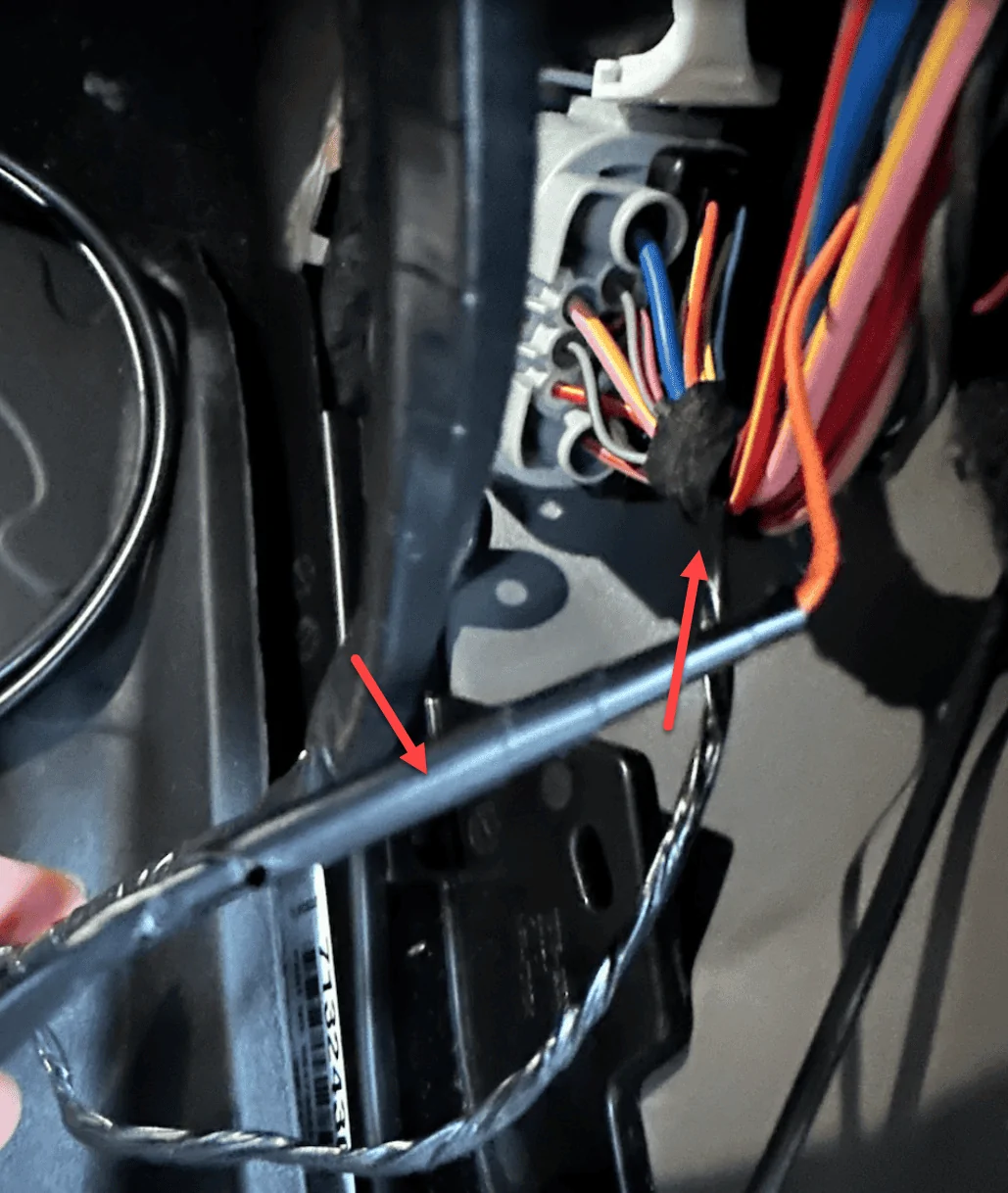

For those that have had issues removing the orange wire (pin 13) - does anyone have any pics of how they spliced the wires together if you can’t get this pin out? I’ve tried most everything and i think i need a 2nd option. Thanks in advance.
Ken

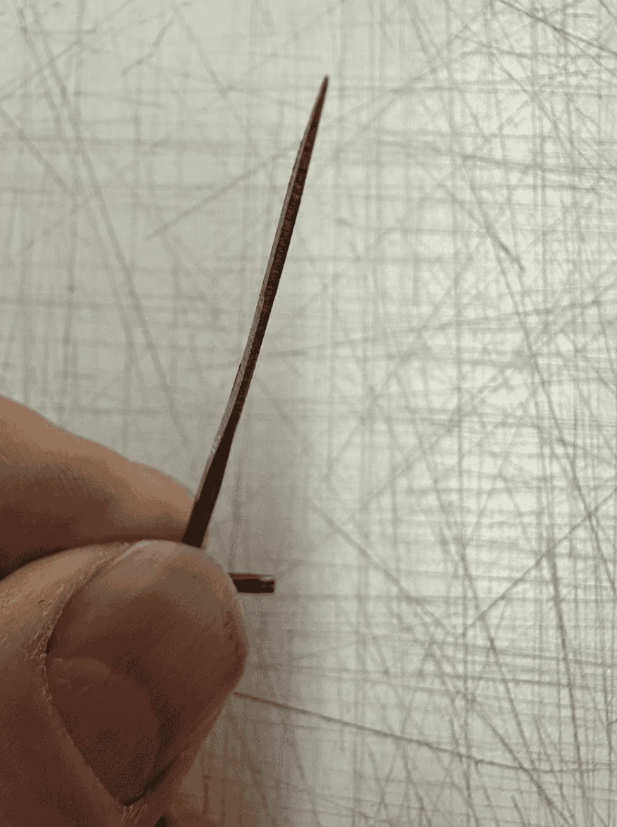

I had the same issue, but I broke the wire trying to get it out. What I found is, get your smallest Allen key and die grinder out, grind down the sides and top about 1-2" up to make it thinner and put a nice sharp point on the end. That will de-pin that connecter. Nothing else I tried will. Here is what I ended up soldering and shoving into the pin 13 location.

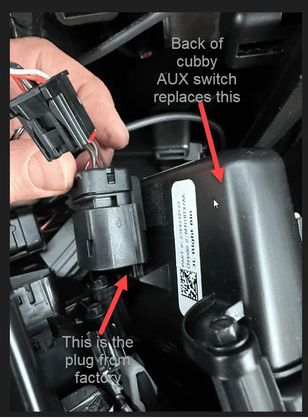

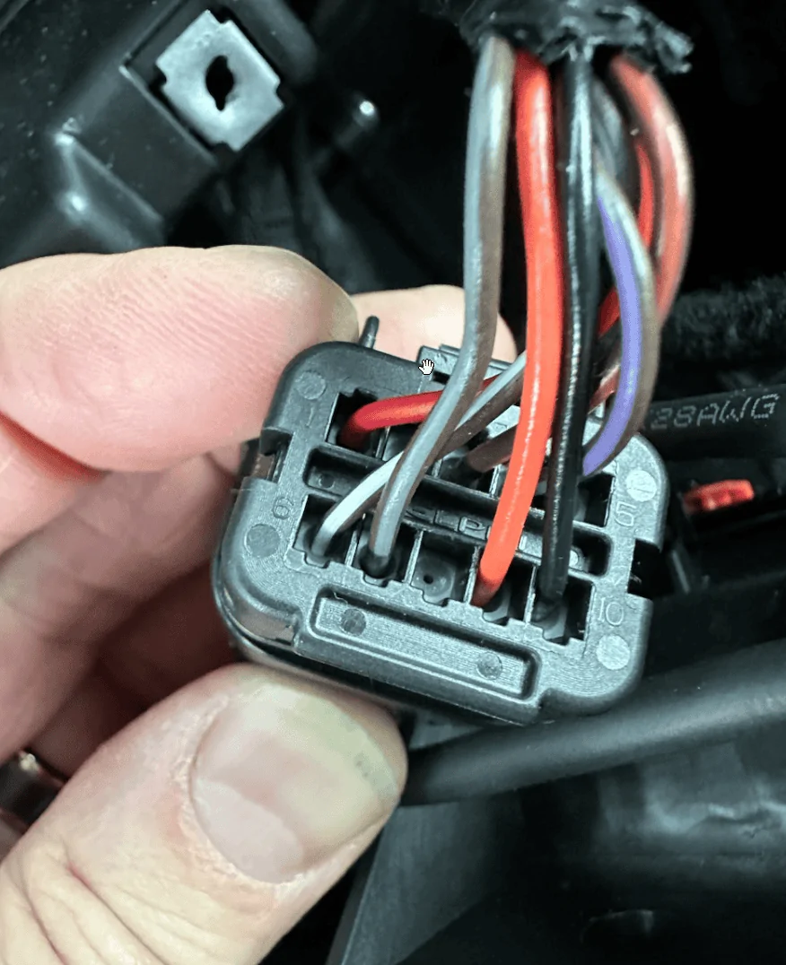

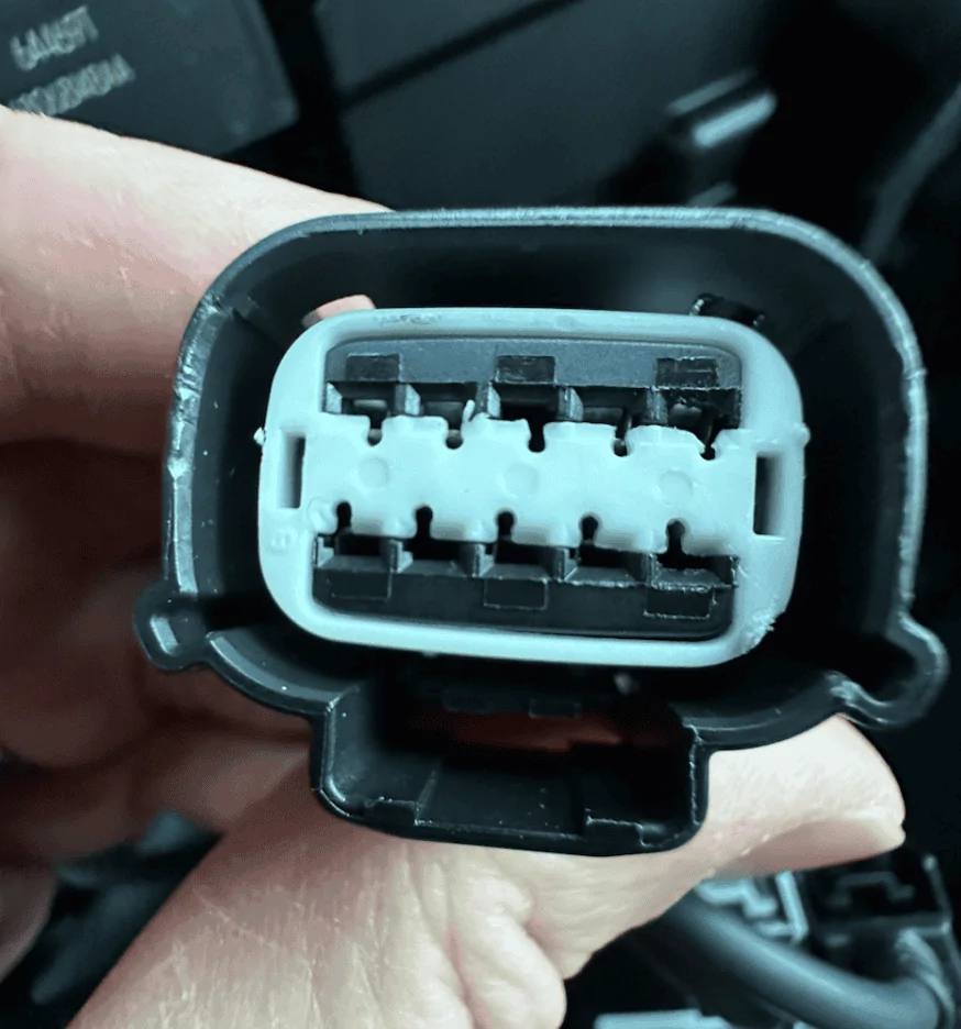

Quick update, going back a few days, during the installation at the very end when wiring the plug to the switch bank, I noticed I had an existing factory plug fixed to the inside of the cubby. I ignored it because I was not sure what it was for, but it matched the plug on the AUX switch kit -so I'm assuming this is used if the Jeep had the AUX/trailer tow option. Long story short(could not get the switches to light up when coming from the kit harness), I tried this mystery factory plug just for grins. All the lights work and are able to be programmed from the uConnect. I can't be the only one that has a 2021+ jeep ordered without the AUX switches that included the console harness. I’m not an automotive electrician, but would you think there would be any danger in using the can bus (OG), RD BK wires from this factory plug (we know they work) and de-pinning the other four wires and using the 4 relay leads from the kit to make things functional? Everything else would be the same as the instructions. I could probably even put the orange can bus wire from the passenger kick panel back the way it was. Wonder if Jeep started doing this as people complained about how hard the Mopar AUX kit was to install.

I ended up just using the wiring and plugs provided in the kit and following those instructions. I could not find any information on utilizing the already included factory plug/wires.
