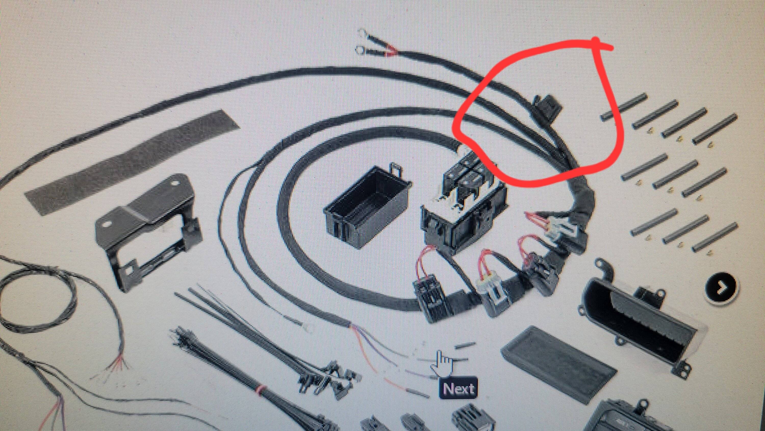

Having this issue now. Installed Aux buttons no backlight or orange light. Replaced the fuse. Still nothing.
Are people splicing and direct connecting the small connector that has the separated orange wire?
Or the orange wire that went into the large wire harness connector?
Have you gone to the dealer or used something like a Tazer to enable the Aux buttons yet? There will be no light or function until they are enabled.
Yep, Tazer activated, Aux buttons available in settings
