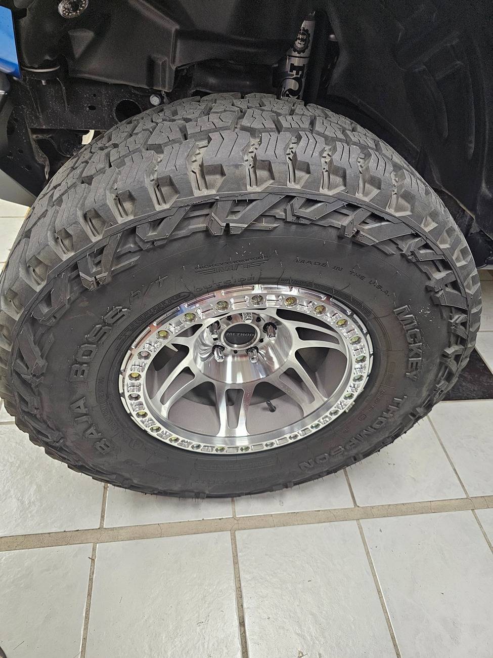

On my 23 Wrangler Rubi 2 Dr, I am running Mickey Bajas LT315-70-17 Load Range Es on Method 106 Beadlocks and I airdown to 10 pounds for the dirt and air up to 37 pounds for the road and I have had no problems.
I retorque my Bead Lock Bolts at the beginning of each month.
Jeep Wrangler JL Method Bead Grip wheels how low have you gone? 20240514_060520

I’ve never had Beadlocks so I’m curious. Are you just.checking torque or are you actually retorqing them, meaning the bolt needs to be tightened?

Usually, there will be 2-4 bolts that are a tad less than spec on a couple of wheels. How much are they loose, they're not that loose and my guess is they barely turn and torque to spec.
