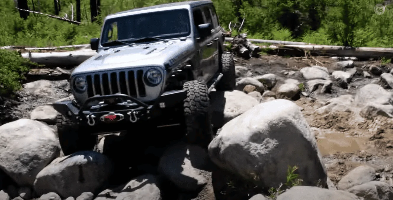

If we're discussing "to beadlock, or not to beadlock" and beadgrip wheels. I'd like to toss in the other option: Icon Rebound Pro Innerlock wheels, or as I call them: beadbolt wheels.
I've run them for only about a month, but have tested them down to 10 psi on John Bull and Holcomb Creek BOH trails rock crawling as well as running them at 15 psi through "the Squeeze" on Pinyon Mountain trail in Anza-Borrego. I know they have limitations less than traditional beadlocks offer. But they do mount in a traditional non-beadlock manner and are DOT compliant. That fact opens up the ability to have them mounted and balanced at a common tire shop. The Torrance CA America's Tire (Discount Tire in my region) mounted mine and were very good at following the mounting instructions, which have a specific process that I led them through and didn't charge beyond a normal installation even though these take longer.
