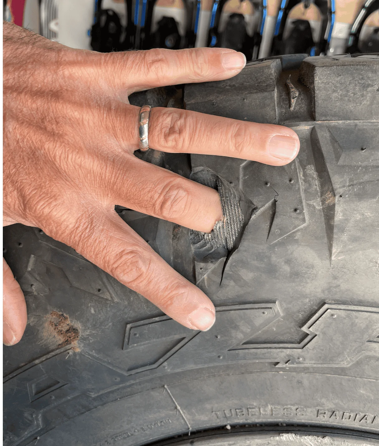

UPDATE:
I've been running Method 701 "Bead Grip" for a while now on some pretty challenging trails. Let's say 15000 miles. 37x12.5 Maxxis RAZR AT tires.
13-16 PSI more times than I can count.
I ran 8/9 psi at Pismo with no probs.
I ran 11 PSI on a couple extremely rough rock crawling expeditions with no probs - except that I think that's actually too low and I prefer a little more pressure for a little better clearance.
Recently, I experienced a blow out. Now, here's the interesting thing; earlier today I took a phone call from the technician replacing the blow out tire:
And the tire machine at the shop couldn't break the bead free. They had to cut the tire off the rim!
I said something like "I guess the bead grip really works." Reply: "Yeah, maybe too well."
After this I'm not going to be afraid of running any low pressure I want that's suited to any condition.
Maybe not Zero PSI Snow wheeling. But pretty much anything else.
I think this tire was damaged in a boulder field and then blew out the following day on an "articulation challenge" type deep gully trail. The trail it blew on wouldn't normally blow a tire (but might force a bead to be broken)

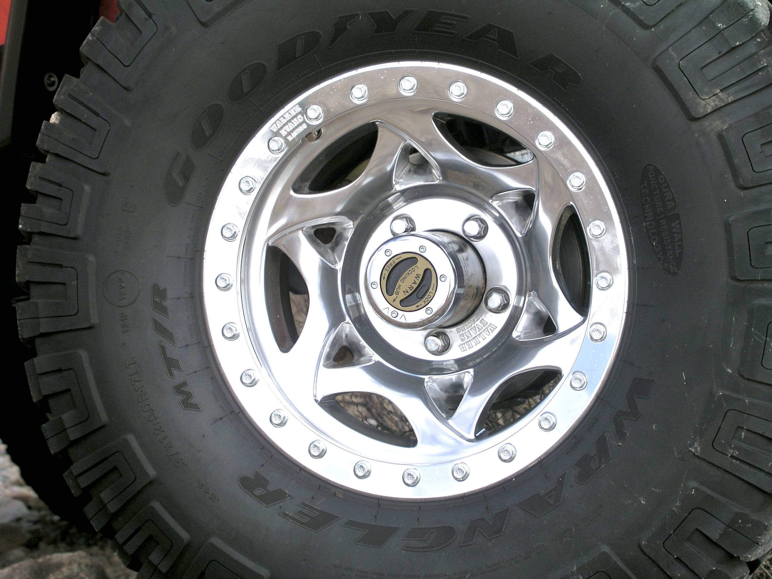

I run my Beadlocks at 3-5 psi and have never lost a bead...
Jeep Wrangler JL Method 'Bead Grip' Wheels vs. Non 'Bead Grip'? P9050020.JPG
