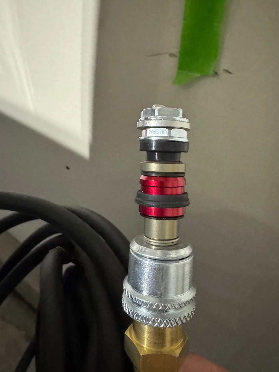

I had the Haltec chucks on my 2 hose system. The Haltecs wouldn't go down on the Apex RPVs enough to depress the Schrader, due to the step on the RPVs. I had to machine the ends of the Haltecs back to allow them to go further down on the RPV. I recall reading somewhere that the Scrader valve needs to be depressed fully or it limits the air flow. That would slow your air up time. Check for that.
I went out and test fit the connection. It locked into place snug but will see when it’s on the wheel.
My problem with my Haltech chucks was that the face of ghe air chuck contacted the she step on the RPV bu didn't push the schrader down much at all.
