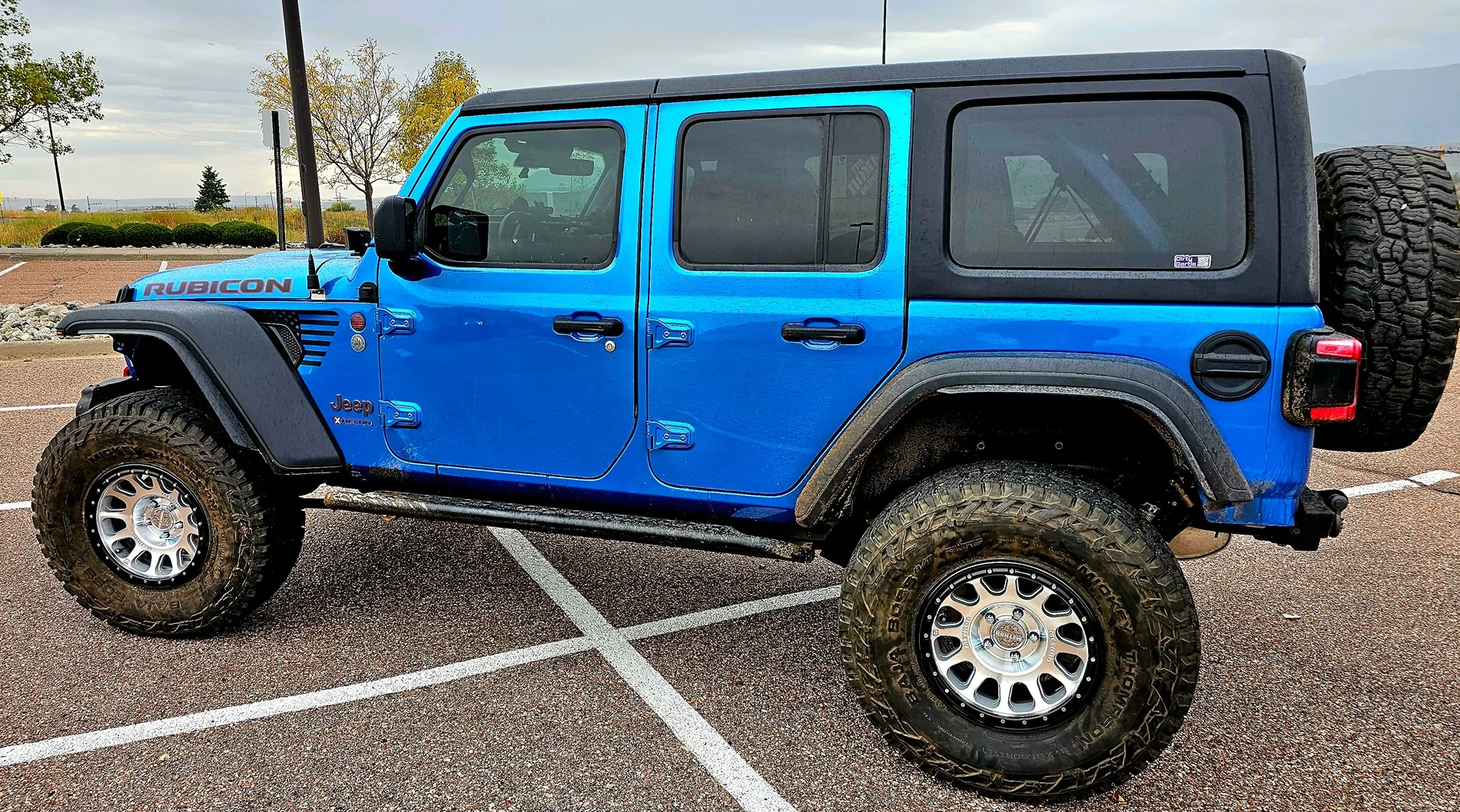

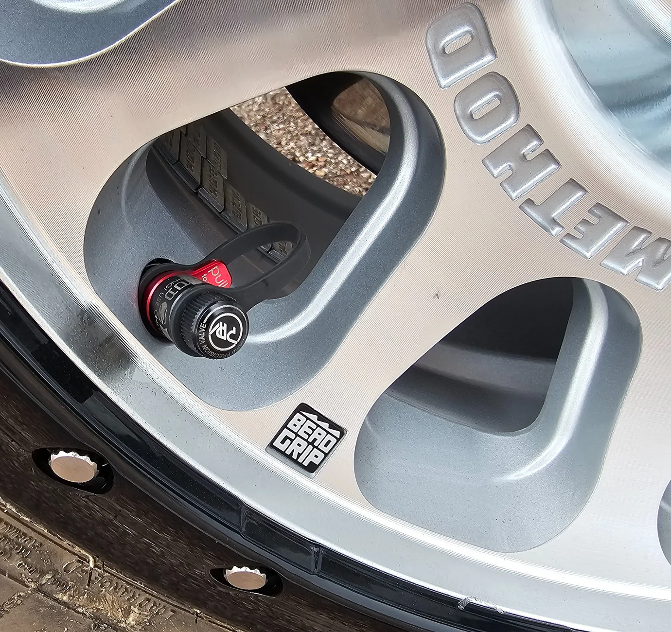

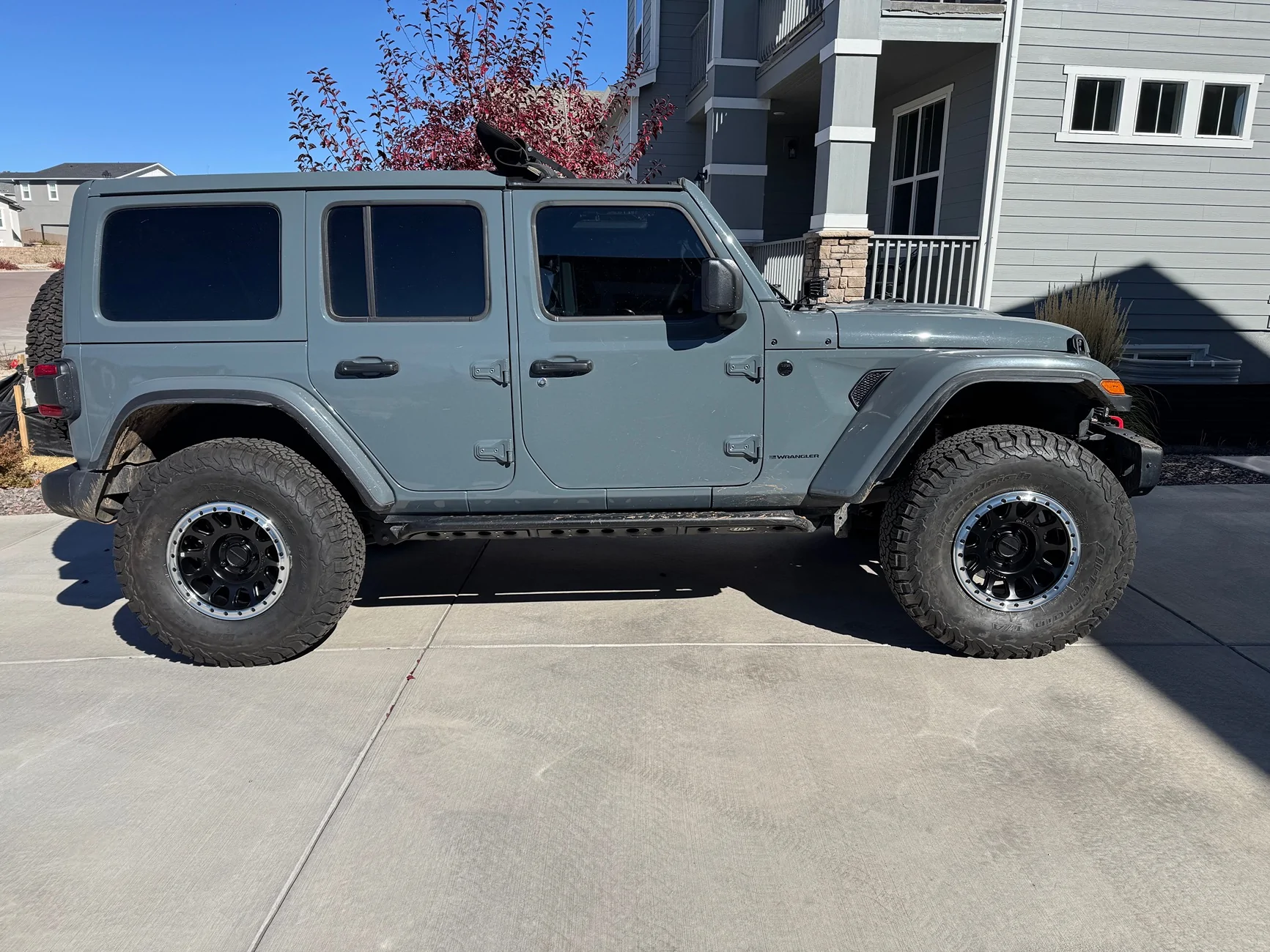

Ok, my report on the Method 709-hd wheel with Apex valves -
I have been debating locks or grips for my Jeep for some time now. I have an XR and there are a couple aftermarket choices for beadlock rings other than the Mopar rings. In the end, I decided I didn't want the extra work of the lock rings plus, knowing my luck, if I were to be in an accident on the road, my luck is an insurance attorney WOULD home in on the non DOT legal rings and nail me, whether the accident was my fault or not.
I saw the 709HD was available with impact rings for a reasonable price through Discount Tire here in Colorado Springs so I jumped on a set. I called both Apex and Method to try to get dimensions on the valve pocket of the wheel to see if and what size of Valve would work. No dice on info. Apex didn't know for sure because of the new wheel and the guy at Method I talked to couldn't find the pocket dimension.
So, I eyeballed all the pics available on the web of the new wheel and decided to gamble and order a set of the XL valves.
XL valves work perfect with the 709HD wheel.
I didn't get my tape measure out, but eyeballing it, I'd guess the end of the Apex valve cap is about 3/4 to 1 inch inside of the wheel IF you are also using the optional impact rings by Method. The release tab for the valves is pretty close to the wheel, but there's still plenty of room to get a quick grip of it with my big fat fingers.
If you don't get the impact rings with the wheels, the valve caps would be pretty much flush with the side of the wheel.
I had Rock rash on my standard XR wheels and had thought about the beadgrips in the past, but not having some type of replaceable ring kept me from buying at the time.
As far as weight, I didn't have a scale to accurately compare them, but just by picking them up, it felt like the Method, with impact ring, might
Jeep Wrangler JL Bead grip vs. Beadlock wheels 1000034621
Jeep Wrangler JL Bead grip vs. Beadlock wheels 1000034618
be a few pounds lighter than the factory XR wheel.
I've only ran 1 rocky trail with the wheels since getting them so far, aired down to 10 lbs, and no issues.
In short - get the impact rings and the XL Apex valves. 👌

@Chip has the only ones with a ring and even researched valves for you. Nice setup Tom!

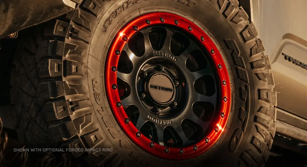

There are some cool wheels for sure. I like the 709 and add the Impact rings.
Jeep Wrangler JL Bead grip vs. Beadlock wheels 1761394407746-nz
I priced them out with the impact rings. $2480.40 and then add another 150 for the Apex Design valve stems and a set of TPMS, and I am north of $2,700 for wheels. Yikes. But it is the cost of wheeling. Better so spend the money at home on the Jeep than a potential expensive recovery.

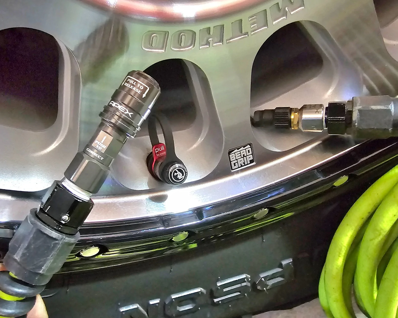

Addendum to my report above -
Someone else had mentioned that the Haltec clamping air chucks would not work with the Apex valves and that was my experience also.
Instead of having the face of the Haltecs machined down to work with the Apex valves, I splurged for a set of 4 of the Apex chucks for my quad tire inflation system. I also carry a single air line and ordered one of Apex's high flow screw on chucks just to try it.
I didn't time it to see how much quicker the high flow valve is compared to other clamp on valves, but it seemed it was maybe a tad quicker. However, you also have the extra time involved screwing on and screwing off the chuck.
Apex's push on chucks are the bees knees! They clamp in two places on opposing sides of the valve stem and work perfect with either the Apex valves or standard Schrader valves. And, they are so much smoother and quicker to attach to the stem than my Haltecs were! I tried putting a little grease on the Haltec retaining "clips / arms" that the collars slid over, but they always were very stiff to operate. Not so with the Apex chucks - these things are smooth and quick!

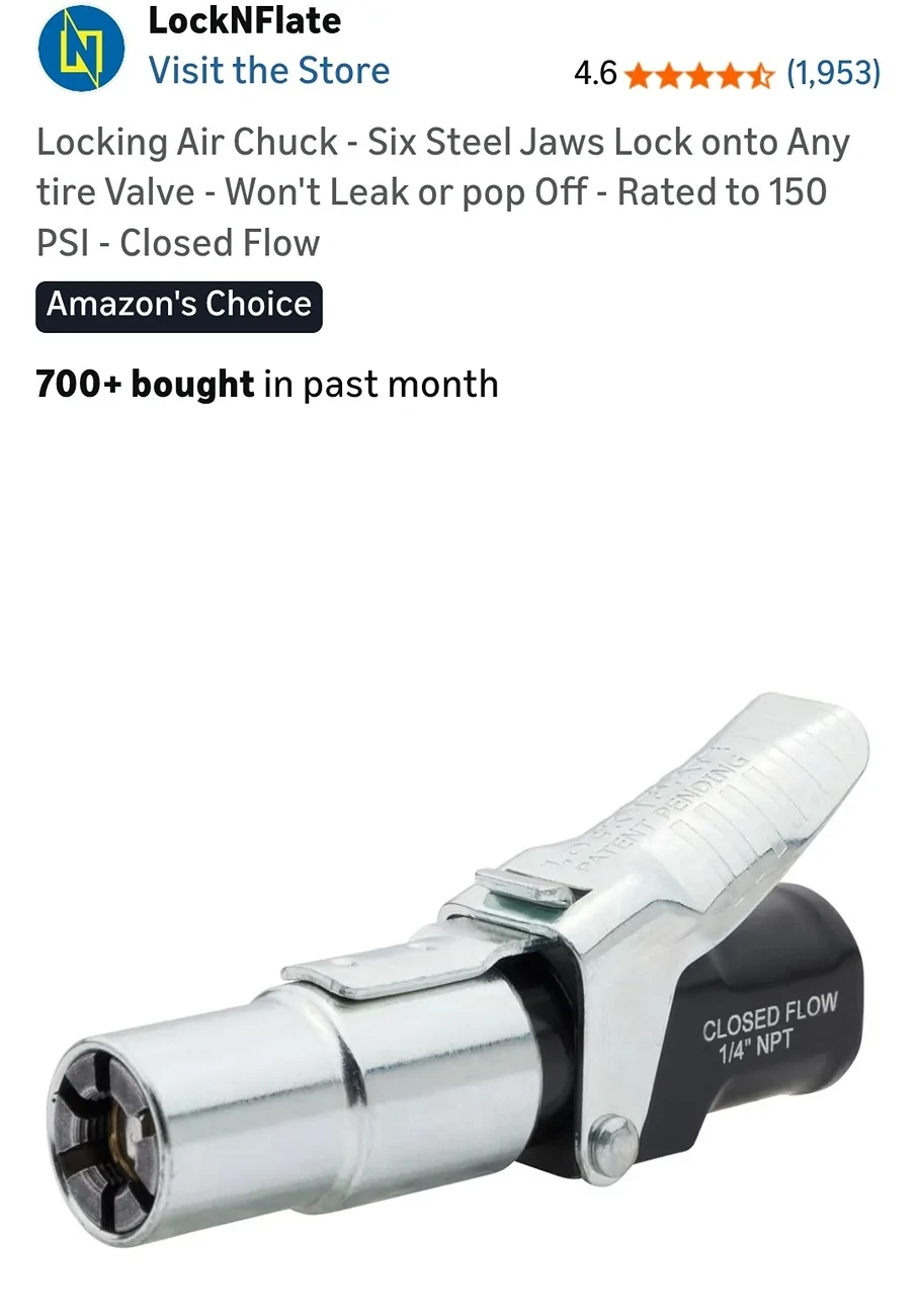

Not sure if these would work on the Apex valves...
https://a.co/d/9zfTreI
Jeep Wrangler JL Bead grip vs. Beadlock wheels Screenshot_20251025_120938_Amazon Shopping
They come in closed flow, open flow, straight or 90degree.

Good feedback on the push-on Apex chucks. I only machined the Haltecs out of convenience. It worked for me as I was able to measure how much it took to fully depress the Apex schrader valves and machine the Haltecs to do that. It definitely matters that the scrader valves are fully depressed with regard to air-up time.

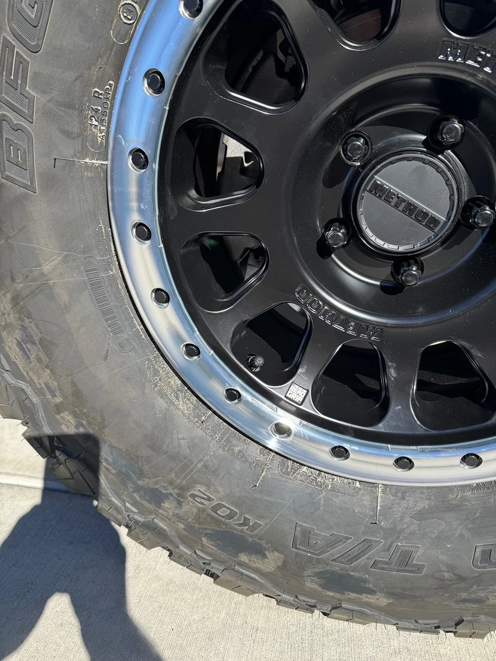

Hey I just got the 709s mounted up at discount in CS.
Can confirm too the Apex XL are needed for the 709s, I had to sell my standard, but I was planning to get different wheels.
I thought about doing the whole apex setup but man it gets pricy and what I have works. You can see the stem is protected. Overall like the look and the impact rings are pretty sweet.
