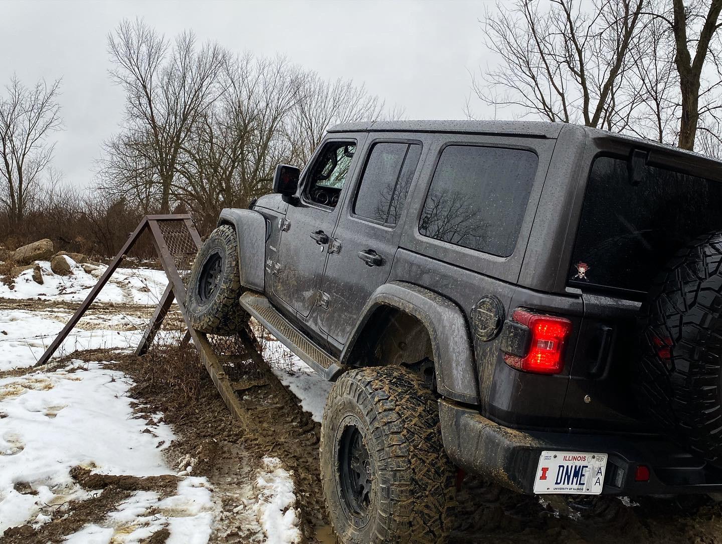

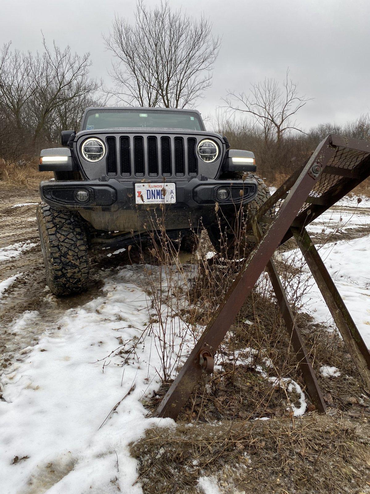

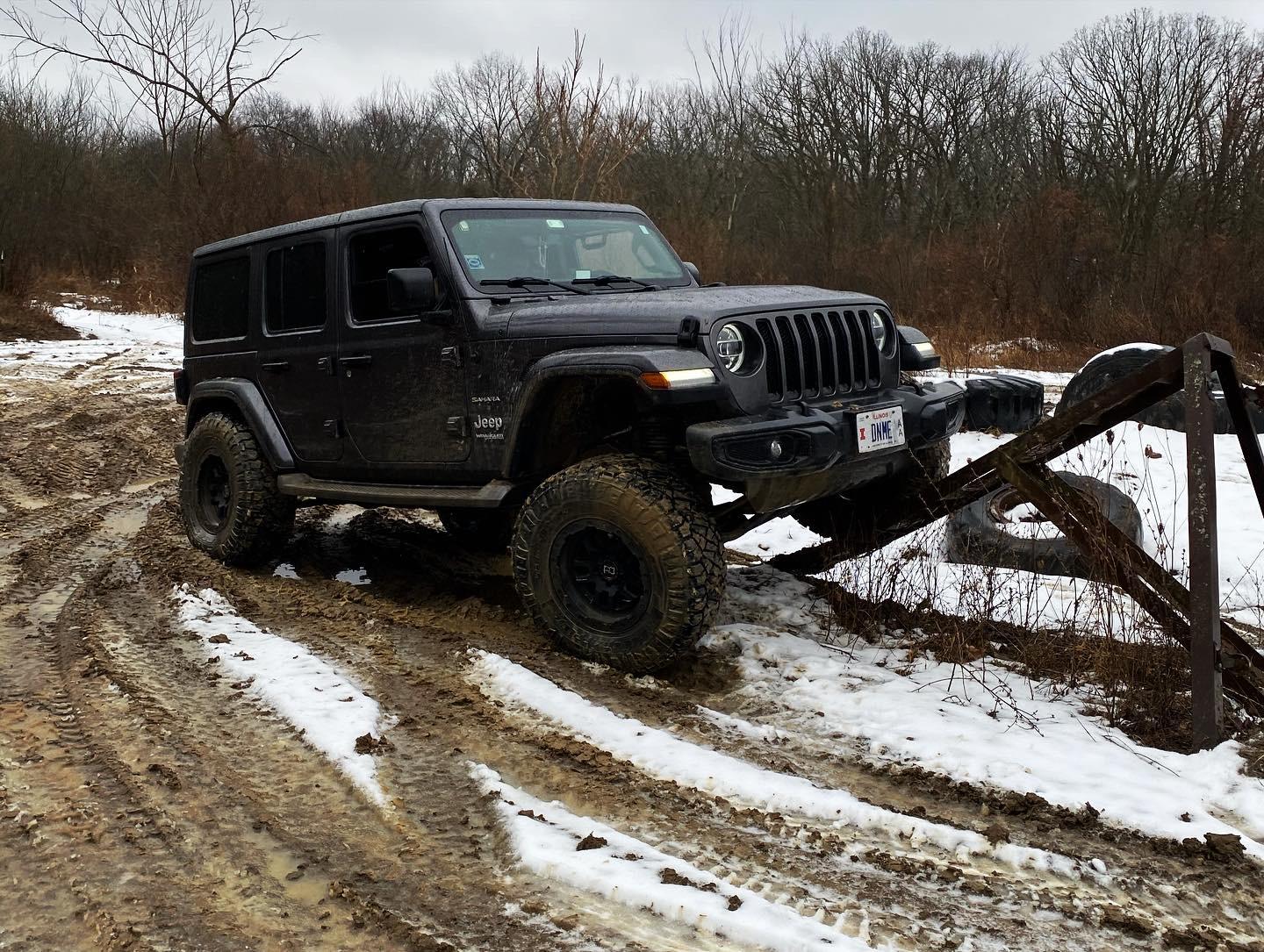

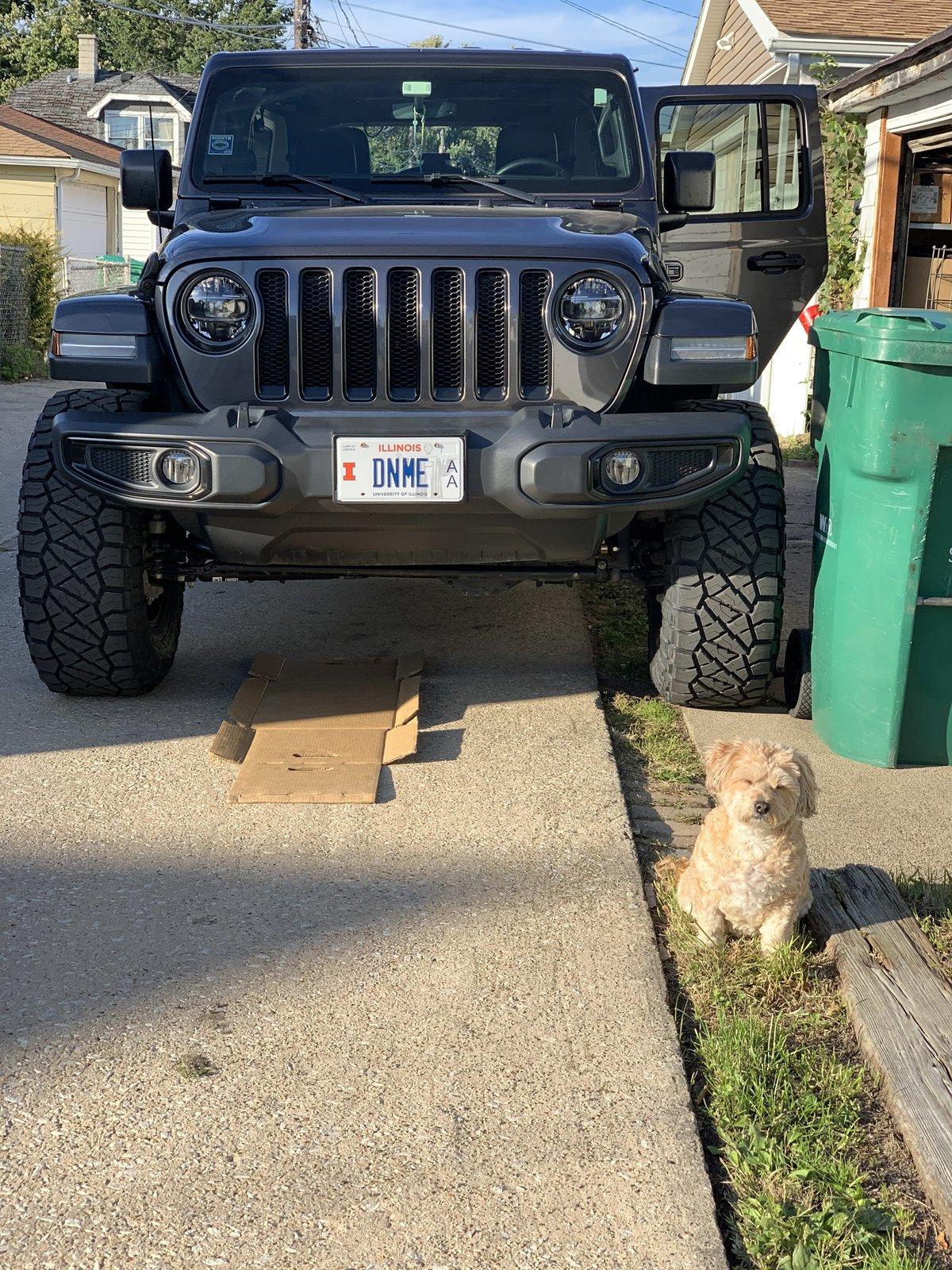

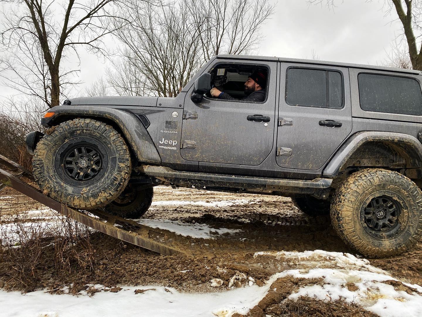

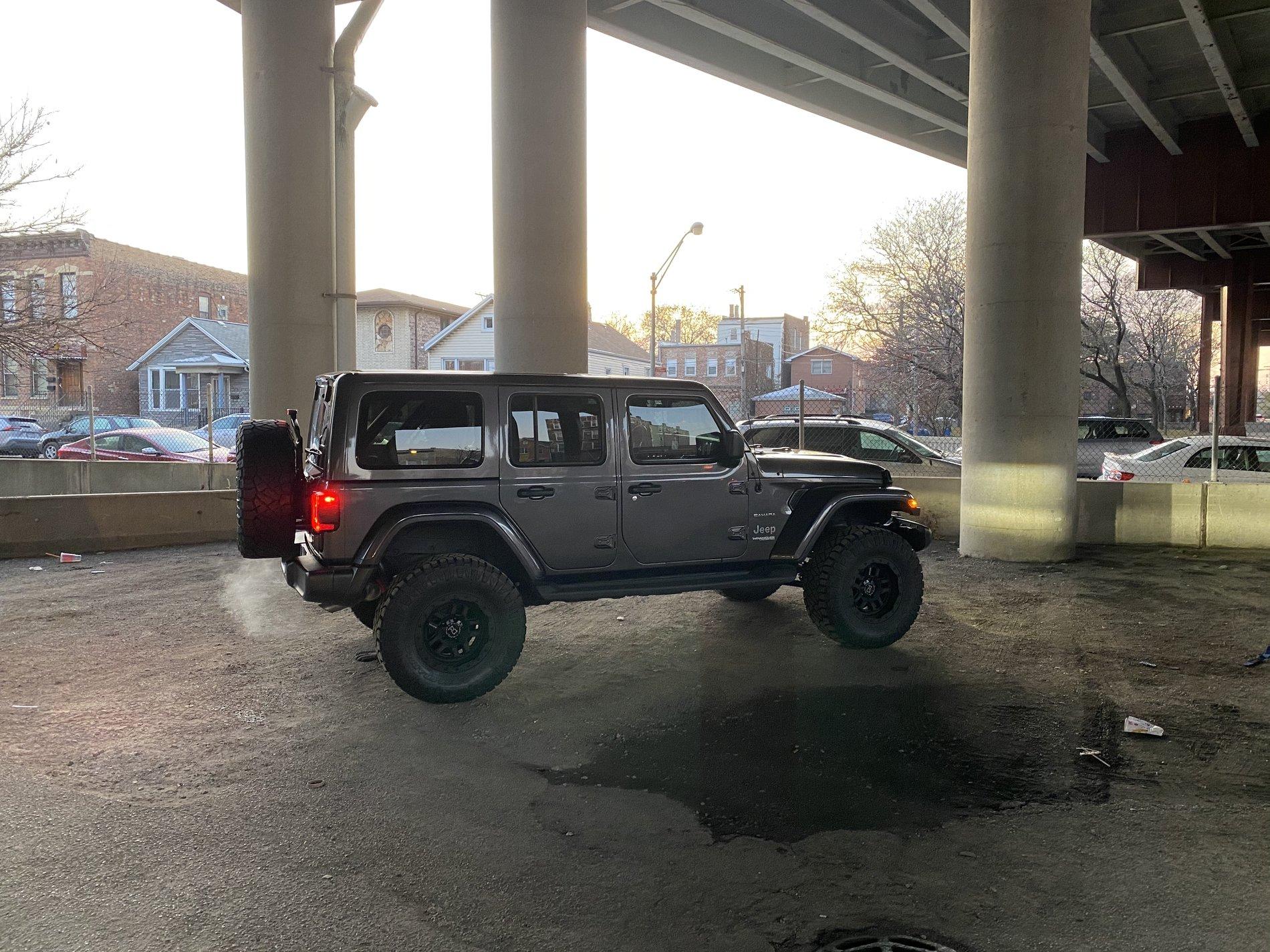

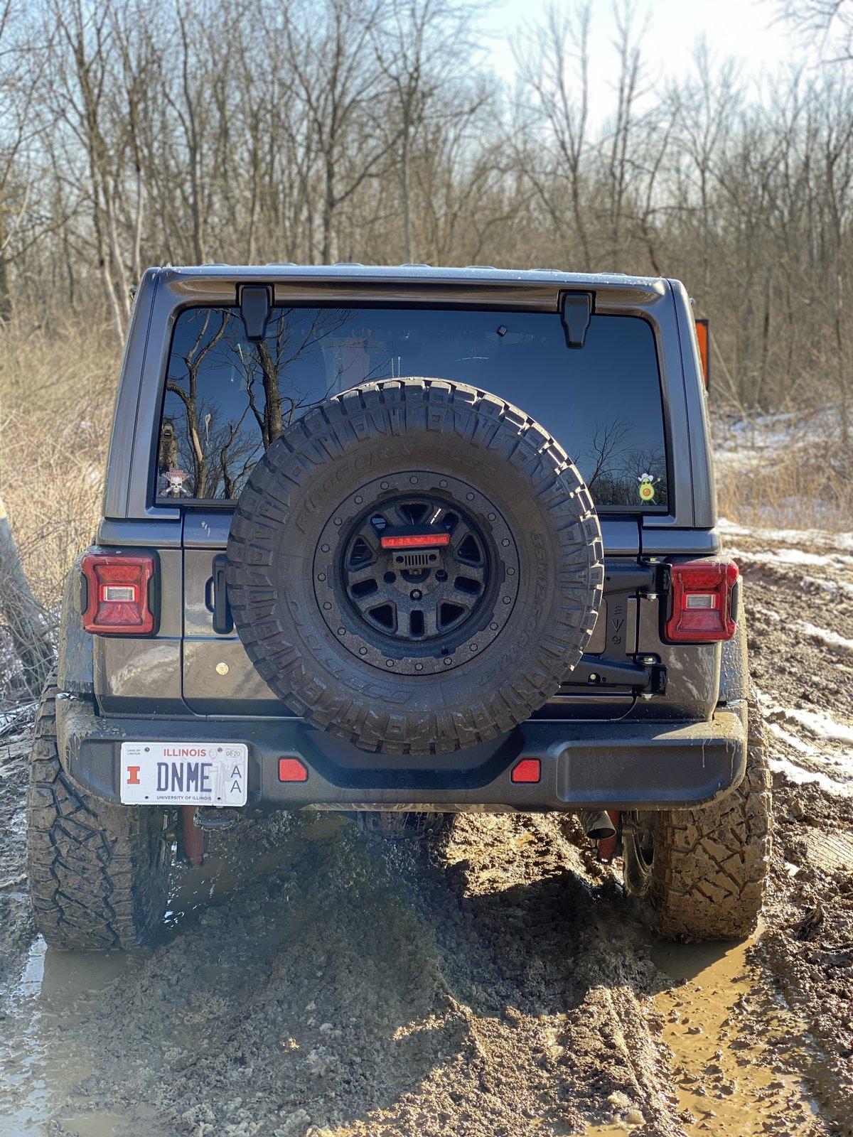

I have the 2.5” MC Rocksport edition, so not the game changer yet but will be getting the control arms later this year, hopefully. So far no rubbing when I go off-roading and I believe mine have a lot of offset. Never figured the exact numbers since the shop ordered them and installed them but they said I would be fine. Here are some pics. I have the Ridge Grapplers and love them.

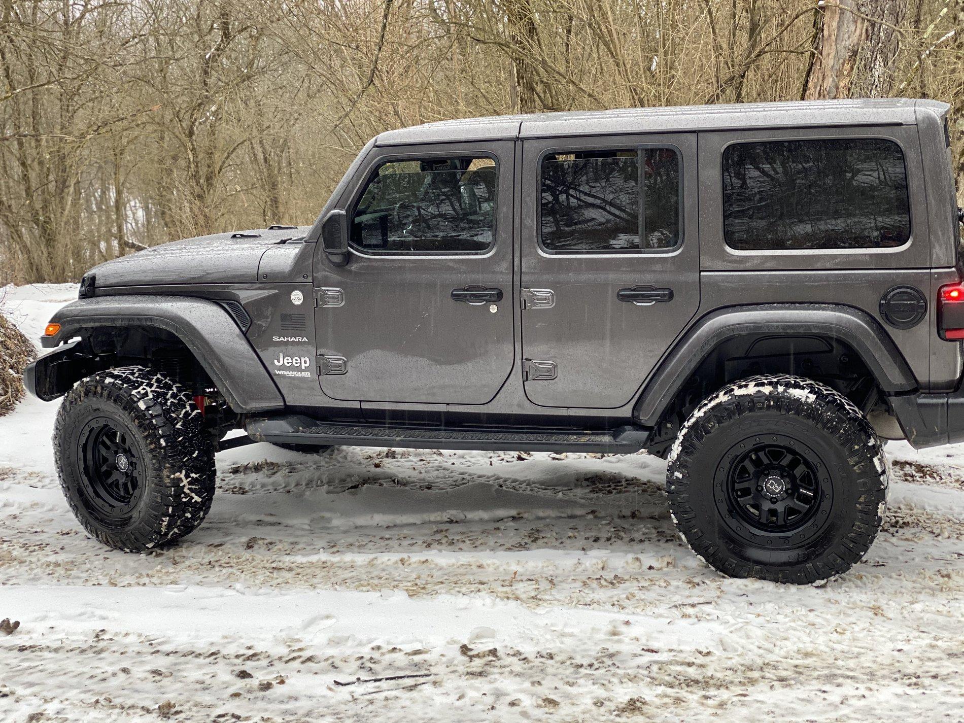

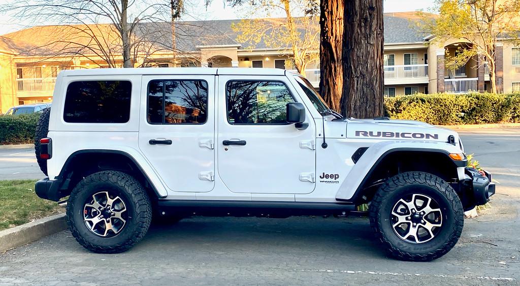

@ChattVol since you asked... here is her Jeep:
Good looking jeep. How do you guys plan to use the jeep? If you want to wheel it on tougher trails and have full travel with the Rocksports without rubbing the frame, I would listen to Metalcloak and buy wheels with 4.5 backspacing or less and get their outboard shock mounts as well as a aftermarket front driveshaft.
I've wheeled twice with my friend in a 2 door rubi on 35s with 17x9/4.75 backspacing wheels with full gamechanger lift, Rocksport shocks, 8 control arms and Metalcloak recommended front driveshaft. The paint is rubbed off the frame side of his front passenger Rocksport shock where it rubs the frame bc he's not using the outboard shock mounts. You can also hear the shocks rubbing the frame near full droop. It still flexes incredibly well...would look better on 37s.:rock: I imagine the vast majority of jeep owners won't flex their jeep enough to notice these shocks rubbing the frame. In terms of aesthetics with this 2.5" lift on a JL rubi 4 door, it looks more proportionate on 37s IMHO. Is she set on running 35s? If not, I'd definitely go 37s bc this lift lifts closer to 3" and they look awesome with it.:like:

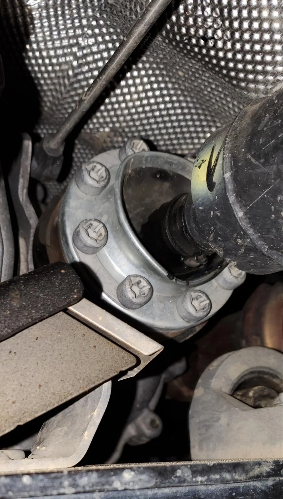

Yep...I think 28" extended is about the limit if you want to keep the stock driveshaft. At 28.5" extended in front and 31.5" in rear, my stock driveshaft is bending the flange at the transfer case and starting to leak a bit. I've flexed it a good bit over the last year.
wow, is the the front or the rear? if rear I would be afraid of it eventually letting lose on the highway.
