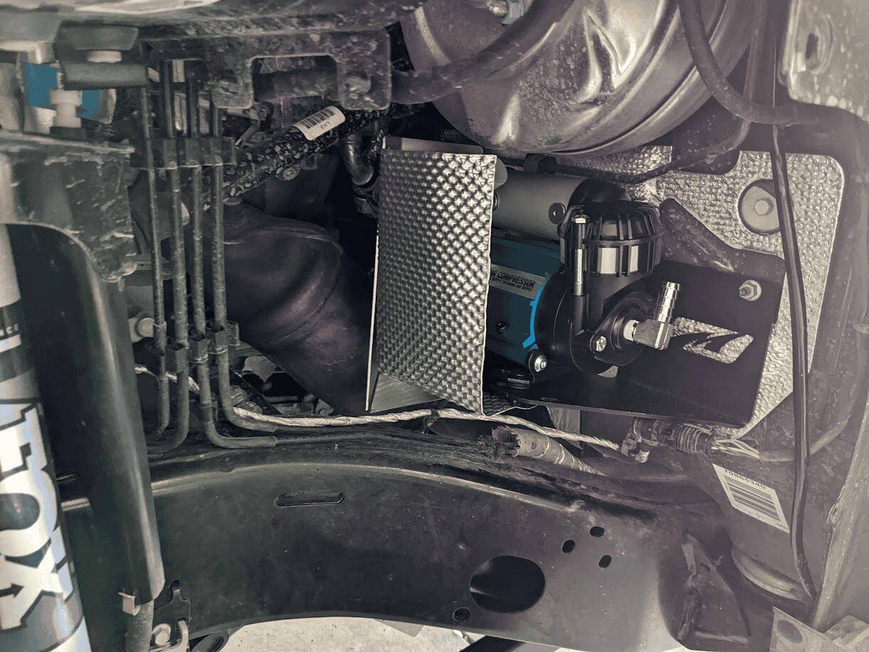

When you folks are replacing your clutches and masters, I hope you are paying close attention to eliminate heat build up in the hydraulic system.
Utilize your favorite heat wrap, such as DEI or Thermo-Tech on the master to slave hydraulic line. Also, utilize a quality brake fluid such as Pentosin.
Jeep thought is was a great idea to place a catalytic converter right below the brake / clutch systems; without additional protections. I also utilized a Grimm Offroad Compressor bracket to install additional heat shielding.
Helped me...... Still have the latest Centerforce Clutch system in a box. It's been 4 years now on original OEM clutch....No software.
and yes I'm on 40's and 5.38 gears

Care to share some photos of what you did? I have a stock clutch (2022), no intent to replace it until it wears out, wondering if I should take any similar precautions now. I do notice when my Jeep is thoroughly heat soaked I occasionally get a rattle when passing through 3k RPMs.
Hmm, I wonder if mine might have something to do with my lack of issues. Not totally covering it up but it is blocking a lot of the space below it.
Hmm maybe I should buy some sheeting and put it over the line maybe? Or mount in between... just to see if it does anything.
Today I only had 1 instance where it was a little stubborn to get into 1st. I think the clunk sound I developed is related to the control arms I just greased and not related to the clutch at all. I'm not sure what I did by greasing them and when I try to move the arm around it has no play so not sure what I f'd up.
My trackbar used to do that on trails. I could never get anything to move upfront, and torqued everything to spec, but every time I went on trails I would get a "clunk". I used a gopro to help me figure it out and I tightened my upper trackbar and it is finally gone after several attempts at finding it.
