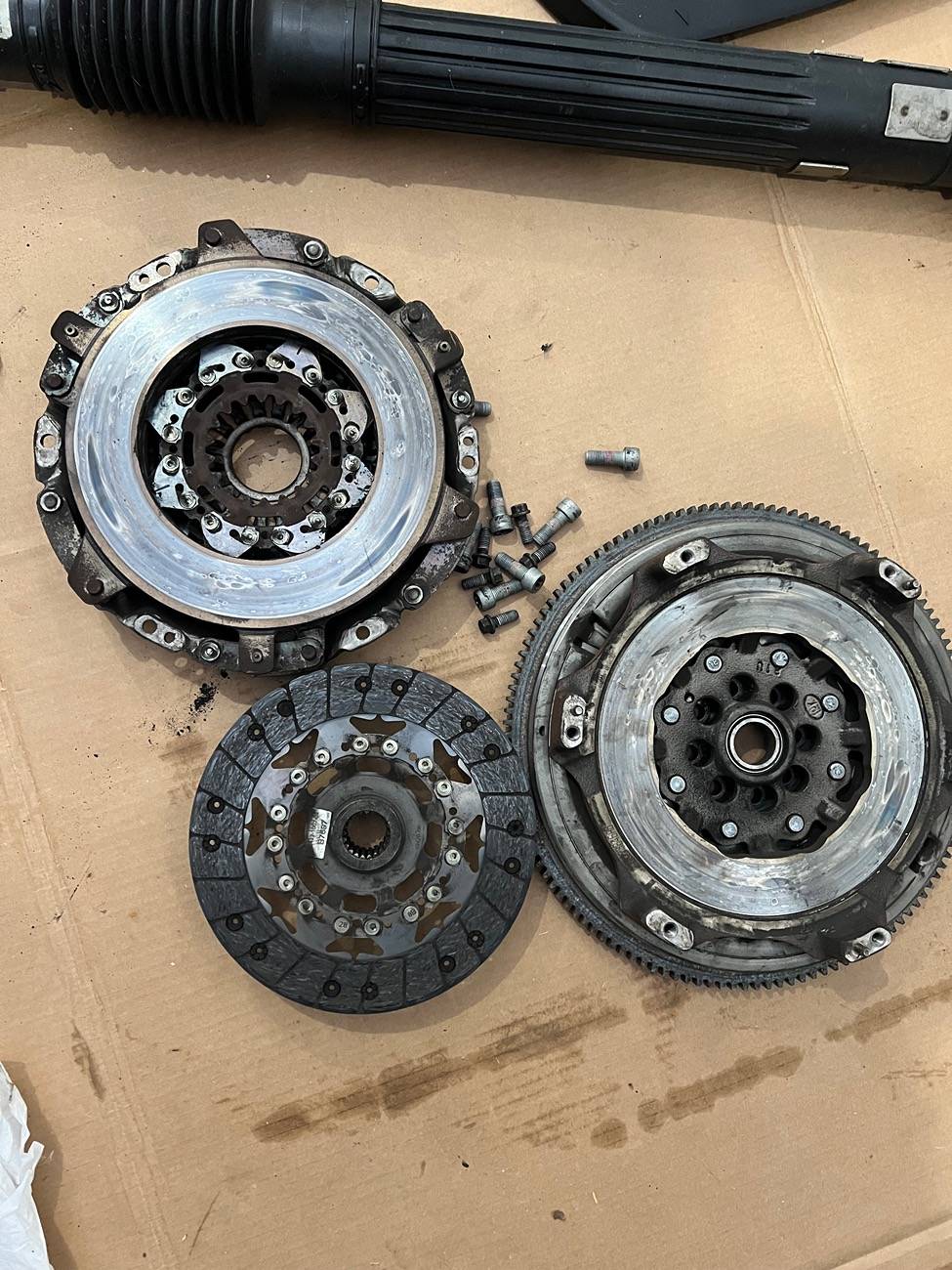

I don't recall mine having any grease like that on it. It kind of looks like they greased it and put that back together, but no idea why they would do that.
Oh interesting. I have no idea what that shop did. They also forgot to put some bracket bolts back onto the bell housing when the re-installed everything.
@Jeremynolan94 do you still have your stock clutch? Curious if yours looks the same.

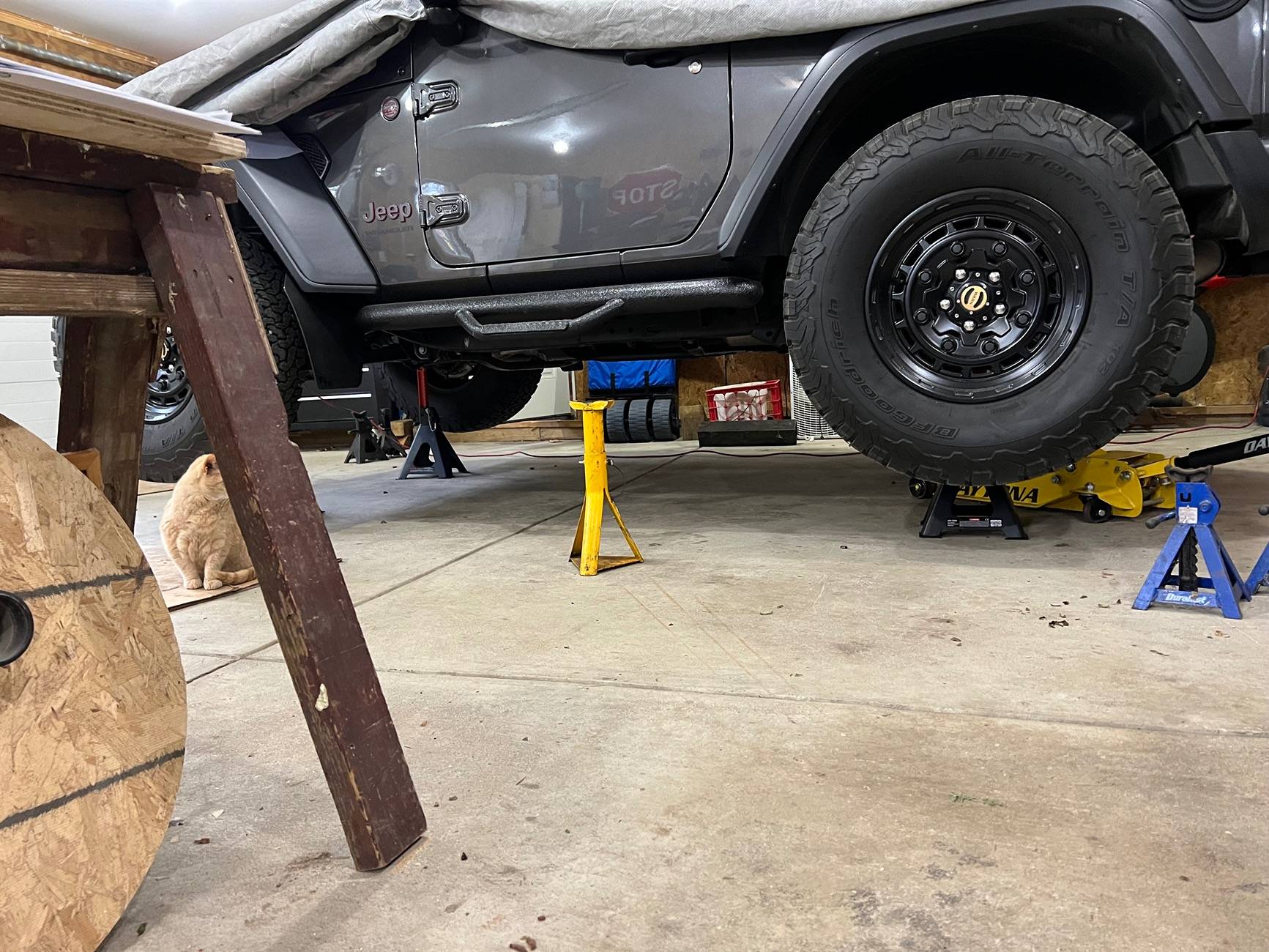

Damn I wish I was that smart. I have nothing nice to say about that bracket. I’d cut the stud and the bracket lol( yes I realize pointless to do both) here’s the only picture I took of the project. Obviously before any work started since you could see the concrete still haha.

I ended up buying 12 ton jackstands, a bigger trans jack, and a 42" 3/8" drive extention after the job, lmao
So when I drop it again this go around, It'll be much easier.
I kept the transfer case on the trans, which combined with the height was sketchy on my tiny trans jack. Outright dangerous actually, but don't let my wife find that out! Lmfao

I couldn’t remember so I had to go back and look. Mine was as rather dry when I took it apart. Around 31k at that point I believe.
I still have mine on the shelf, I'll take a look at the lube as well.

Hmm ok so then @gek is right that they added lube to put it back together and it is clearly the same color as what they used on my ACT. I'm torn between just letting this all go or calling the shop to at least tell them if they ever get another person in there who wants the ACT installed for the love of god use the right grease.

I left my transfer case and cables all attached. I had a steel plate I drilled a hole in the middle and bolted it on that Daytona superduty jack and used that. I highly don’t recommend this. It did the job without any issues , but me trying to save a few bucks will cause me to do some dumb things. I’ll be buying a transmission jack if I ever have to take a transmission out of anything again. My wife saw it and some point and was mad I wouldn’t spend the money on one lol.
