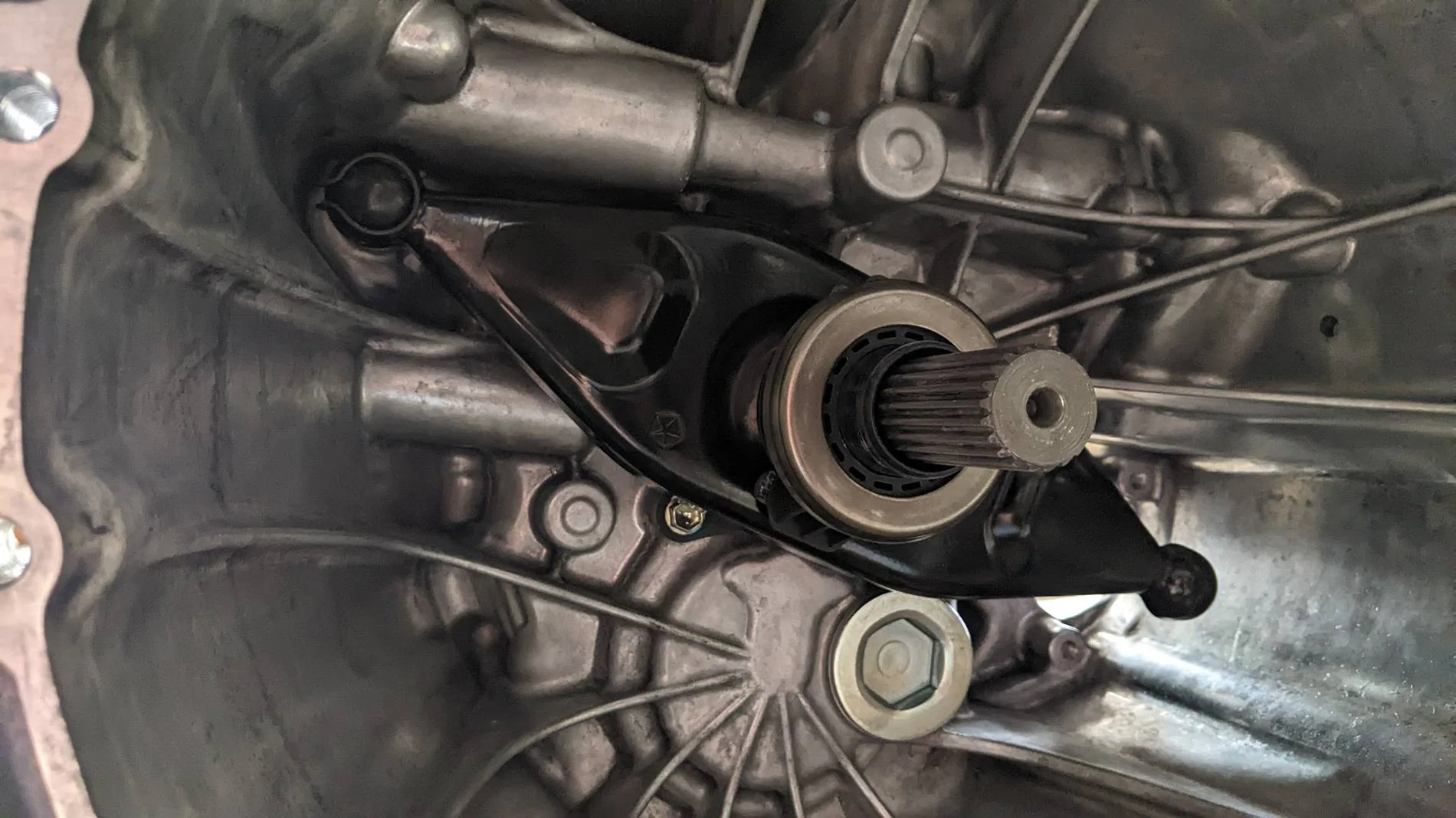

Thanks for posting this. I have about 16k miles on my ACT. 71k miles on the JL. I’ve experienced the creep twice and it’s no fun. My symptoms are a hit/miss but notice that they seem to happen when the tranny’s warm from extended use (daily driving). The clutch pedal gets softer and the clutch doesn’t engage very well. IMO it’s heat related. Maybe it’s a temperature/software thing since the CPU warns of tranny temps? Ever try measure the tranny temp/fluid to see if it happens then?
Sounds like you're going to have to open it up and see what is going on in there. That's a bummer but may be your only way of getting answers. I have about 3500 miles since the right grease was applied and mine is still shifting normally. I'd be curious if maybe there is rust in the hub on the disc. Whatever it is something seems to be preventing the disc from sliding properly. Please keep us posted what you discover.
Any idea how much of the purple grease they used? I'm experiencing this issue and used the purple grease, but only a very light coating you can see in the picture below:
I believe they used all the grease that was in the tiny packet.
I followed what they did in the video, but I coated the shaft with a thin layer before putting the lever and bearing on.

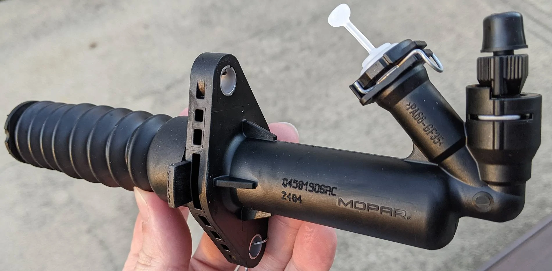

I didn't see it in this thread but has anyone tried to track the iterations of clutch slave cylinder revisions?
The newest revision of slave cylinder seems to be "04581906AC"
The part number is etched into the driver side of the slave cylinder and visible from under the Jeep with some careful phone camera placement around the exhaust/front driveshaft.
My '21, manufactured on 07/2021, still has the OEM equipped slave cylinder with part number "04581906AB" .
After my ACT installation, the shifting issue is ever-so-slightly getting worse and worse. I only used the purple grease supplied in the ACT kit on the input shaft and my clutch hydraulics do not appear to be leaking anywhere. I have not tried a re-bleed yet, mostly for fear of making things worse.
Can we try to figure out when the OEM slave cylinder update occurred and if the shifting issues are limited to one OEM part number?
- What month/year was your JL manufactured (find on driver's door on long silver sticker w/ VIN)?
- If you can confidently say what part number slave cylinder your JL was originally equipped with, what is/was the part number?
- Do you have a new clutch, if so what brand/part #?
- Was your original OEM slave cylinder kept with the new clutch, or replaced with a new OEM slave cylinder during clutch replacement?
- Has the clutch hydraulic system been broken open (for bleeding, line/part replacement, leaks, etc)?
- If the clutch hydraulic system has been broken open, are you confident it has been properly bled and returned to factory spec?
- Do you currently have any of the previously described shifting issues?
- If "YES", to what degree ("noticable", "aggravated", "undriveable") of shifting issues are you experiencing based on what others have described?
2021 Original OEM Post-ACT Slave Cylinder "04581906AB"
Jeep Wrangler JL Manual Transmission - Issues shifting into 1st & Reverse (Compilation thread) 2025-03-17-OEMclutchSlaveCylinder
Current OEM Slave Cylinder "04581906AC"
