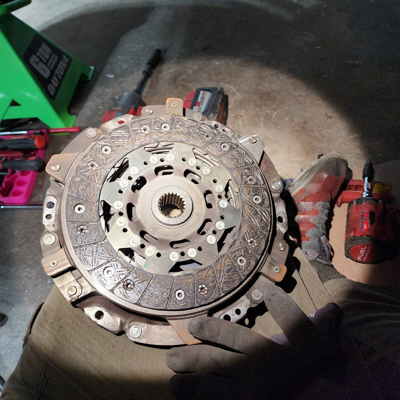

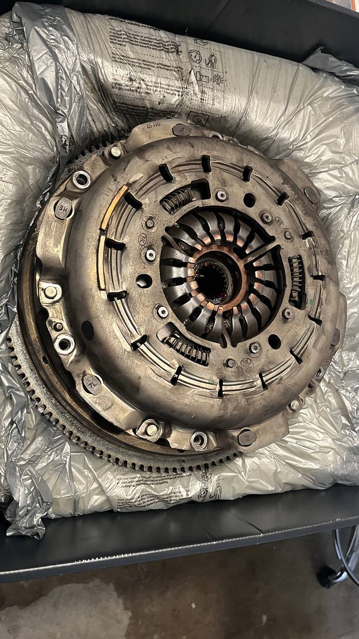

Here was my stock clutch after 85k miles. Now that I'm really looking at these photos you can clearly see the same red wheel bearing grease on the splines. I bet what happened is the shop saw that and assumed they'd put the same grease back onto the new clutch.
Or never cleaned it off or put new back on?
I don't recall mine having any grease like that on it. It kind of looks like they greased it and put that back together, but no idea why they would do that.
