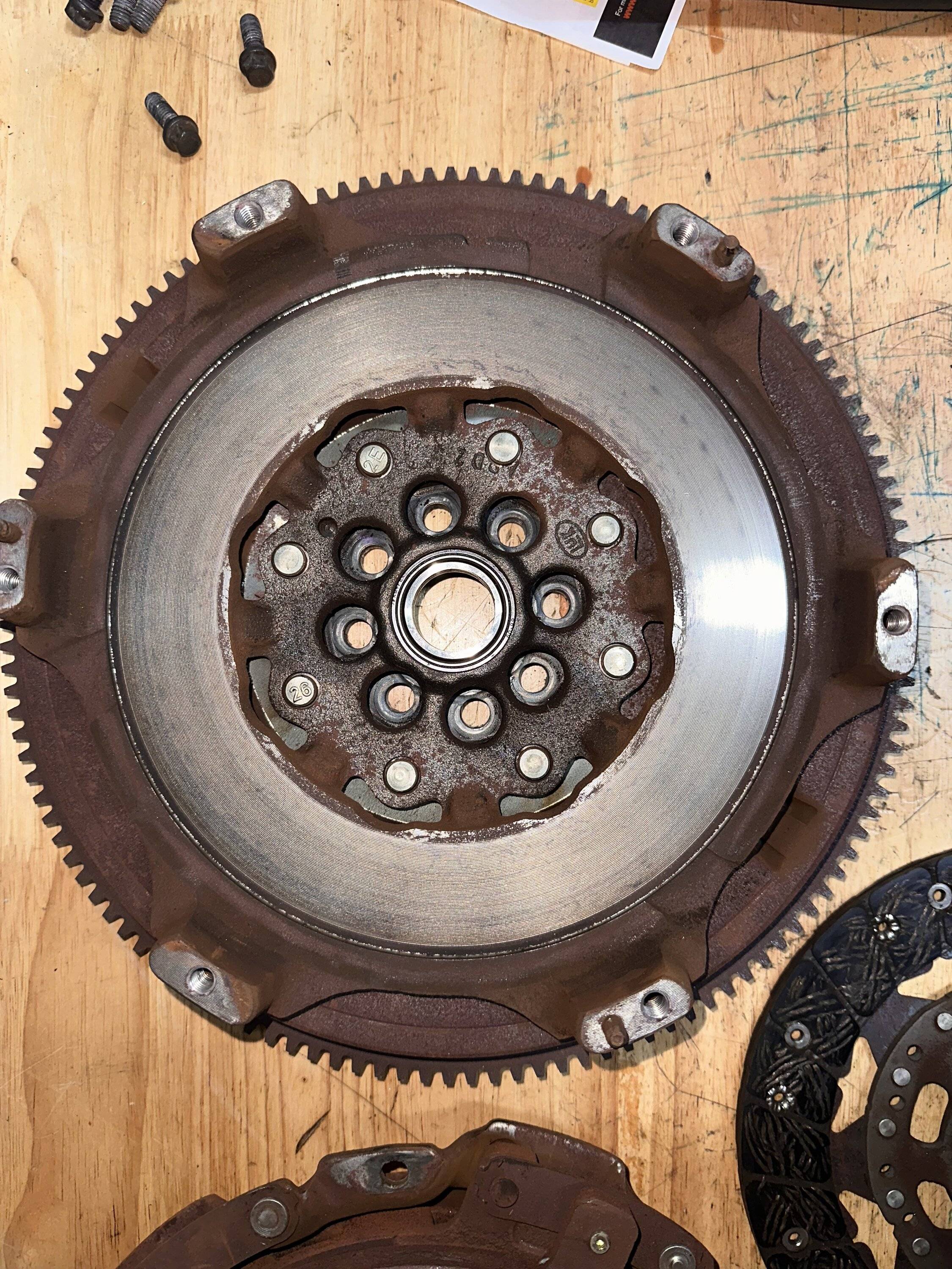

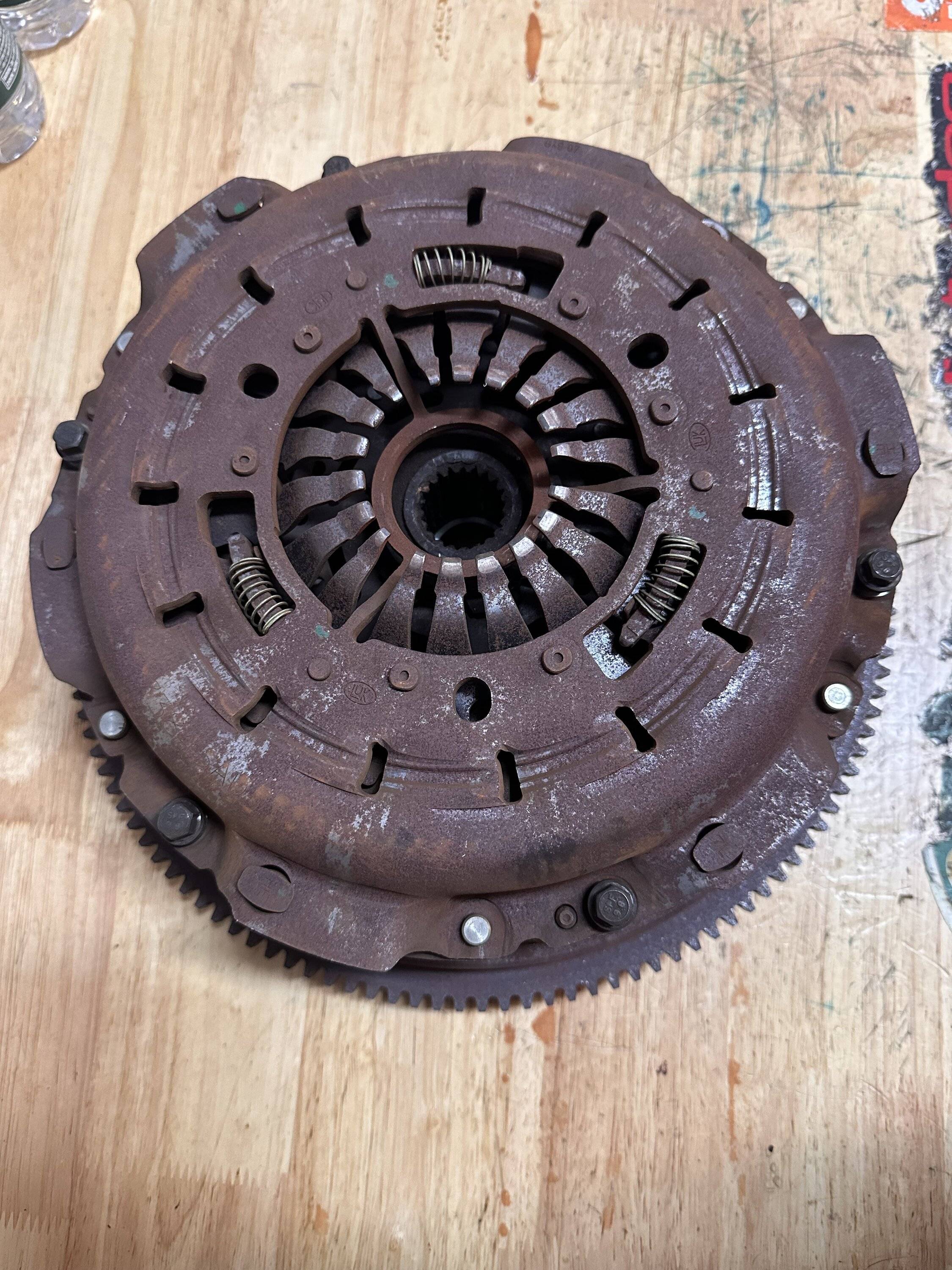

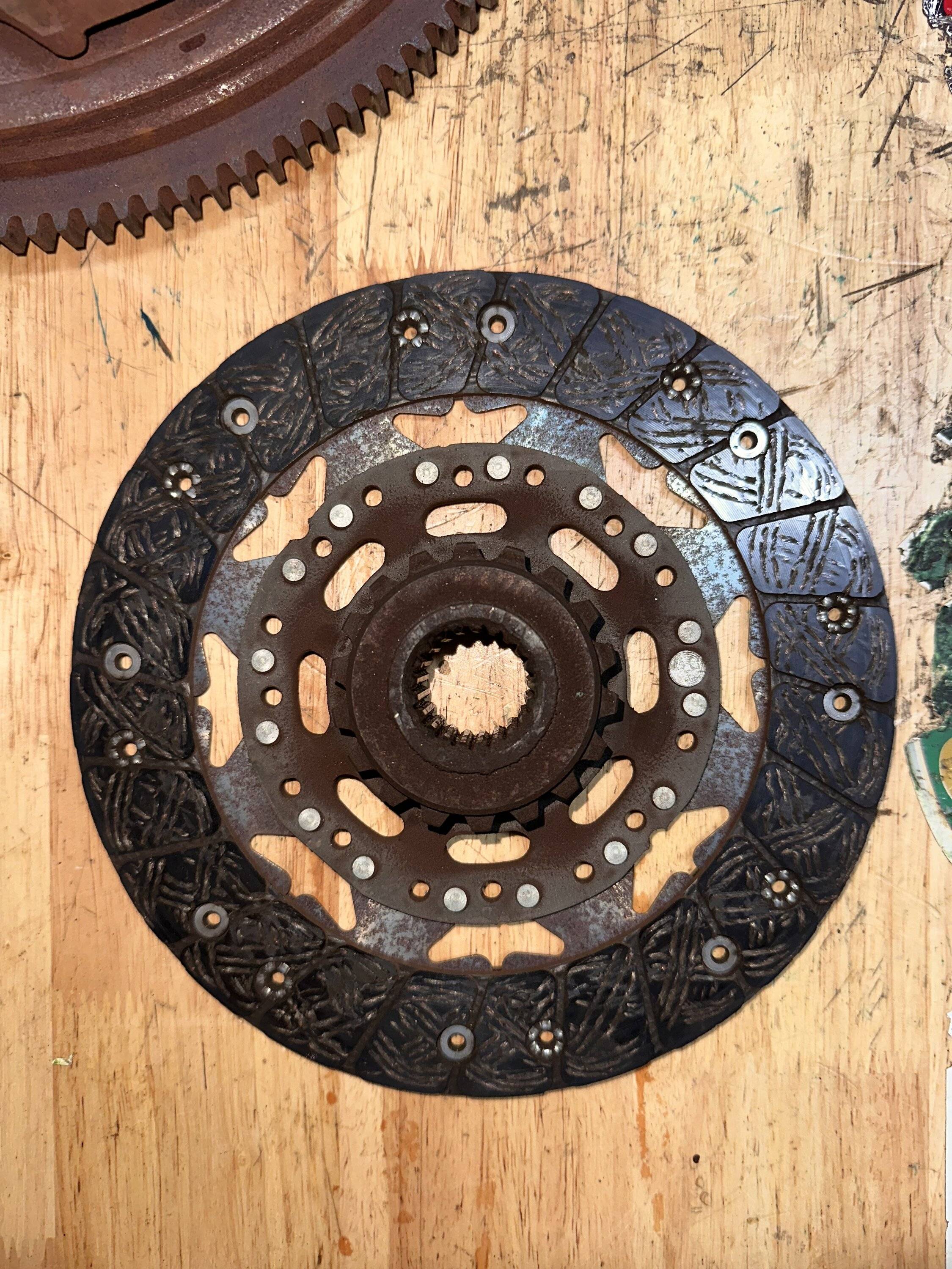

I know mine has the lube provided with the kit, and also a very light coating, I believe my issue is corrosion after looking at my stock clutch and one of your pics and also the guy who replaced his, there is a fair amount of rust inside the clutch disc splines
this is my stock clutch after 16550 miles
Wow, that is a lot of rust!!!
Do you do a lot of puddles/water crossings? I deal with a lot of snow and salt, but dont have nearly that much rust.

I plead the 5th
Edit - lol jk, I don't shy away from water crossings, but I do drive on the beach every time I get during the summer, my folks live by the water and their block gets flooded from time to time so I have crossed salt water once or twice, not too deep thou
I do stay away from mud, I don't like mud, I would not want the bell housing full of mud

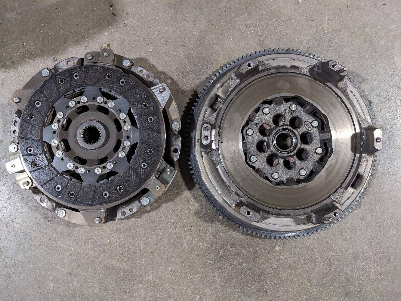

How does it look that bad at so few miles? Here is my stock one at 15625
