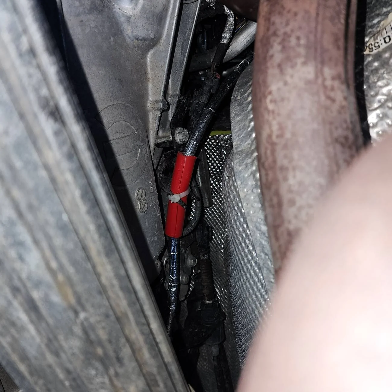

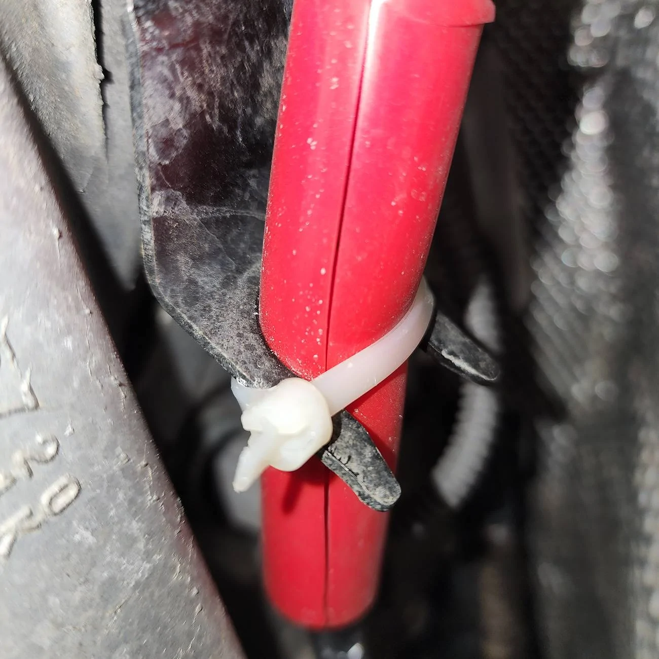

Does the CF line clip on anywhere? With the OEM it has 2 clips onto the firewall and then sits in a bracket attached to the transmission.

Just did an oil change, so I finally grabbed the clutch line pic!! Yeah, i should properly twist off that ty-wrap end, lol

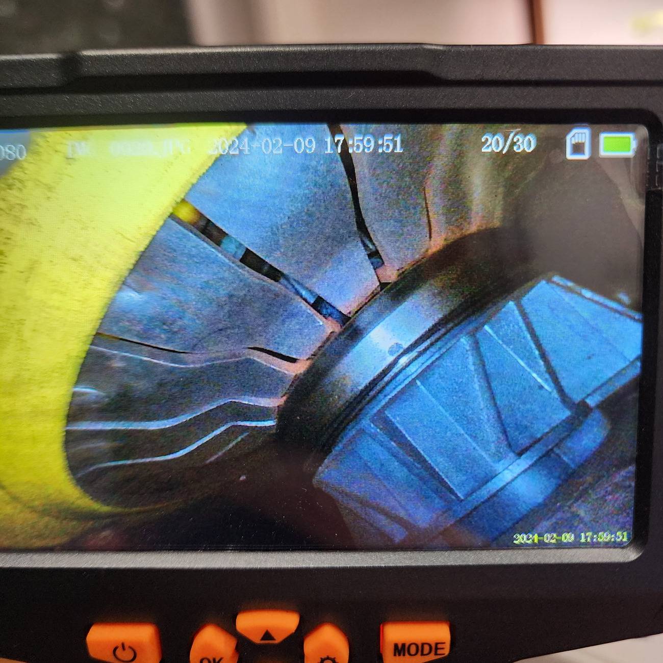

Additionally, I borescoped the top of the trans and checked the shifter cables and brackets underneath. Everything is tight, no debris, shifts perfect while not running.
Looked over hydraulics. Fluid level is the same, no leaks at master, no leaks at slave. I popped one bellhousing weephole plug, dry as a bone.

I think I may pop the slave out, manually move the clutch fork/release bearing off the pressure plate, use the borescope to aim, and blast the input shaft with some brake clean.
If I can visually see gunk on the shaft, I'll blast it. Going to comb through old borescope pics now.

Too lazy to pull them off the scope. You can see the release bearing guide tube extends into the PP, blocking any chance of me getting any kind of precision spraying. I'd have to rig a straw extention, get it between the PP fingers and blast.
Which would either make things worse, or maybe point us in a direction.
