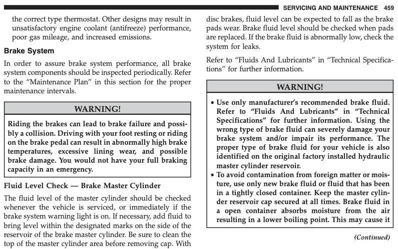

OK, just back from the new shop. They were great! The place is immaculate, they hired a few techs from my old mechanics shop, and the bill was very reasonable.
Anyway...
They called a couple hours after I dropped off and said they'd bled it and that there were bubbles. So @Actman was spot-on. Told me it felt much better, but also "The fluid is very, very dark. Like black." That explains why I was having trouble making out the level even with a powerful shop light pressed against the reservoir.
I authorized a flush and fill and I assume they had to bleed again after that. (The work order says "complete brake fluid flush and fill," but I have to assume that means the "clutch side" of the reservoir was also emptied, right? I don't see how it'd be possible to flush just the brakes side. God, what a dumb design.)
So, why was the fluid black? Proximity of hydraulic line to catalytic converter? Thinking of wrapping it to protect from heat as mentioned by others in this thread. Only 66,000 miles, albeit 7 years old. Owner's Manual makes no mention of changing brake fluid, only topping it off. See screen shots of manual, below.
Not a long drive home so I won't declare victory, yet. That said, the pedal feels great and launching is noticeably smoother/easier. No trouble getting into first at stops. I am happy to hear master nor slave have leaks. Also relieved that they have bled these before and knew just what to do.
Oh, and brakes only worn 50%! Original factory setup. Score one for engine braking!
