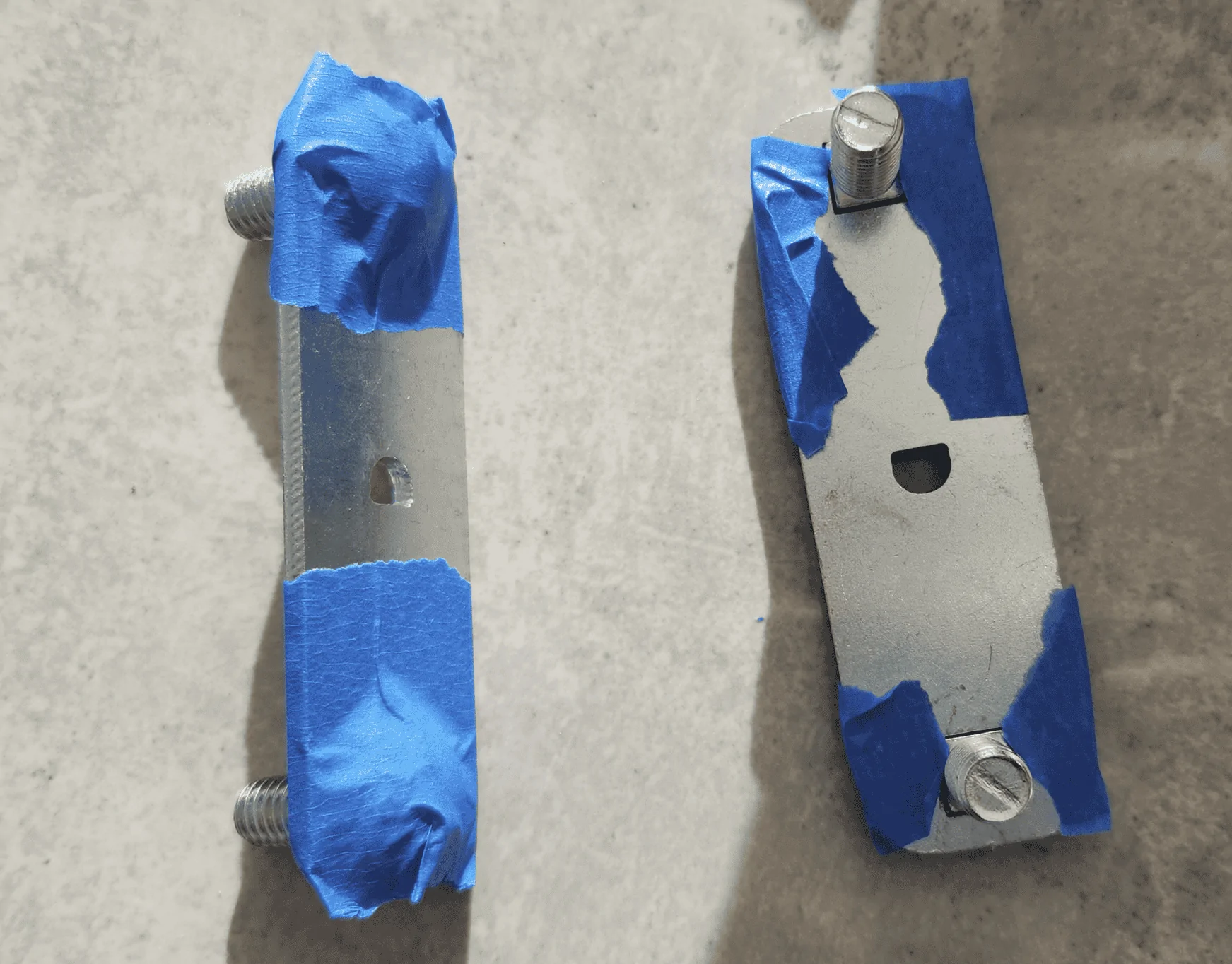

Tape the bolt and backup plate together. Try with just one carriage bolt at a time first, that way your can hold the backup plate like a short handle. Then add the second carriage bolt.

What he said. I used aluminum tape to hold the bolts into place.

  • The ONLY way for me to get the bolts to stay in place was to tape them to backing plates. Without it, you need to somehow hold both the backing plate AND the bolt together against the body of the rail (from the INSIDE of the rail), while simultaneously putting on the washer and the nut. This is ESPECIALLY fun on the upper bolts that hold the rail to the brackets, since there is very little space between the rail and the body of the Jeep. It may be possible for someone who has three very small hands, with fingers that bend sideways and backwards, while having the Jeep mounted on a rotisserie, etc. Otherwise, good luck. Of course, if you are using tape, just know that you are leaving it in there since there is no way to remove it after everything is installed - there is not enough room. I used some painter's tape...hopefully it will just "bio-degrade" after a while:

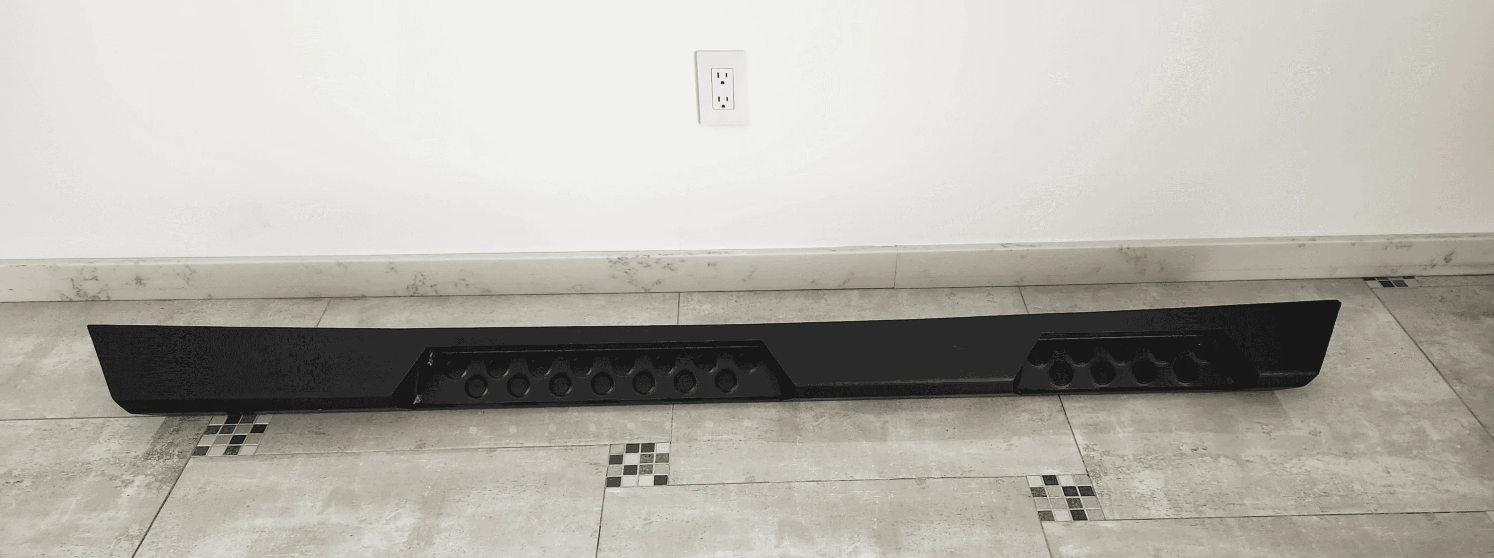

  • The rails are NOT straight. They are a bit bowed, probably because the body of the Jeep is as well. However, the curvature of the rail is steeper than the body of the Jeep, which delivers extra fun when it comes time to align the rails with the body evenly (more on that later). Here is a pic showing how curved the rails are:

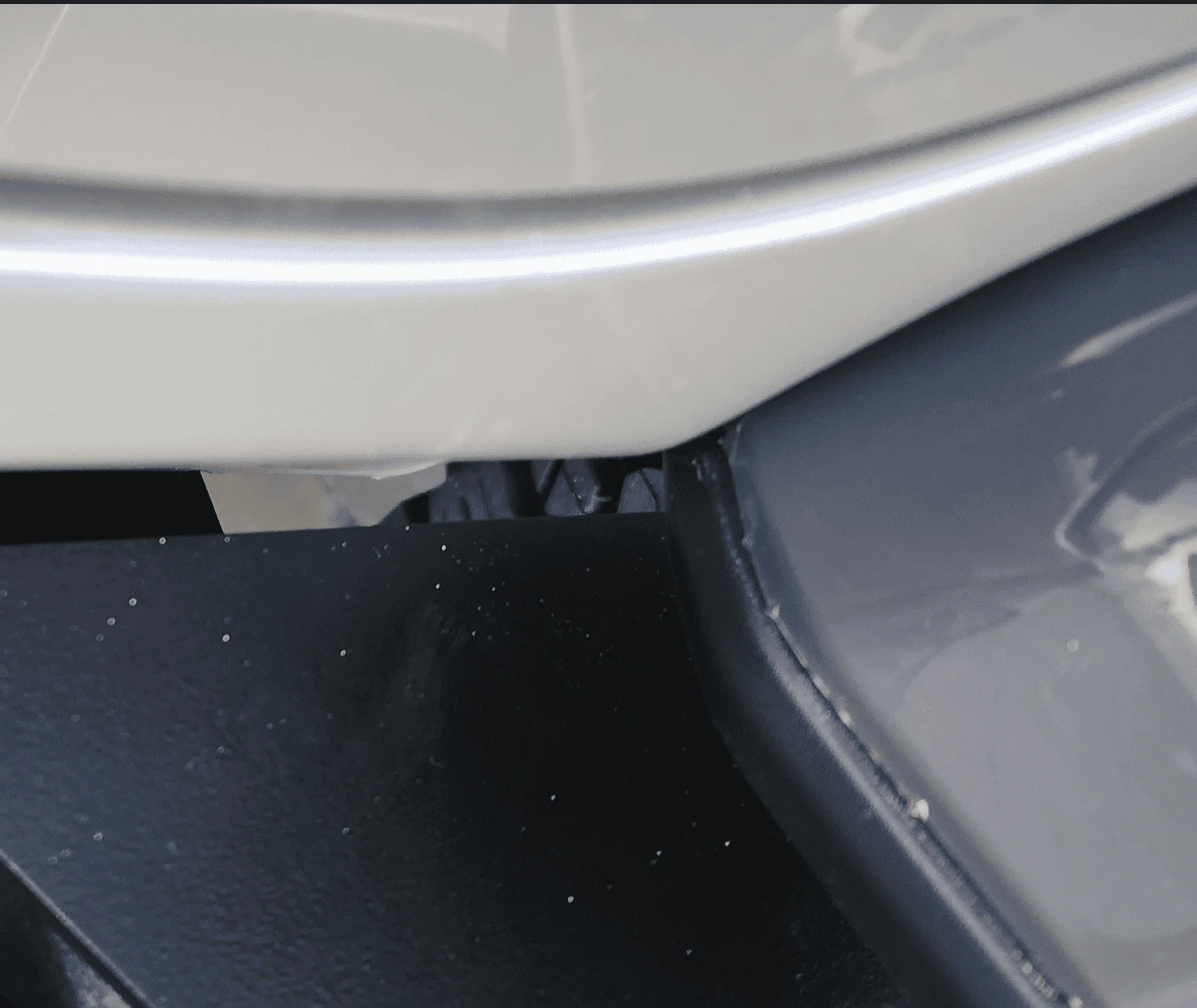

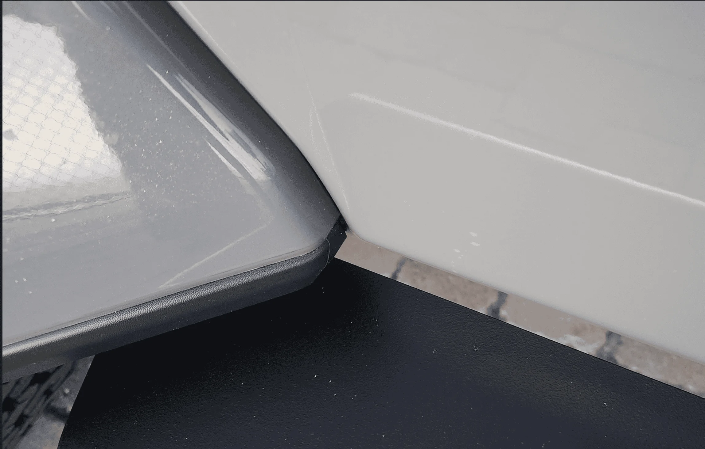

  • The alignment part was a lot of fun as well. Due to the curvature of these rails, the ends will always end up being closer to the body of the Jeep than the middle is. After you loosely attach the rail to all 3 brackets (and make sure that all the bolts holding the brackets to the body are loosened a bit), you can adjust the rail somewhat by pivoting it on the center bracket, while trying to make sure that the front and the rear edges are equally far from the body. You can also move it back and forth to get the fit you like. This is a lot of fun to do if you are installing these by yourself. I had to loosen and tighten all the bolts 3 times on one side and twice on the other before I got the rails where I want them. What a PITA.

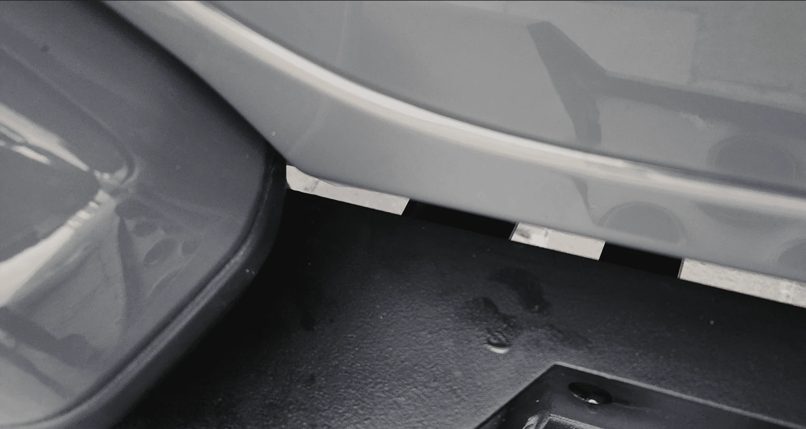

  • Spacers: When the manual tells you "every Jeep is different", they mean it. I don't know whether every Jeep is different or every set of rails/brackets is different (I wasted enough time on this install and didn't want to spend more time measuring), but I ended up using 4 spacers on the passenger side and only 2 on the driver's side. Of course, LOD only includes 6 spacers (enough for 3 brackets), so if your Jeep or sliders are crooked enough so that BOTH rails are too close to the body, you are SOL and will need to try to get extra spacers from LOD. Even WITH spacers, you may end up with the end of the rail being a little too close for comfort to the body. Mine look like this (I think I have about 7-10mm gap between each end of the rail and the body). Passenger side is closer (despite having spacers). Hopefully the brackets won't flex:

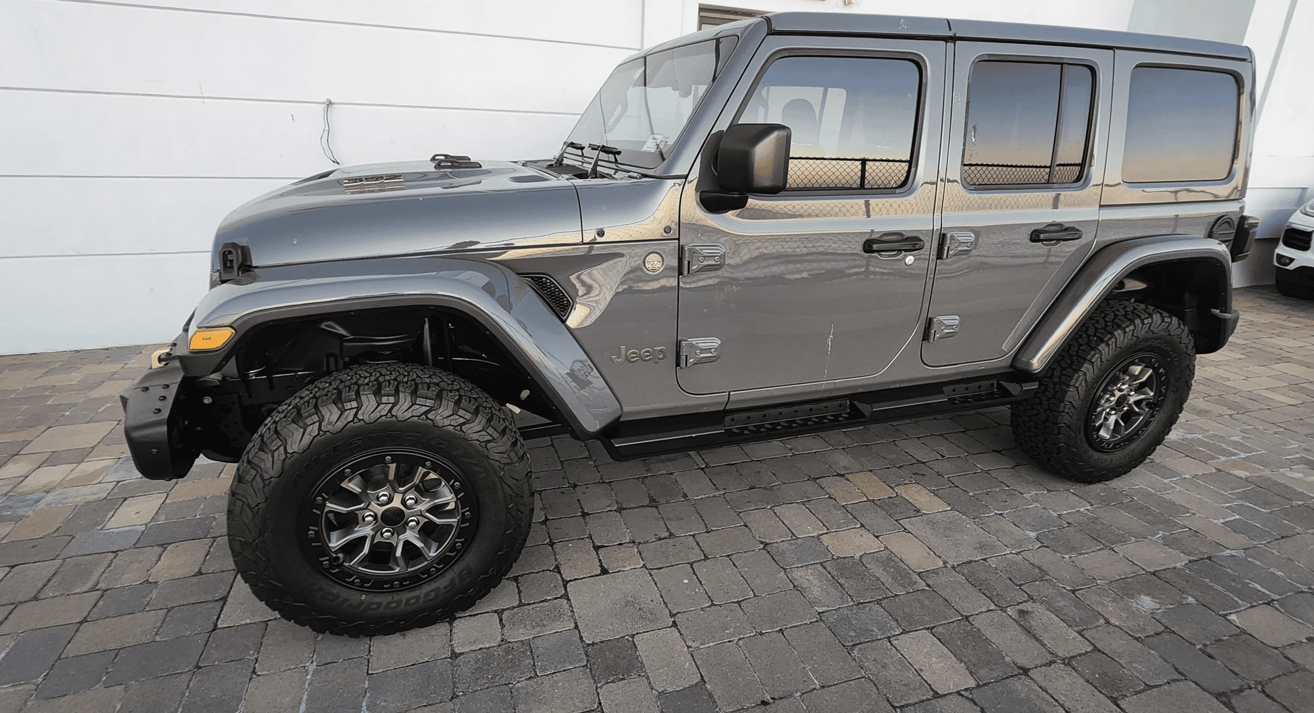

End result:
Jeep Wrangler JL LOD Destroyer Rock Sliders - need install tips 1680048281887
  • I had big hopes of using these sliders as steps (actually one of the main reasons I chose these over some other brands) but they ended up being uncomfortable. Since the top of the step is only about 4" below the door sill and I am 6' tall, standing on the step places the roof of the jeep 4" below my shoulder level. Then I have to crouch down to get in. Basically imagine taking wheels off your Jeep, resting it on 4" tall wooden blocks and then trying to get into it. Definitely not comfortable. To be clear, this has nothing to do with LOD, but definitely try to find someone who has these installed to understand whether these steps work for you. They are great for small kids for sure.
  • I didn't install the optional bolt because I didn't have the balls to drill into the frame. I decided to see what happens when use these sliders on actual rocks....I guess I can always add it later if needed. I'm not planning to tackle 5' boulders anyway.
