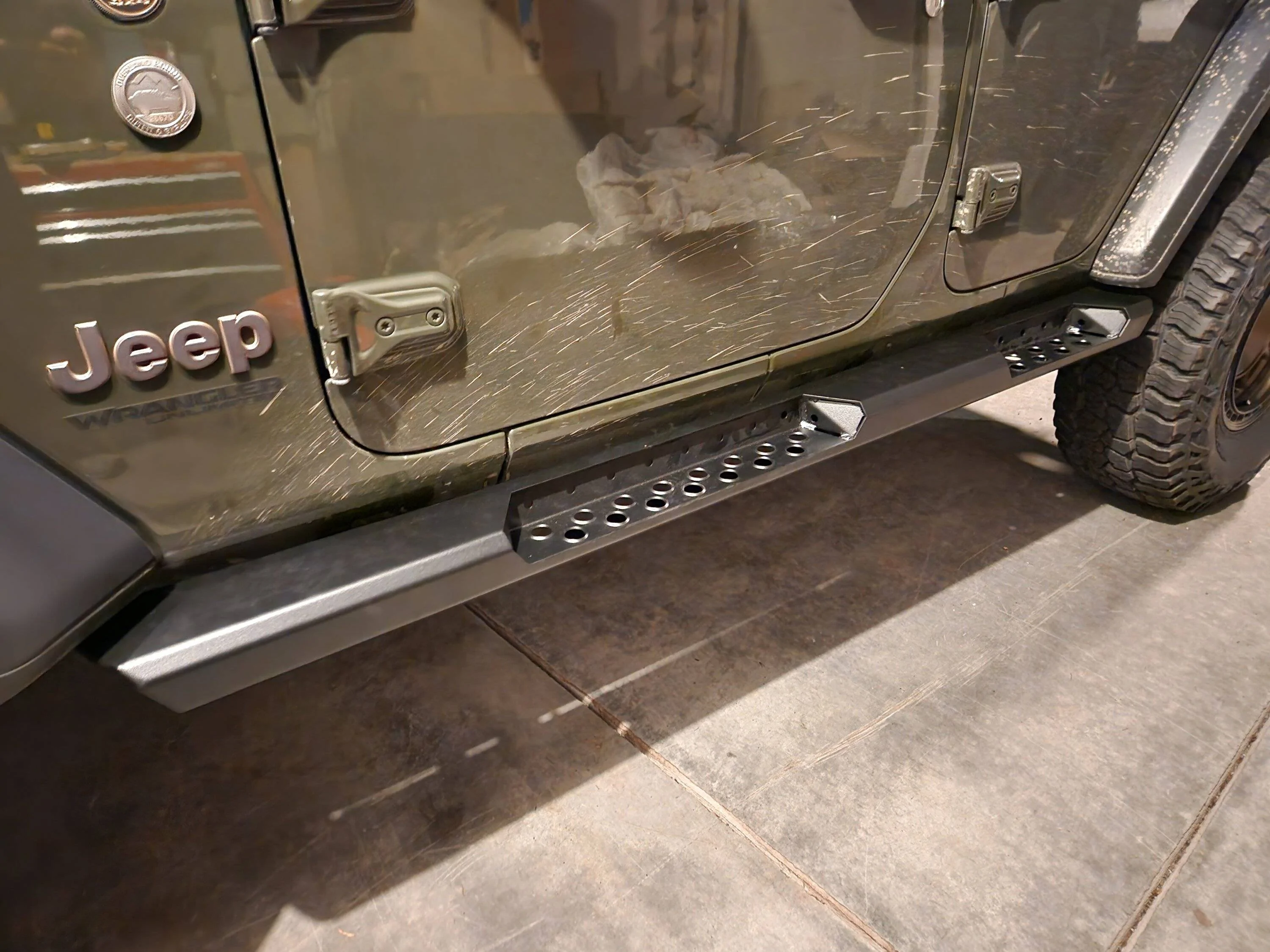

Installed a set of destroyers this weekend. Took about 3 hours or so, although was not in a rush. Very happy with the install and look. Originally I was very anti-step on the Jeep, but happy I changed my mind. Much easier to enter and exit, plus easily accessible for the roof rack.
Liked the redesign with the mounts separate from the slider. Much easier to manage and install. Also they didn't use spray foam for the slider packaging. It was wrapped with some dense grey foam and kept a ways from the box sides. No damage at all. The mount packaging was spray foamed but the foam was in some plastic making it much easier to remove. Only problem was that they shorted me the two thread roller bolts, although it was checked off and initialed by the packer. Contacting LOD for those.
