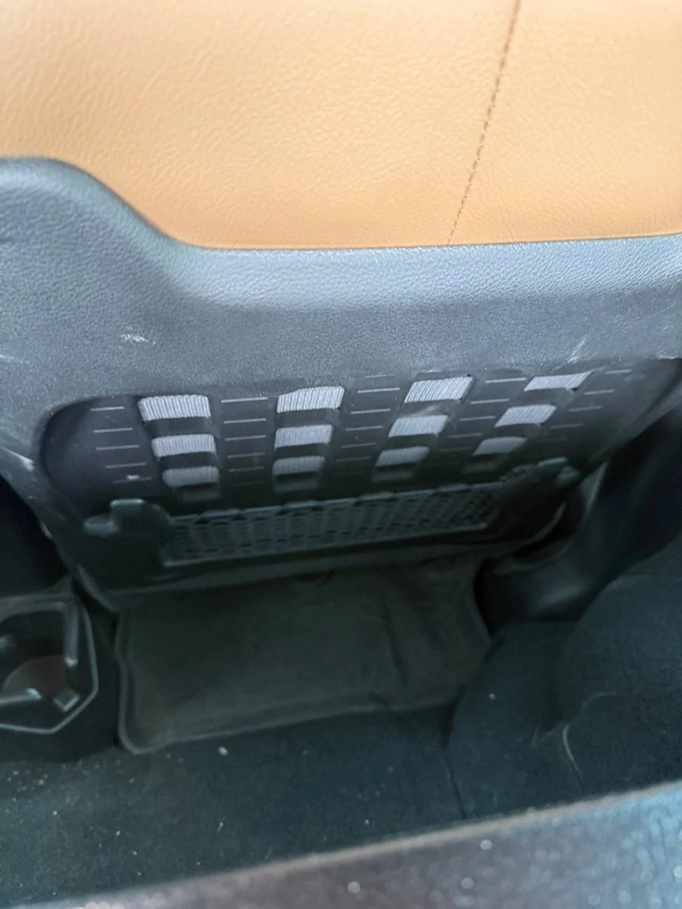

None of the products I've found indicate that they're compatible with two door JLs. This includes the flat, side-specific mounts and the angled mounts that fit either side.
However, I found this video (go to about 12:20) where a flat mount was used on the driver's side.
Looking at my JLR, it appears the only thing stopping the mount from fitting is the carpet pin that holds the rear floor mat in place, which would be a simple fix.
We also know that the Alpine PSS-23WRA2 works just fine in two door JLs, which leads me to believe that one of the angled amp mounts would also fit without issue.
Thoughts? Has anyone tried to use one of these mounts in a two door and been successful? Or unsuccessful?
Found a solution 👍
The angled amp brackets work just fine in the two doors.
If you have the factory liner-style floormats they'd need to be trimmed to fit, but others might fit as-is.

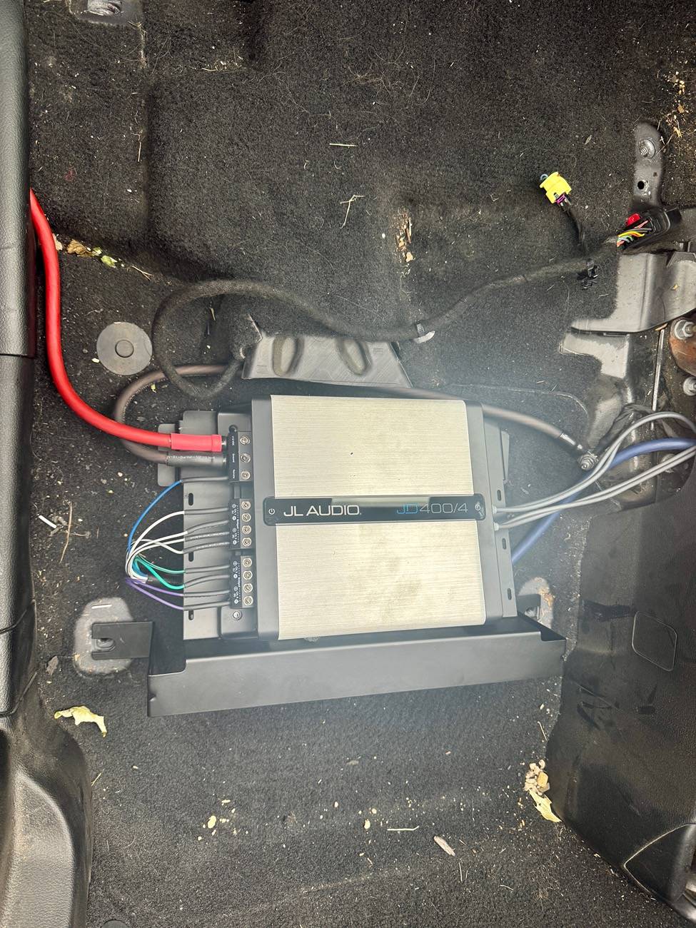

Need a home for this guy :like:

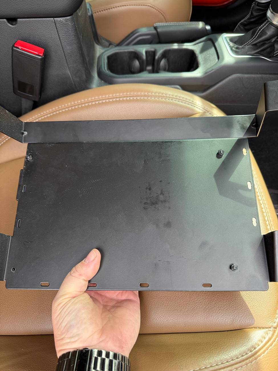

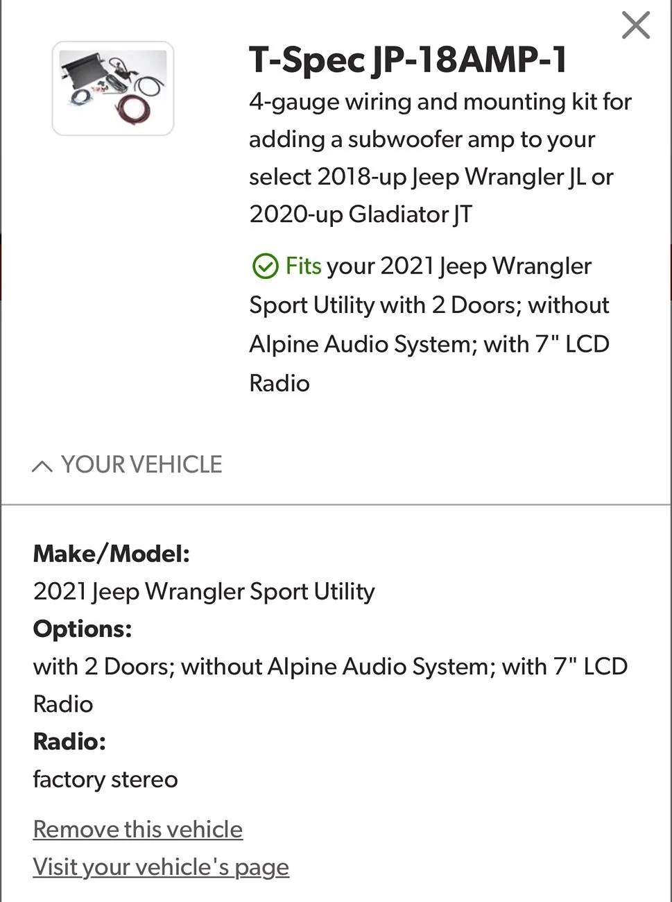

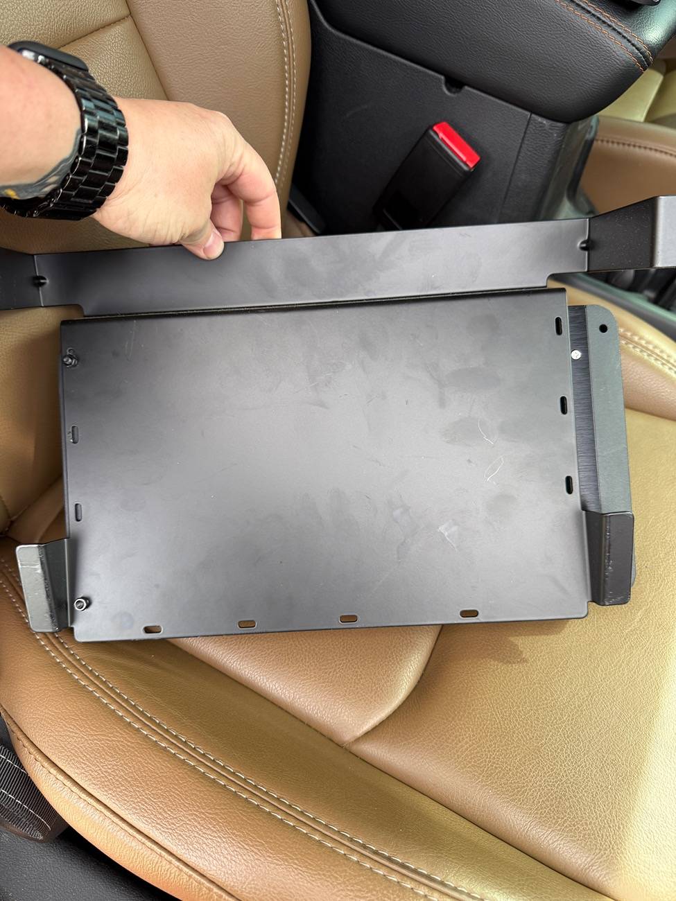

I was looking around on Crutchfield and noticed that they list the T-Spec JP-18AMP-1 as specifically fitting the two door.
Jeep Wrangler JL Let's Talk Two Door Amp Mounts - Solution Found IMG_8935
Of course it's hella overpriced as a kit with all the wiring, but I was able to find just the under seat bracket on eBay for $30

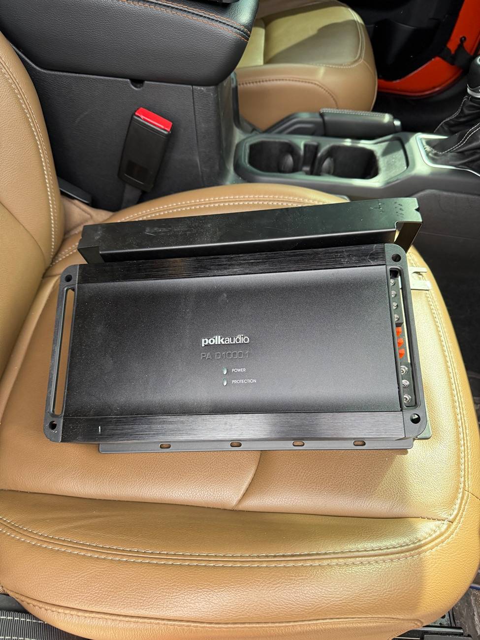

Just because an amp rack says it dosent fit the actual amp dosent mean that it won’t look at the dimensions on the amp and the bracket may just need to drill a few new holes to mount the amp. That’s what I did for both mine. I have a Polk audio d1000.1 and a d4000.4 mounted on my metra. When I get home I get pics of the amps mounted on each rack and also I’ll throw them back in the jeep so you can get an idea how they fit. Won’t be bolted down just sitting in there.

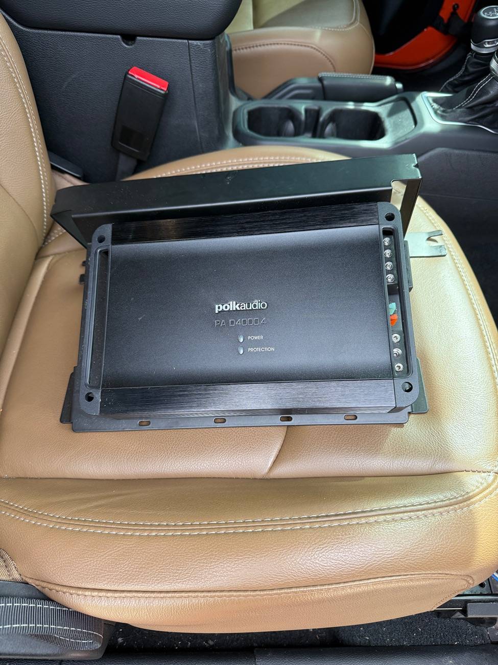

Here are the amps mounted front and back where I drilled the holes to attach them.
Jeep Wrangler JL Let's Talk Two Door Amp Mounts - Solution Found IMG_3914
Jeep Wrangler JL Let's Talk Two Door Amp Mounts - Solution Found IMG_3916
Jeep Wrangler JL Let's Talk Two Door Amp Mounts - Solution Found IMG_3913
Jeep Wrangler JL Let's Talk Two Door Amp Mounts - Solution Found IMG_3915

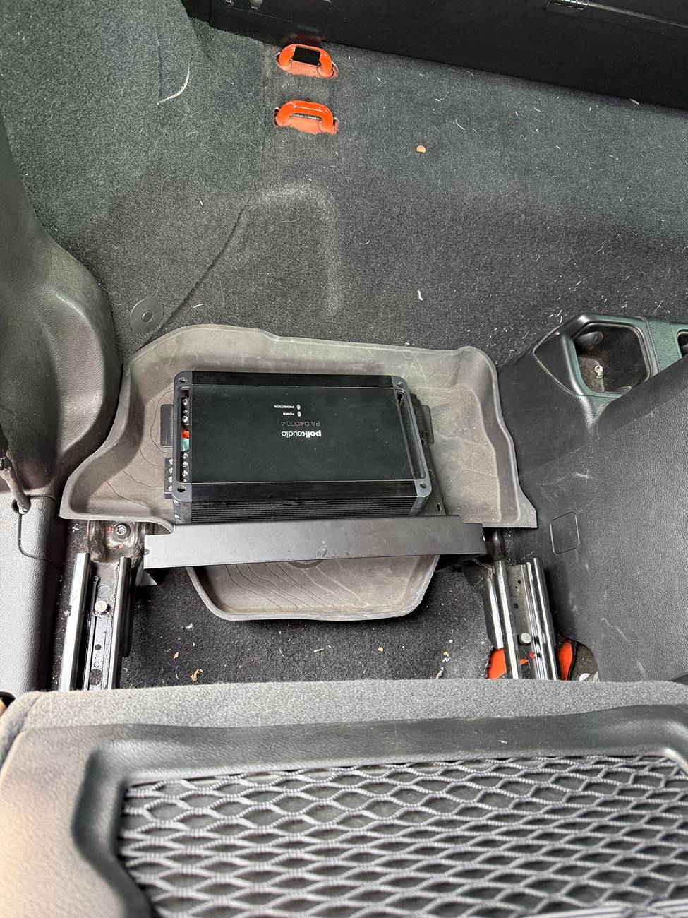

Here is passanger side how I had it ran then facing front.
Jeep Wrangler JL Let's Talk Two Door Amp Mounts - Solution Found IMG_3917
Jeep Wrangler JL Let's Talk Two Door Amp Mounts - Solution Found IMG_3918
Here is driver side.
Jeep Wrangler JL Let's Talk Two Door Amp Mounts - Solution Found IMG_3920
Jeep Wrangler JL Let's Talk Two Door Amp Mounts - Solution Found IMG_3919
Here they both installed facing forward with the seats back. View from the rear.
Jeep Wrangler JL Let's Talk Two Door Amp Mounts - Solution Found IMG_3923
Jeep Wrangler JL Let's Talk Two Door Amp Mounts - Solution Found IMG_3922

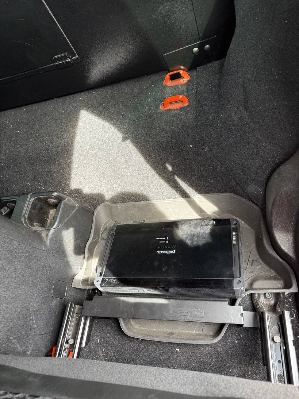

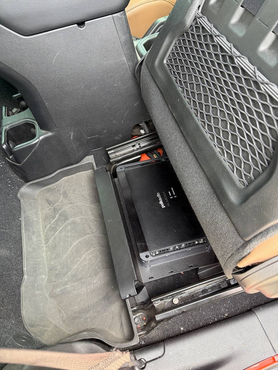

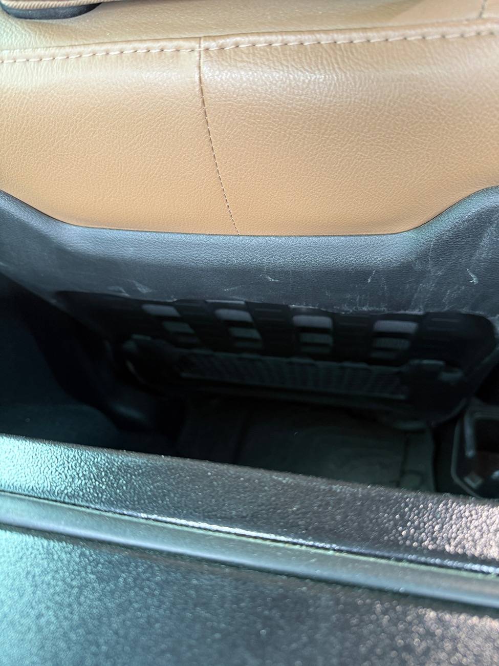

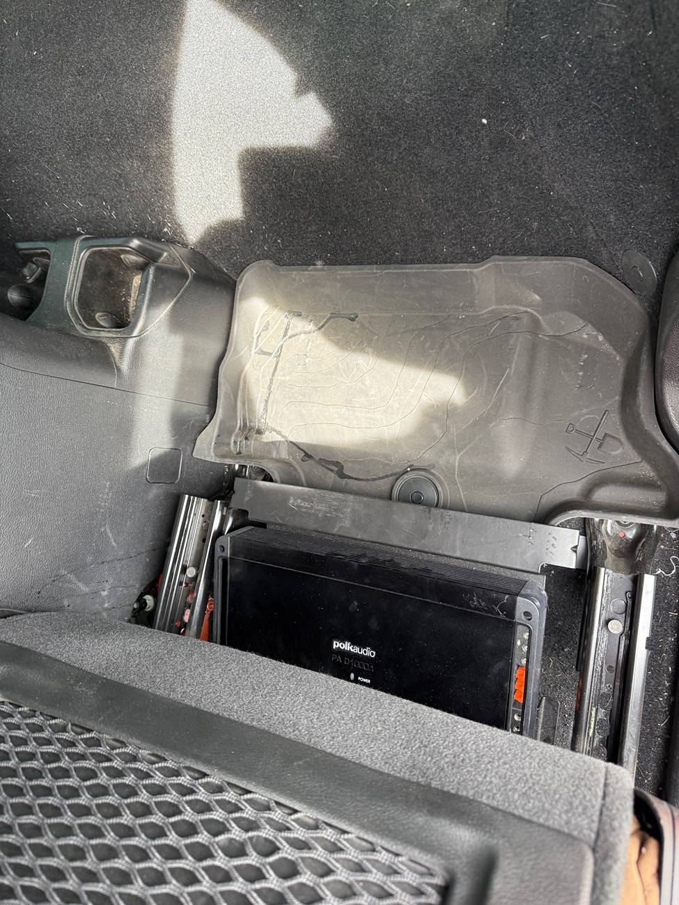

Jeep Wrangler JL Let's Talk Two Door Amp Mounts - Solution Found IMG_9118
