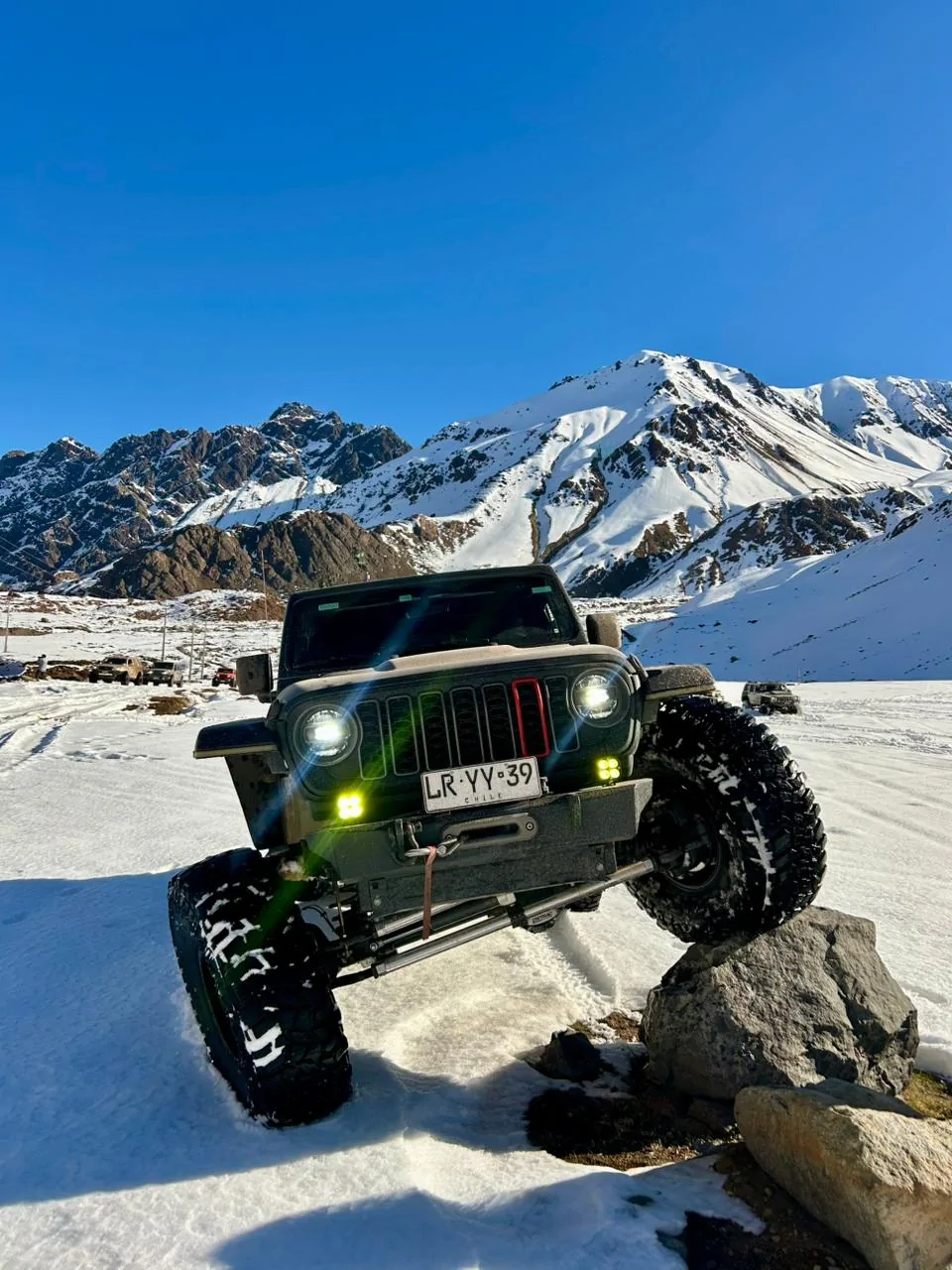

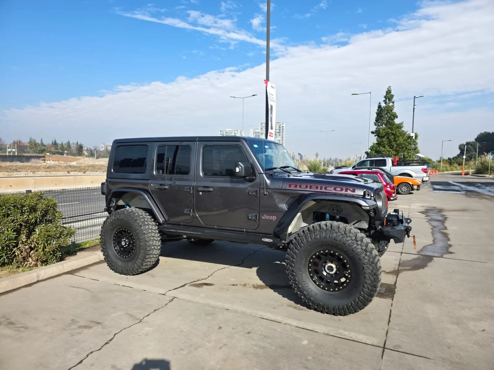

I really want to jump from 40x13.5r17 to 42x13.5r17. I am currently running the following set up.
73" Wide DSTRAC 76 Axles
4.75" BS method wheels
40x13.5r17 Cooper STT
4.5" Rock Krawler springs w/king shocks
Teraflex long arm.
Overall jeep width is 86.5". Will this setup be good enough to run 42"? Should I be wider? taller?
