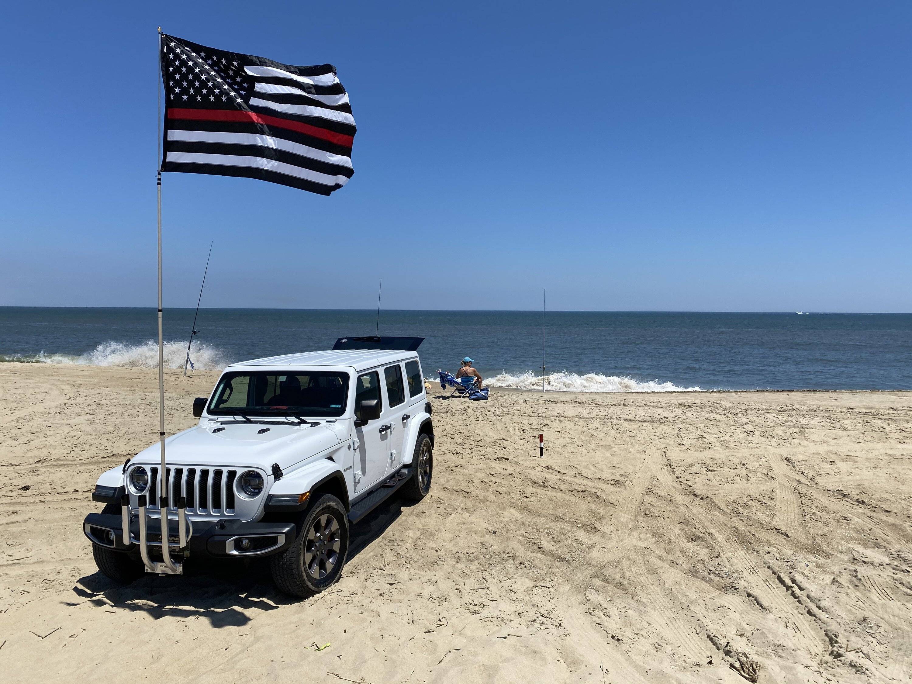

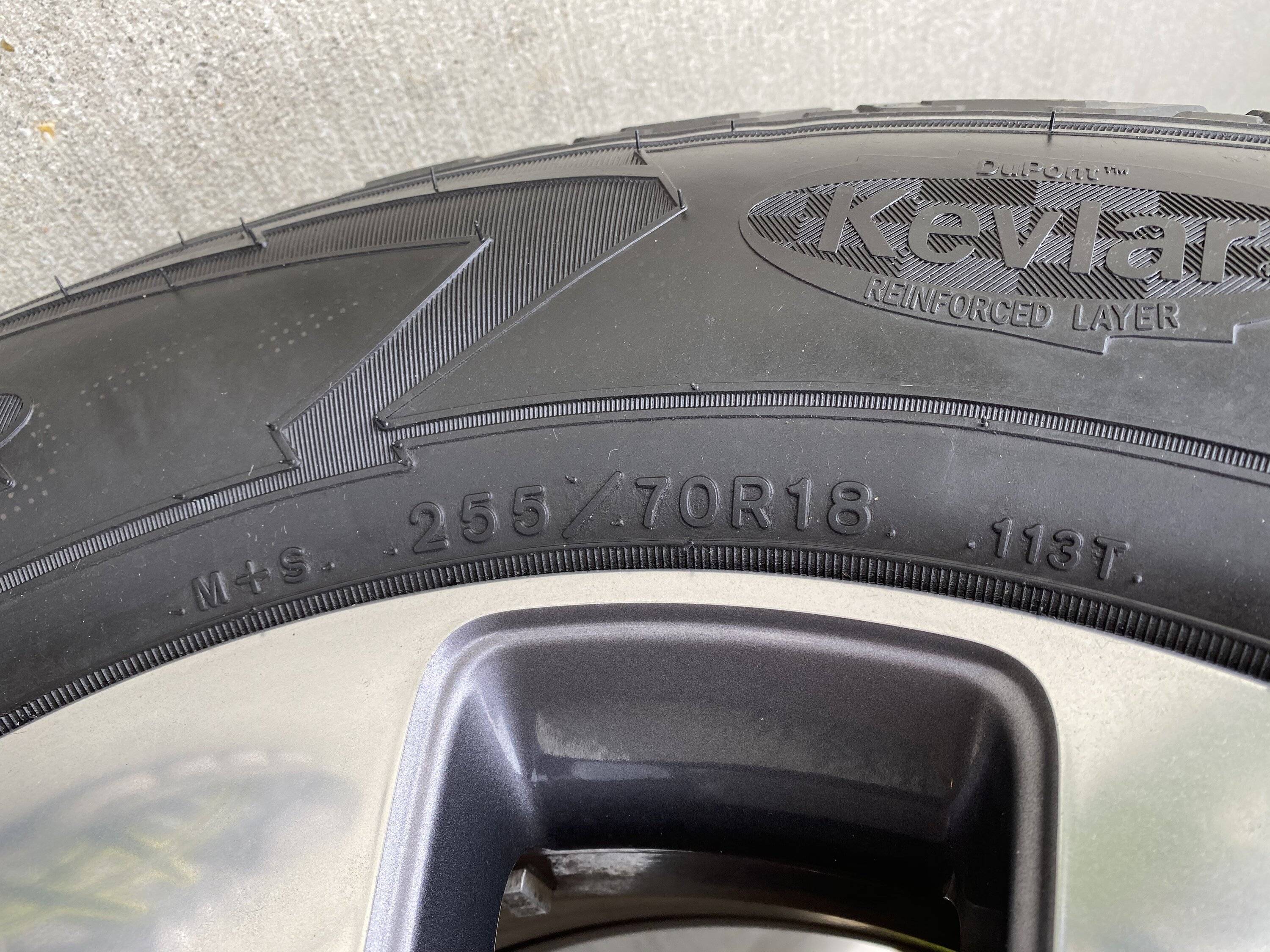

I don't want to hijack the OP's thread, but I have a similar concern regarding load range.
The current tires on my Sahara are the factory Goodyear 255/70 R18's and the sidewalls are very stiff. Too stiff for my intended use.
Since my off-roading is always on beach sand, I am looking to eventually replace these tires with the least aggressive tread I can find, with a sidewall that will bulge when aired down to give me flotation in soft sand.
When I replace my tires, I will replace the factory 18" wheels with something in 17" and the factory offset to give me a bit more sidewall.
I would love a non aggressive 'street' tread tire like a BFG T/A radial, preferably in a 285 to 315 width and a 60 or 70 aspect ratio while mounted on a factory offset wheel.
My goal is to keep the tread as non-aggressive as possible, and as close to under the fender flare as possible while maximizing sidewall bulge and that 'marshmallow effect' for good flotation on the beach.
Am I asking for too much?

Without rocks to worry about pinching sidewalls, I'd just buy a street tire in 285/70/17 (not LT, just regular passenger load range) and it would likely work great.
