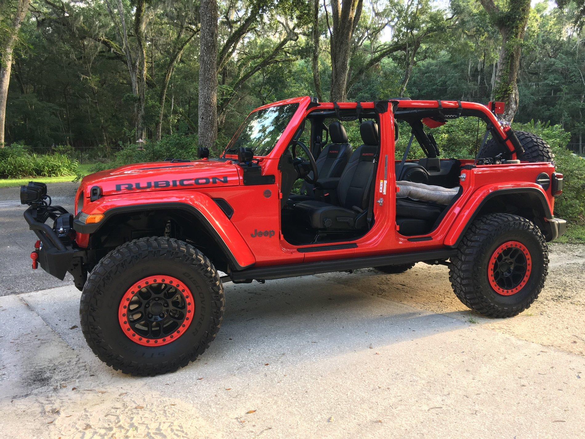

I went with 37's Copper Tires. Glad I didn't do 35 as I would have been sorry. The ride is great and don't need to change gearing. I hold 8th without a problem. I am in Fl so pretty much flat.
