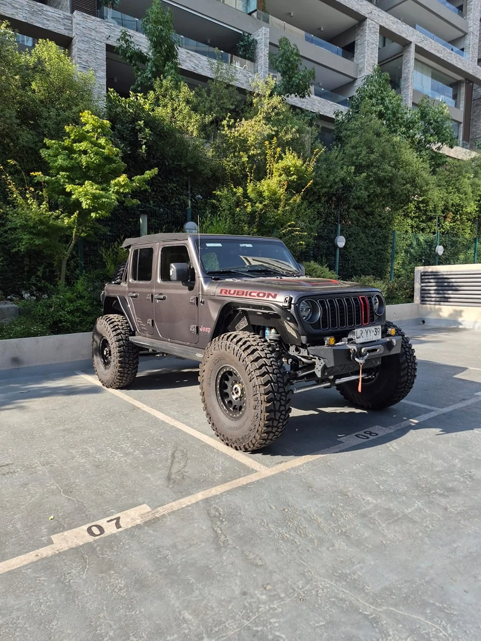

Hey. I've been running 42s for 2 months already. I went from 4.10 and 40s with stock axles to 5.38s on 40s on 1 tons and now 42s. I really find it is perfect. Mine is a daily driver. I can be driving at 80mph and don't even notice I have 42s, its really impressive. I don't even have PSC steering.
Thank you for that feedback! What did you end up doing for clearance actions?
Well I have 73" wide axles on 0 offset wheels, so great scrub radius. With motobilt fenders and 40+inner fenders I have 0 issues. + 4.5" lift teraflex springs.
