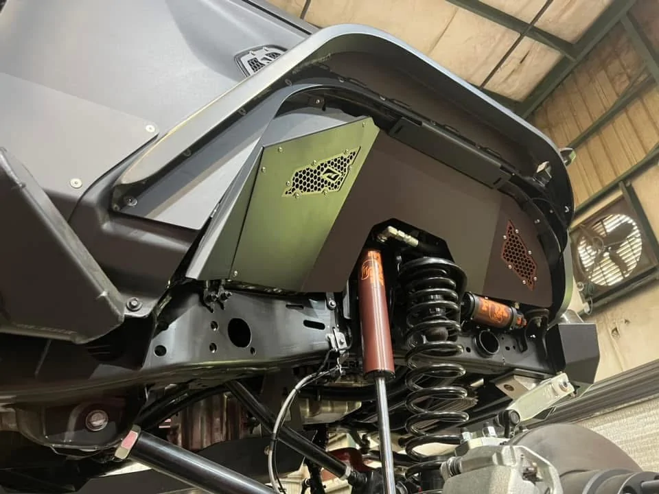

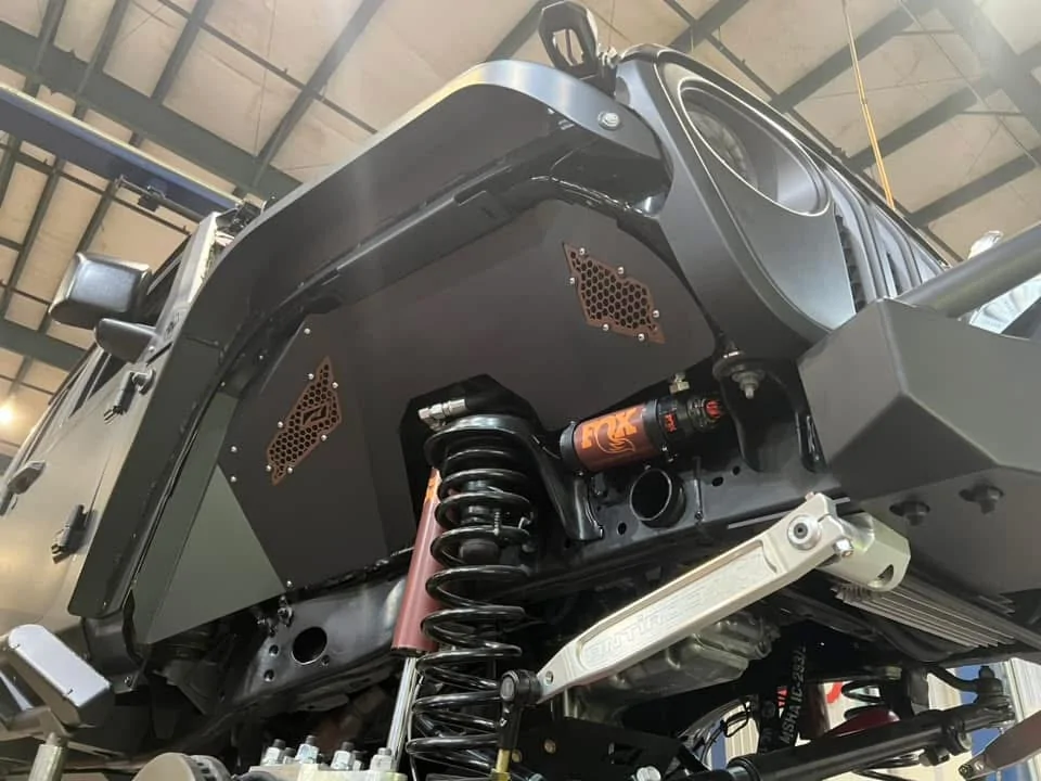

I got an early access to Motobilt Black Friday so I ended up getting motobilt high clearance front and rear aluminium fender + front 40"+ front inner fenders, which gives you the option to cut about 1.82" in the front. Plus I got some front and rear 2-4" adjustable bump stops to set everything as needed. Will cut as much as possible in the rear and I should be ok to go. Tires are arriving in 2 weeks to Chile and all motobilt parts next week!
Did you install the Motobilt high clearance front inner fender liners? I have seen what they show on their website but I’m curious to know how much gets removed at the rear of the front fender well opening. I’m just a peasant on 37s at this point.
Yes I installed the high clearance. Thanks to that almost 2" that fender well trim I am able to run 42" without issues.

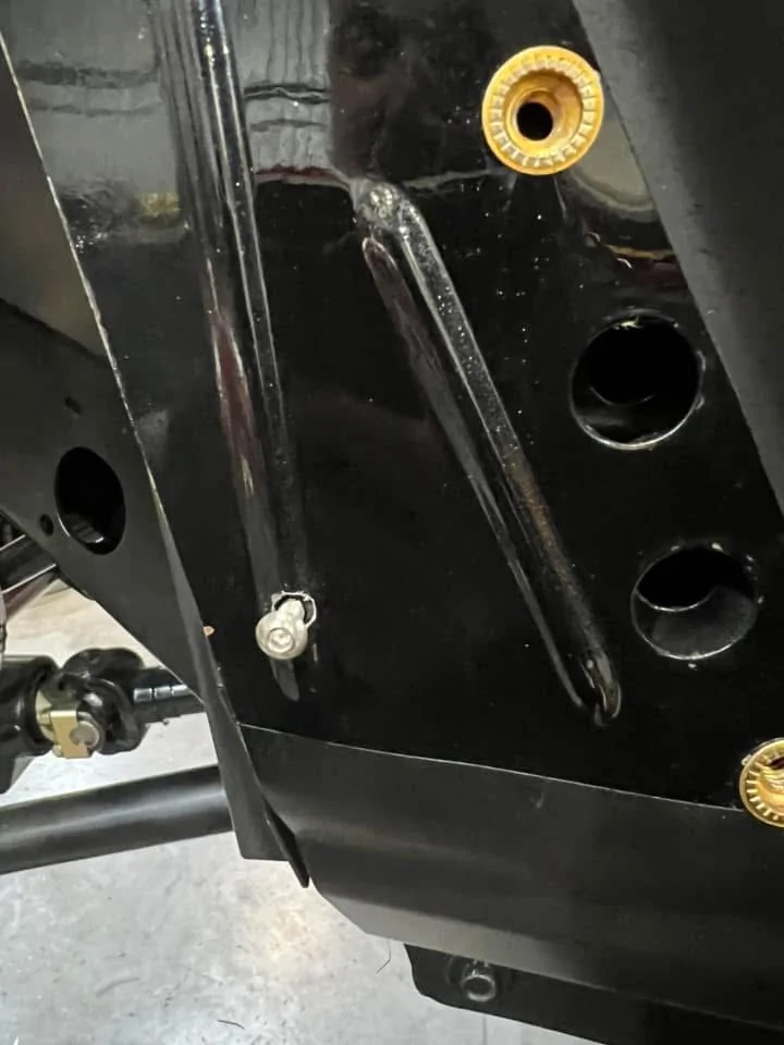

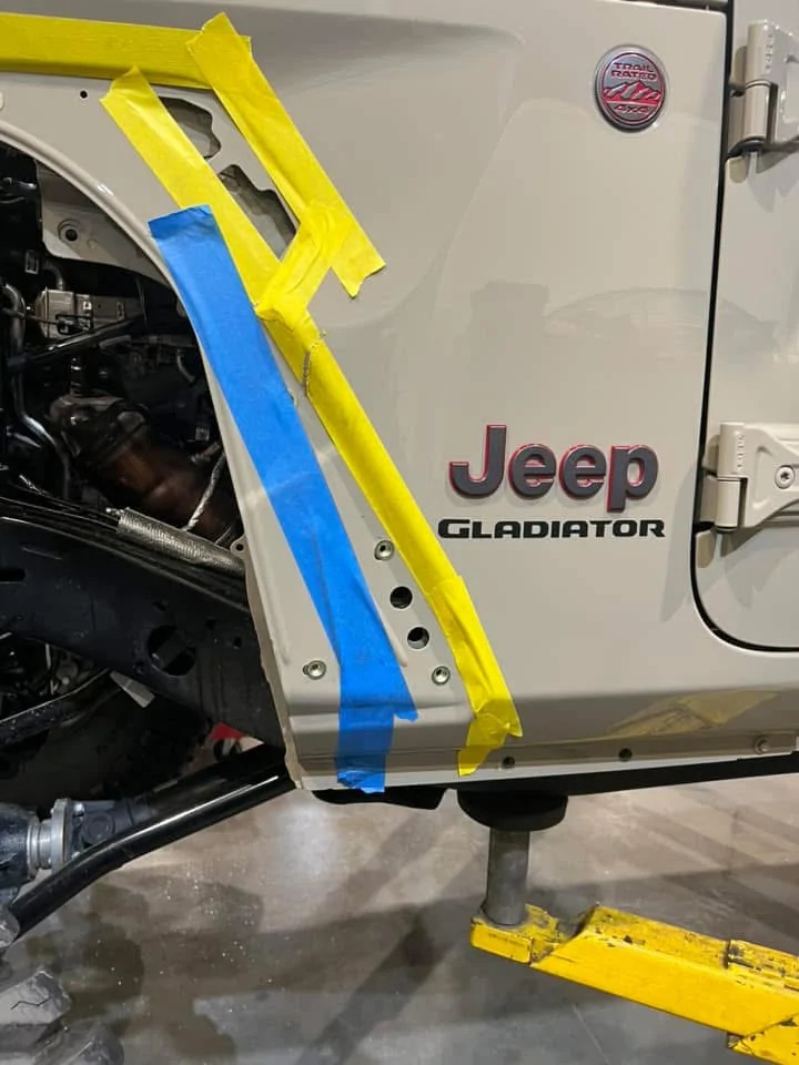

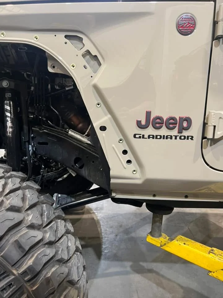

If it’s not too big of an ask, whenever you have time, can you show a few pics of where the sheet metal was trimmed at the rear of the front fender well. I see the instructions which just show a red line to show where to trim, but I was hoping for some pics. Thank you.
Let me get the pictures I use from Motobilt facebook page. Instruction where also not clear enough for me.
I found these just now In Motobilt Fbook. If you have anything else I would appreciate it.
