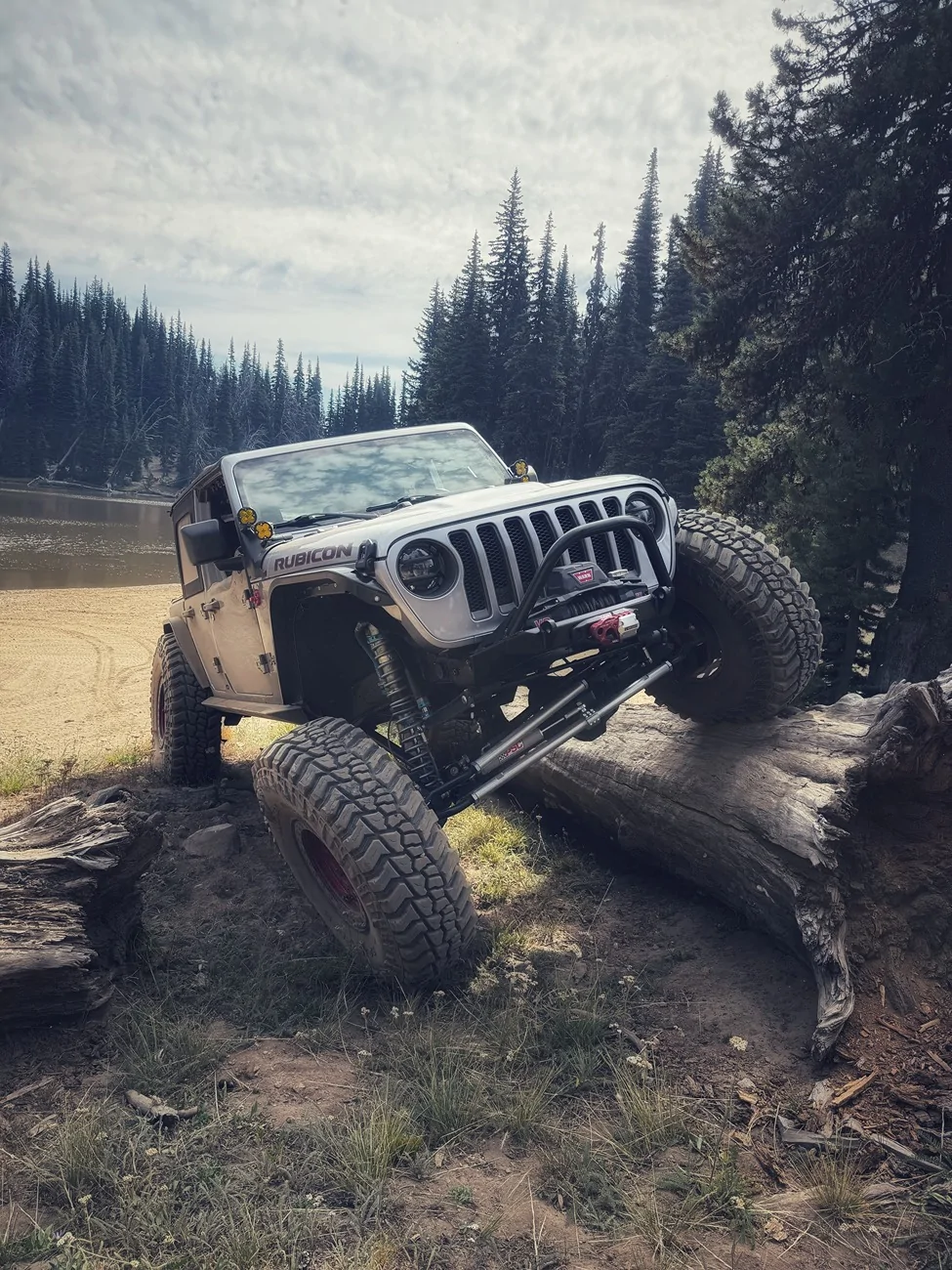

Kevin of Lite Brite is running 42s on his JL 4 Dr with a race built 392 named "Step Child". He has done every mod a person can do for running 42s and to keep it reliable.
In the past, he has pretty much elaborated on all the mods he has done. You should try to reach out and see if he is willing to help.
I was checking motobilt "hooligan" build which has 71" wide axles and 4.5" BS wheels and running 42" with a 3.5" lift. I believe Lite Brite is not to Wide, but looks tall...

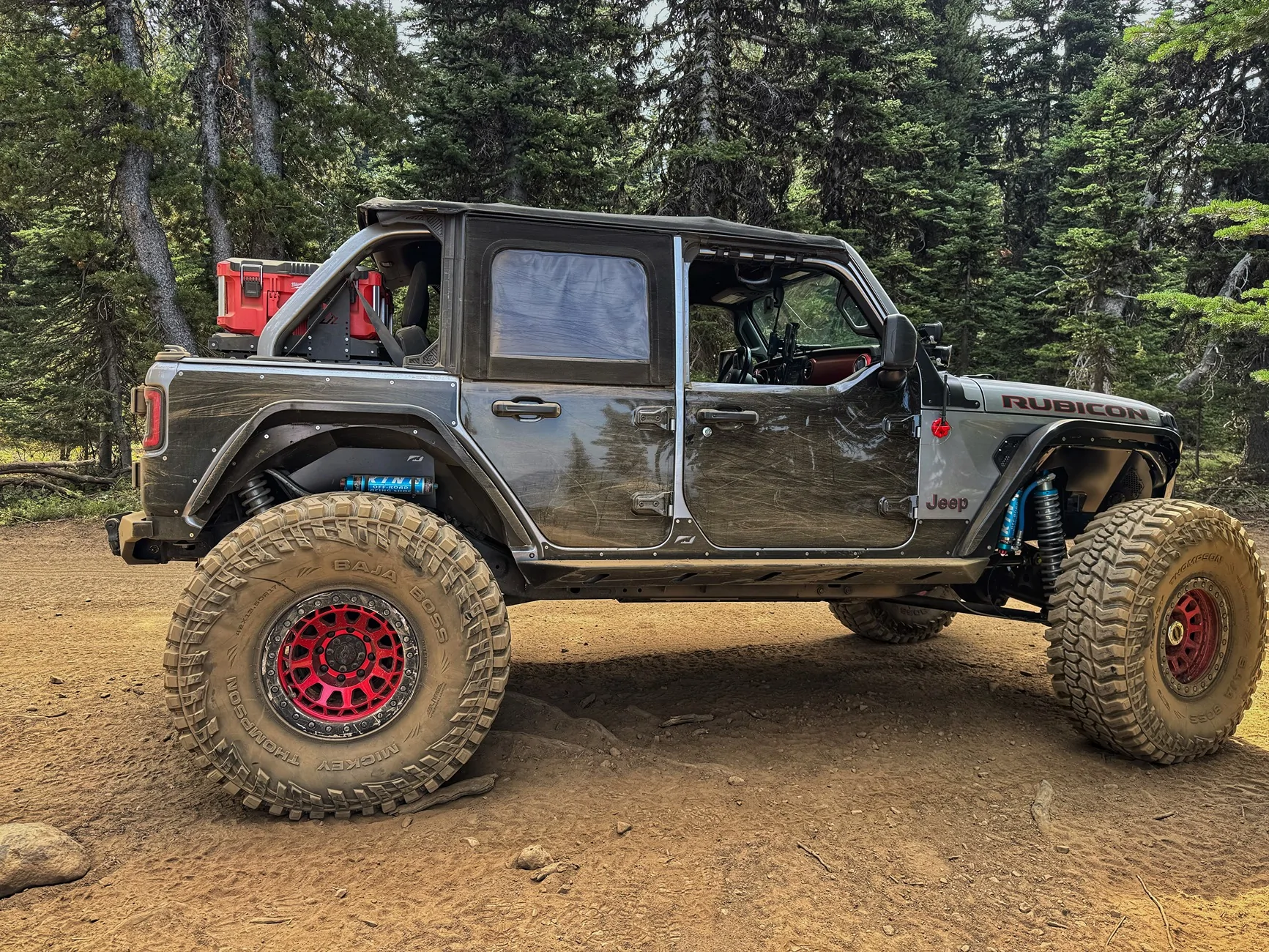

Niice. What axle width and wheel BS? Also that is rebel or evo coilovers setup? Thanks
69 wms with 3.5 backspacing.
Motobuilt coilover towers front and back. Rear is triangulated 4 link.
Front is 3 linked long arm. I built all the links and used 14 inch 2.5 kings. No bolt on parts on this build!

Its looks we are almost at the same width. Mine being 73" wide on 4.75" Backspace Wheels. Mine has a track width of 80.5" and yours 80" if I'm correct.. So I might be OK on 42"

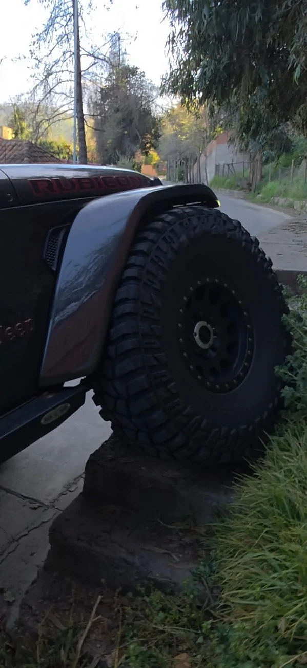

Should be real close. Just know at full steering lock with the tire stuffed you will rub hard on the back of the fender well. You could probably trim som or limit up travel. I chose to stretch the front axle out 2.5 inches and have plenty of room now.

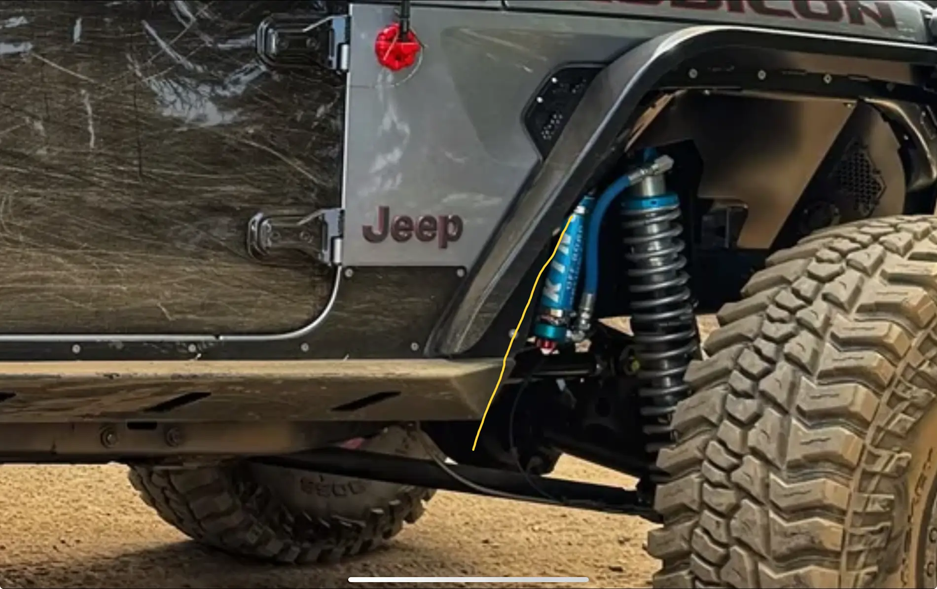

You can actually trim this section back and gain about 1.82”s of extra clearance as well. I know you already moved your axle forward but this would help for others.

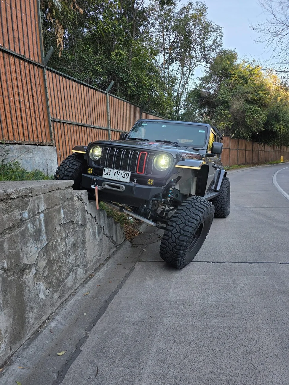

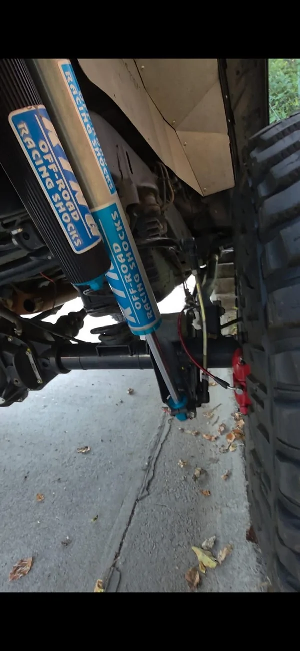

I've heard that 1" is like the max you can push the axle forward before having issues with track bar and steering components, or not? Today I was doing some testings and with 40s my main issue by far is my front fender. Definitely need narrower fenders lol. Everything else looks great and with plenty of space. Also looks like my rear sway bar end links are way to long and limiting my rear flex..and also I bended one...
I also think that will be a good idea. I believe I have to be careful with the inner fenders mounting points
