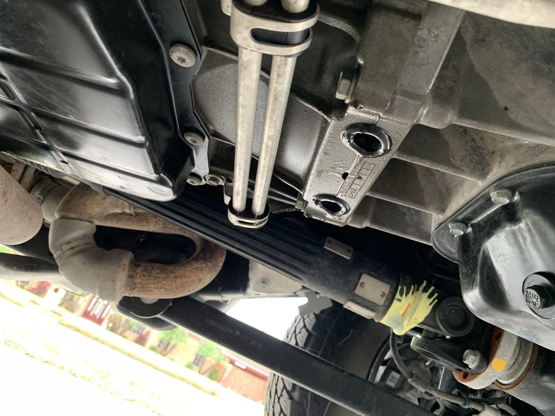

Mine just got picked up by the Roadside; was about to crank it when I saw the puddle on the driveway. Got underneath and noticed the leak from between engine and transmission. Engine oil was just changed this weekend (all work at the dealer). Real bummer; I'd wish you and I were arguing over who has the best jeep but I guess, right now, it sucks. Mine only has about 9,500 miles.
It does suck big time !
