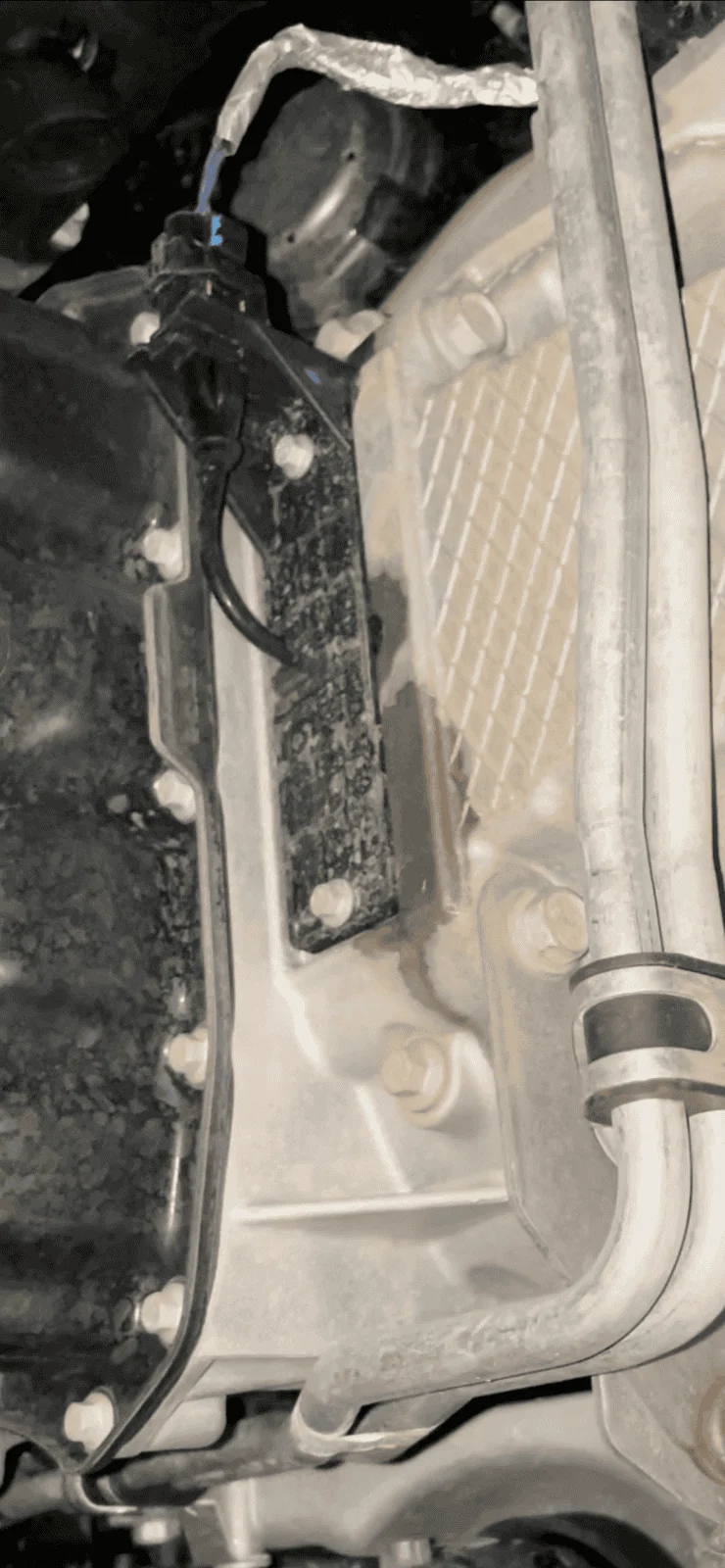

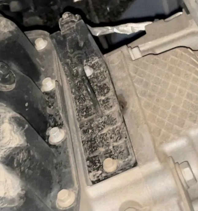

We have two JLs. Both have the Ecodiesel engine, and both are wet under the engine/trans. No drips but clearly wet. Less than 3000 miles on each. Any thoughts to help me before going to the dealer? Here are the two:

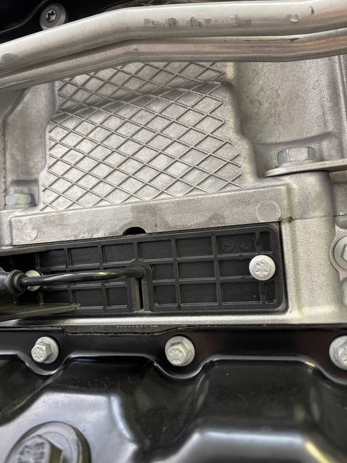

Does this look like a slight weep to you?

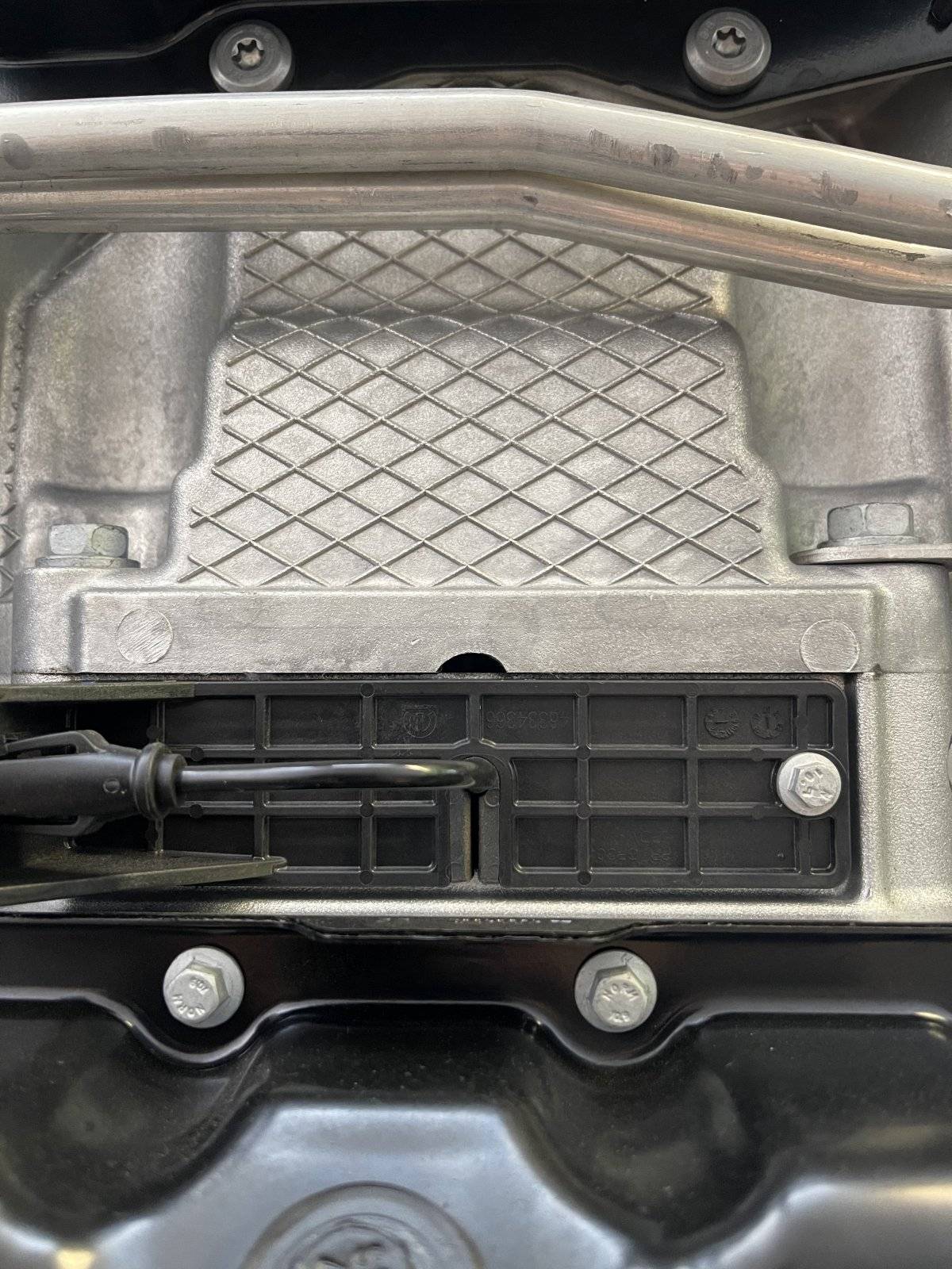

I just cleaned mine off, going to monitor and see if it comes back. 3500 miles on it

Does this look like a slight weap to you?
It does to me. If it cleaned up like oil, then It’s probably oil. I don’t believe there should be any residual from the factory since it should be filled after it’s put together. Do they all weep?

Dealer replied after I sent them my photos in the first post. It’s one of two possibilities:
1. Lubricant from the factory for it’s long wait on the dealer lot.
2. A small bit of oil that weeps through the seals. The seals are always wet, and some oil may weep through especially during long idles.
The seals are not perfect. If it’s not dripping, all is good. Ripping it apart is a very bad idea if it’s not an actual problem.
I know the service manager and the tech and trust their judgment.

I’m going to keep an eye on mine but I bet it doesn’t come back now that I’ve cleaned it off. The small bit of a stain that came off was very dry.
