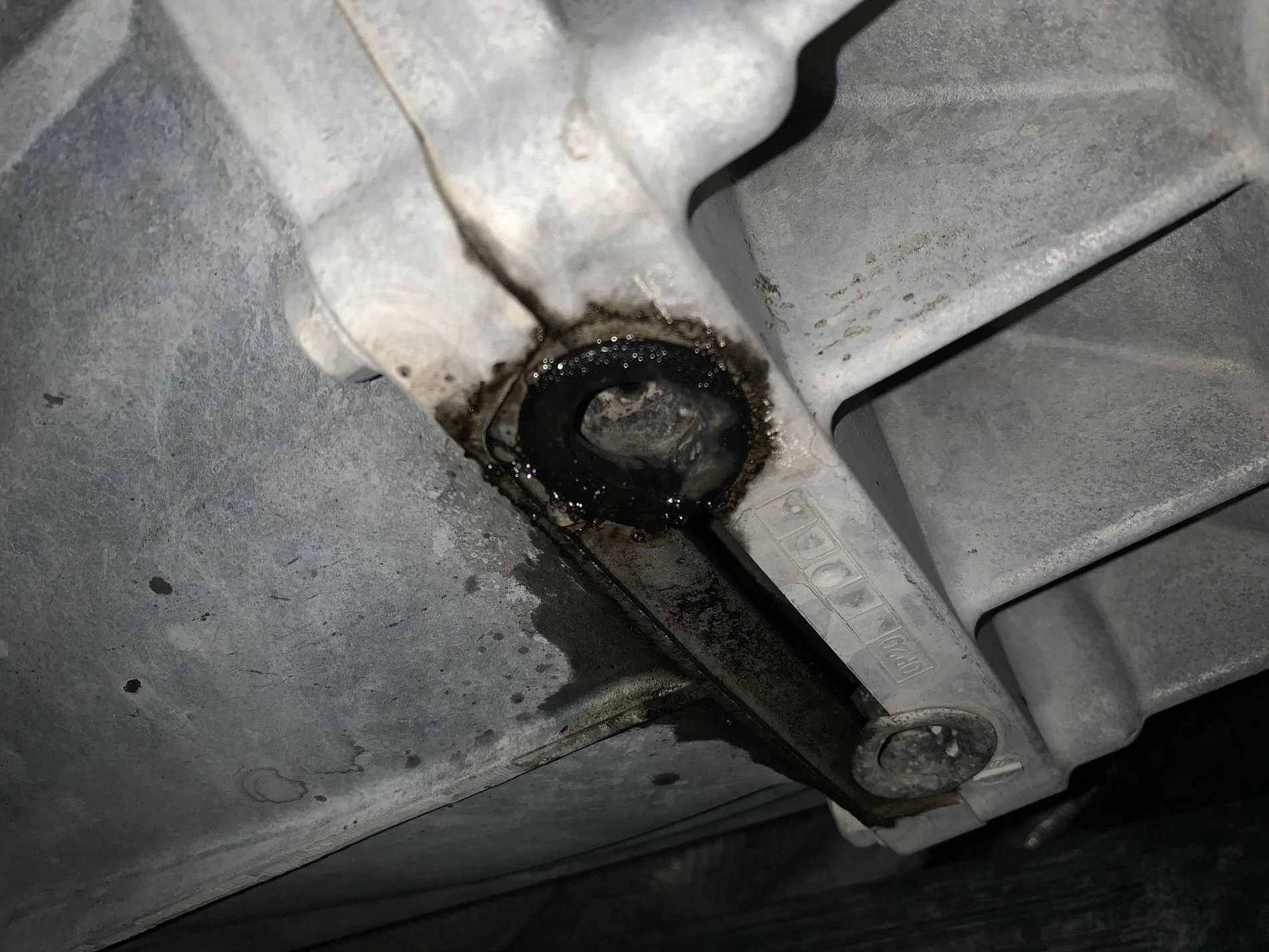

Sounds like a lot of dealerships are putting 6 quarts of oil in these engines when doing the routine oil change, but the JL's take 5 quarts. This is what happened to me, and in my case, my dealership is so incredibly obtuse that they are still INSISTING that it takes 6 quarts even after I sent pics of the dipstick showing high oil and the owners manual showing it takes 5 quarts. They actually suggested this morning that I may have the wrong dipstick or that it may have leaks (??) because there's no possible way they are wrong about JL's needing 6 quarts of oil.
It sounds like a lot of dealerships are treating the JL's the same way. The JK's take 6 quarts of oil, but the JL's only take 5, and the dealerships just never bothered to change their procedures with the new JL's. So a lot of Jeeps are probably running really high on oil.
I'm no mechanic, but I've read a few places that running engines on too much oil can cause engine problems such as busted seals. Not sure if this is true or not, but I'm just curious if your issue could have resulted from having an oil change where they put over a quart extra oil in?

Thanks for the reply; it was a pretty big leak; the Jeep has been at the dealer so wouldn't be able to tell you the quantity but it was significant. Once the engine fired up, it would start dripping. I've owned many vehicles throughout my life and have never had any transmission or engine replaced; I always maintain them (mostly myself unless they are under warranty then only the dealer touches them) so this caught me off guard. At 9,500, one would hardly figure that such a leak would be present; the dealer gave me a rental so I'll be using that for now. I do not blame the dealer; I blame FCA. How can the dealer and even JeepCares do anything when FCA doesn't even have its own parts in stock? My Harley has proven more reliable at this point.
I am surprised that there are so many posts of leaking fluids on these Jeeps; from oil to coolant. The reality is that, this should not be happening;
Sorry bro, I'm dealing with the same thing. 1st dealership denied my warranty on june 15 after keeping it for a week due to "excessive dirt".. called jeep cares and they were like "nope, sorry cant help you". My JL had 1500 miles when I dropped it off and was 1 month old! Totally not right. Kept it home for a week and decided to take it to another jeep who has had it since the 6/22. He also confirmed its the RMS. The tech is awesome but just let me know that the part is on backorder until 7/24! By then I've paid 3 car payments for a jeep I haven't had. Oh and, I'm currently in a POS beat up 2017 toyota corolla... I'm furious that jeep cares legit did not "care". This definitely has me feeling all sorts of ways about jeep and ever purchasing another one in the future. I'm currently waiting for a call back from tech to either put me in another jeep or give me mine back till the part arrives. My poor baby is sitting in the lot getting dirty and beat by the sun. Total BS. How is this not a recall yet?

1000 miles on my 19 jl sport s. they are tearing the engine down right now to find the leak.
Mine was at 1300. Its been a nightmare. My jl has been sitting at the dealer waiting on the rear main seal for almost 2 months now. (Since june 17.) They didnt want to take care of it under warranty either because of "excessive dirt". Theres no way I'm paying for a rental, labor and parts after this long. Its crazy. Our advisor at the dealership has been so good and really fought for us as well. The jeep is brand new. I bought is at the end of April. After a lot of back and forth and getting a lemon law lawyer lined up, they just told me yesterday it will be taken care of. Pretty ridiculous and an awful 1st experience with there customer service. I love my jeep but I'm feeling like fca doesn't back their products. They're quick to blame the consumers based on my experience and what I've read/heard. ... I'm just relieved it's going to be taken care of under warranty. But after 40+ days having my jeep sitting here, I'll be keeping all my documents and lemon law lawyer on speed dial if something else goes wrong. Good luck bro.

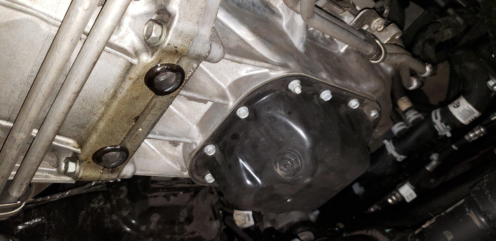

LOL UPDATE
So they said they think it’s just residual oil....
They had me send them the photo and are wanting to keep it overnight and drive it tomorrow after cleaning it and check it again.
I said I’m fine with that.
Not sure how in the heck that could be residual oil from 5k miles ago LOL
Plus after hitting trails and the beaches I always crawl under it and spray it down and I’ve never seen that before..
At any rate, I’ll just have to keep an eye on it if they end up sticking with that story. The one thing in their defense is I park it in a garage that you could eat off the floor in and I honestly have never seen a spec of oil on the floor.

They stuck with the “there is no RMS leak” story. Still not sure where the oil came from. It clearly looks like an RMS leak in the photo (which they have a copy of). So, so far no leak, they cleaned the area and oil has not returned.. Weirdest thing. I guess I’ll just keep an eye on it. They had my Jeep for 3 days.
