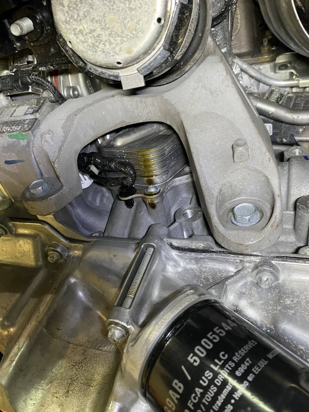

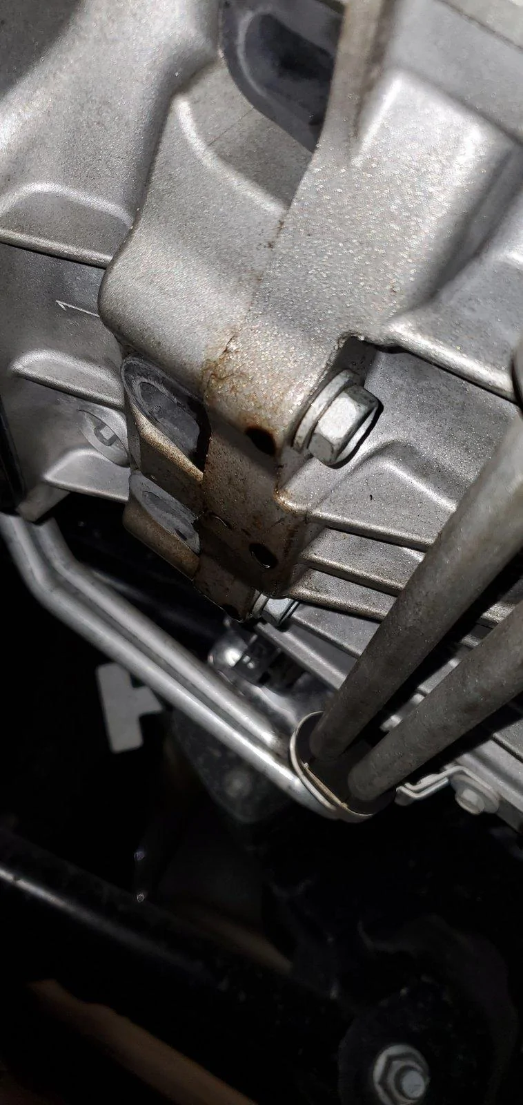

Found oil in garage and my photos look similar to what has been posted. I did notice the filter was a little loose and tighten and cleaned. Will monitor for a few days. There is oil residue from above the filter as well. I am at 33k miles.

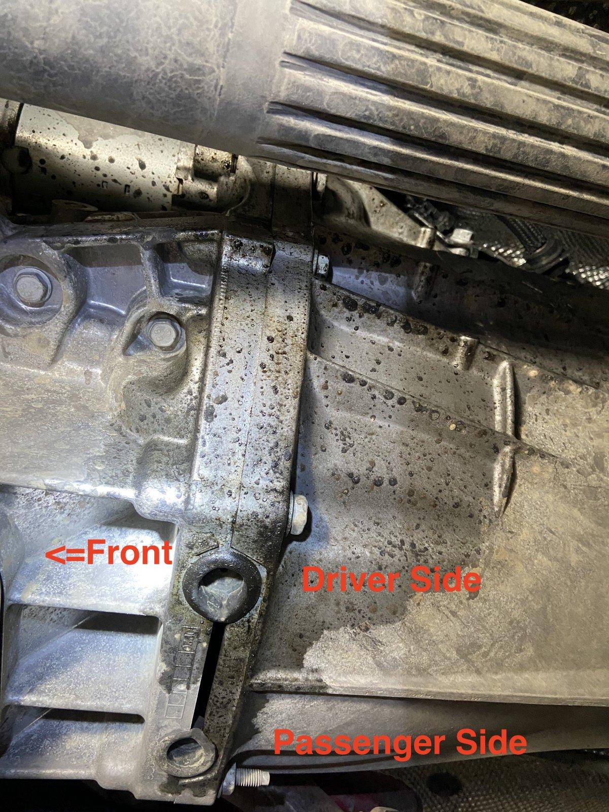

I have a 2019 JLU 2.0 (27k miles) and I noticed spotting on my driveway. I took it to the local mechanic and he recommended to bring it to a dealer for warranty service. The dealer looked and could not find the leak source so they kept it overnight, added dye, and the next day still could not figure it out. I took it home (a couple of weeks ago) and am bringing it in for an oil change and another go at finding the leak. Since this is the second time in for the same issue should I insist they find and fix the problem?
