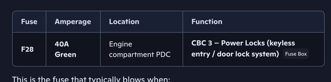

Below is the complete set of modules, antennas, and wiring involved in the keyless entry and lock control system. You can Google or use You tube to see how to test each module. This will tell you where they are on your Jeep and what each module does.. Hope this helps
🚗 1. Body Control Module (BCM) — “Central Brain”
The BCM is the primary controller for:
  • Lock/unlock commands
  • Fob authentication
  • Interior lock switches
  • Door ajar sensors
  • Horn chirp confirmation
  • Lighting flash confirmation
Location:
  • Behind the dash, left side (above driver footwell).
Inputs/Outputs:
  • Receives RF signal from the RF Hub
  • Sends commands to door lock actuators
  • Communicates with door modules over CAN bus
📡 2. RF Hub Module (RFM) — Remote Fob Receiver
This is the module that actually receives the key fob RF signal (315 MHz for NA models).
Functions:
  • Receives lock/unlock commands from the fob
  • Sends authentication data to the BCM
  • Stores key fob IDs
  • Controls the vehicle immobilizer handshake
Location:
  • Under the dash, near the steering column (varies slightly by trim).
📶 3. Passive Entry Antennas (if equipped with Passive Entry)
If your Wrangler has Passive Entry (touch the door handle to unlock), it uses multiple antennas:
Exterior LF Antennas
  • Driver door handle antenna
  • Passenger door handle antenna
  • Rear cargo area antenna
These send a low‑frequency (LF) “wake up” signal to detect the fob near the vehicle.
Interior LF Antennas
  • Center console antenna
  • Rear seat antenna
These confirm the fob is inside the cabin before allowing push‑button start.
🚪 4. Door Modules (Driver & Passenger Door Nodes)
Each front door has its own control module:
Driver Door Node (DDN)
  • Controls driver door lock actuator
  • Reads door handle sensors (if passive entry)
  • Communicates with BCM over CAN
Passenger Door Node (PDN)
  • Same functions for passenger side
These modules are why the JL can detect which door you touch for unlocking.
🔒 5. Door Lock Actuators
Each door has an actuator controlled by the BCM or door node.
  • Driver door actuator
  • Passenger door actuator
  • Rear door actuators (4‑door models)
  • Tailgate actuator
🧠 6. Sentry Key Immobilizer (SKIM) / Keyless Ignition Node (KIN)
If equipped with push‑button start:
  • Reads the fob’s encrypted immobilizer code
  • Communicates with BCM and RF Hub
  • Allows engine start only when fob is authenticated
🔌 7. Supporting Sensors & Switches
  • Door ajar switches (in latch assemblies)
  • Lock/unlock switches (on interior door panels)
  • Handle capacitive sensors (passive entry models)
  • Liftgate ajar switch
