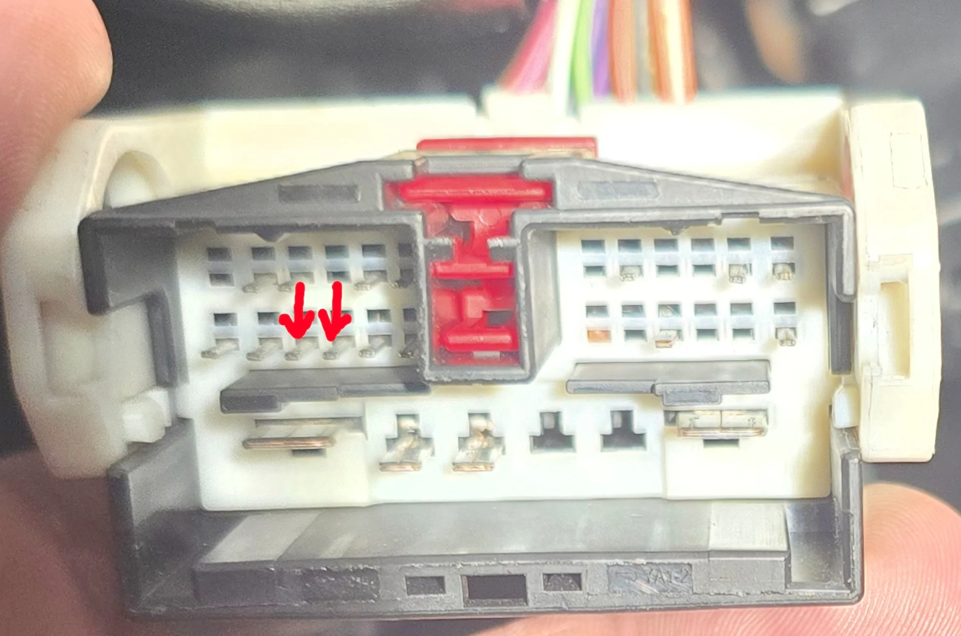

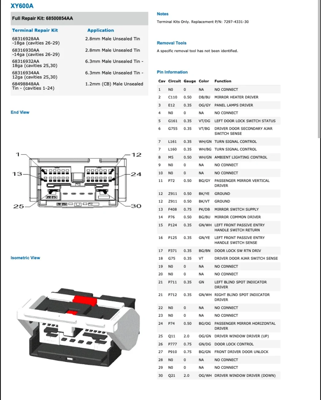

Just pulled the door harness - all pins are intact. I compared against the chart shown and seem to have all the necessary pins.
Am I missing anything? Is there another area to check in the wiring? Could there be a bad sensor in the driver door handle? Thanks in advance!
