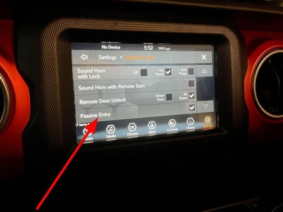

First thing (if you haven't already):
check the Passive Entry setting in uConnect.
Yes, that's all turned on. Still doesn't detect either fob.
