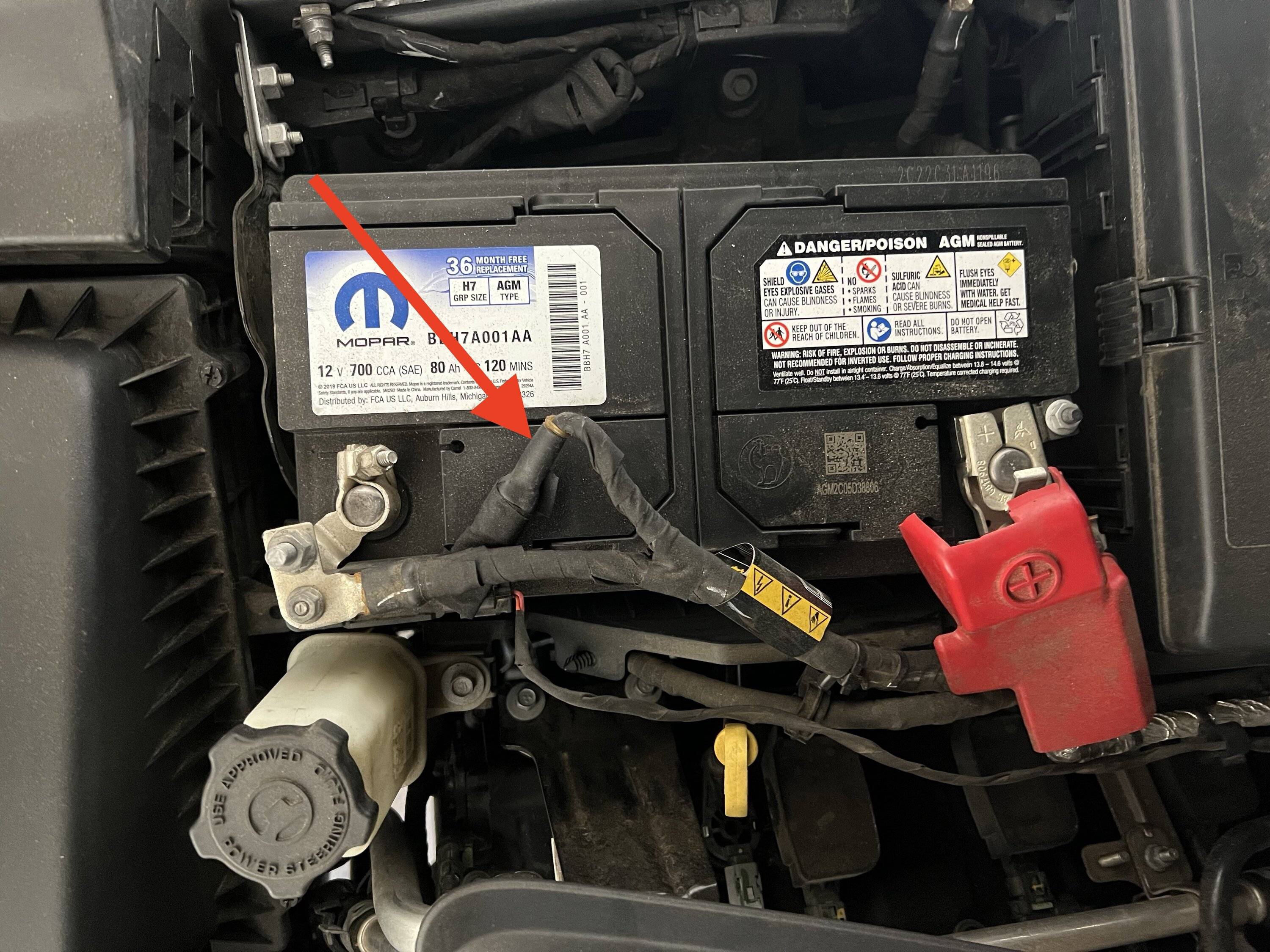

Just to confirm, this is the correct cable to disconnect, right? I disconnected it, taped it off, removed the jumper, and everything seems to be working fine with no error codes.
